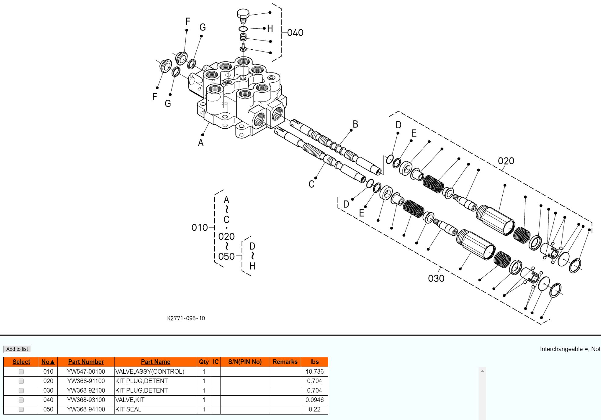

Maybe this would be helpful for discussion too.

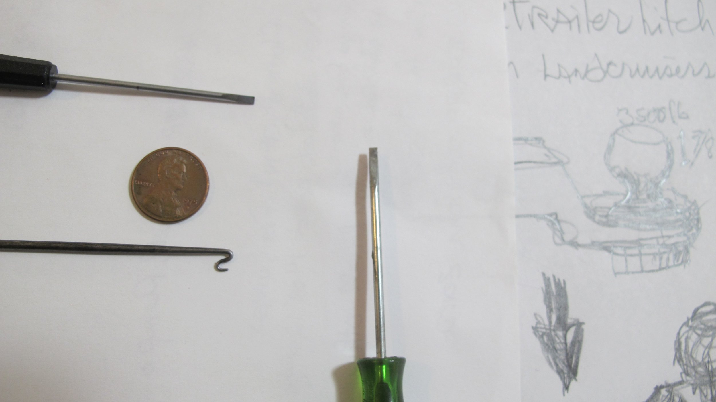

I have gone through all of the diagnostics as have been suggested, I have a print out of the diagram. Problem: instead of retaining ring with rings on the end to use a special plyers to squeeze them together and remove them, I have a wire spring retaining them. I have tried all of the normal culprits to try to remove them and have not been successful. Is there a trick?
   / Kubota BX25 FEL falls under own weight #68
If they are the retaining rings I think they are - called " single turn internal retaining rings" and they fit into a groove. They are easily installed but I don't believe they are designed to be removed. Not sure that there is anything to be gained by removing them from the control valve as there aren't likely to be user-repairable parts inside.
However, if it is just curiosity then that makes sense. Those single turn internal rings can sometimes be removed. I have a very thin small but strong screwdriver of the sort normally used for electronic work, eyeglass frames, or maybe pocket watch repair. And also another tool that is simply a length of small diameter round spring-steel that ends in a small hook. I think both were originally for working on manual typewriters... Both are very high quality steel.
Working at the end of the retaining ring, I can sometimes slide the screwdriver blade or the hook between one end of the retaining spring-ring and it's slot enough to elevate the end out of the slot high enough to hook with the other tool. Delicate work. Once you can lift one end out of the slot all will follow. Do NOT try your pocket knife. It's tempting, but all that will do is break the point off the blade.
