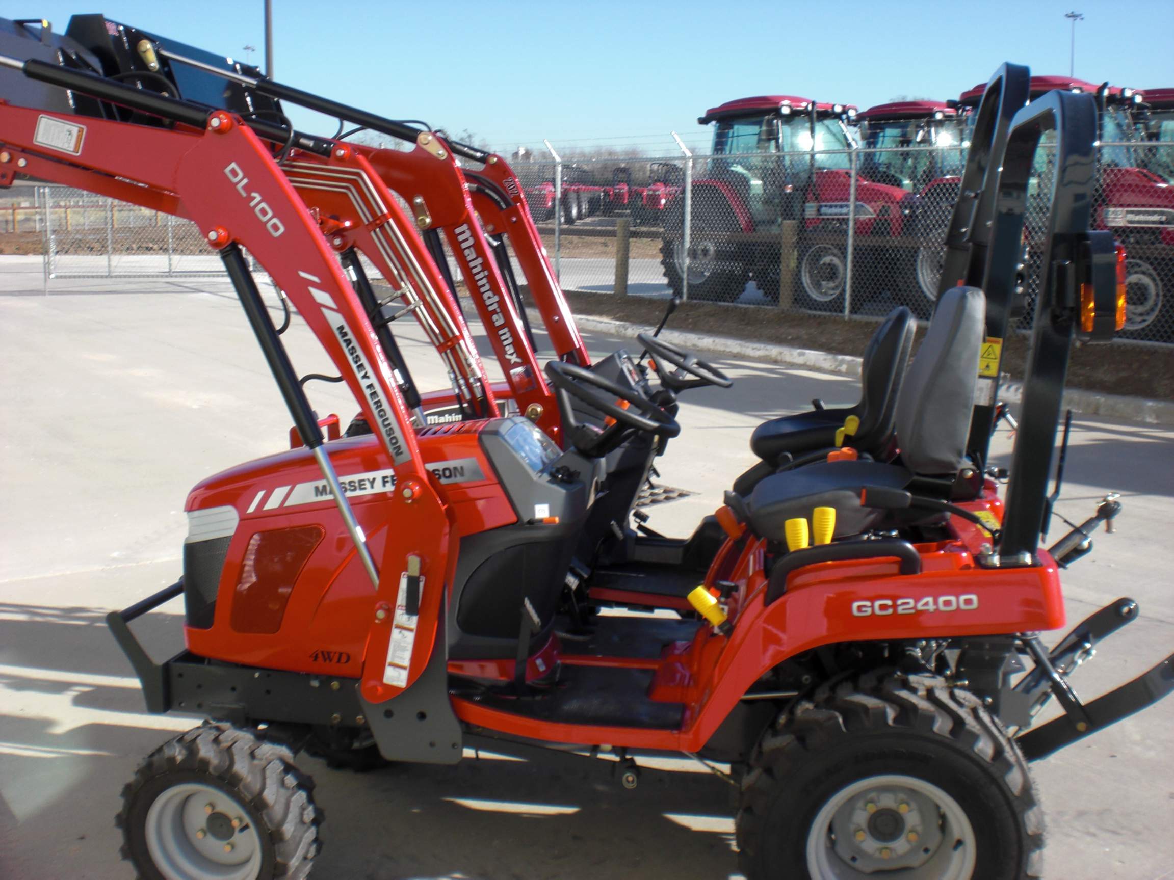

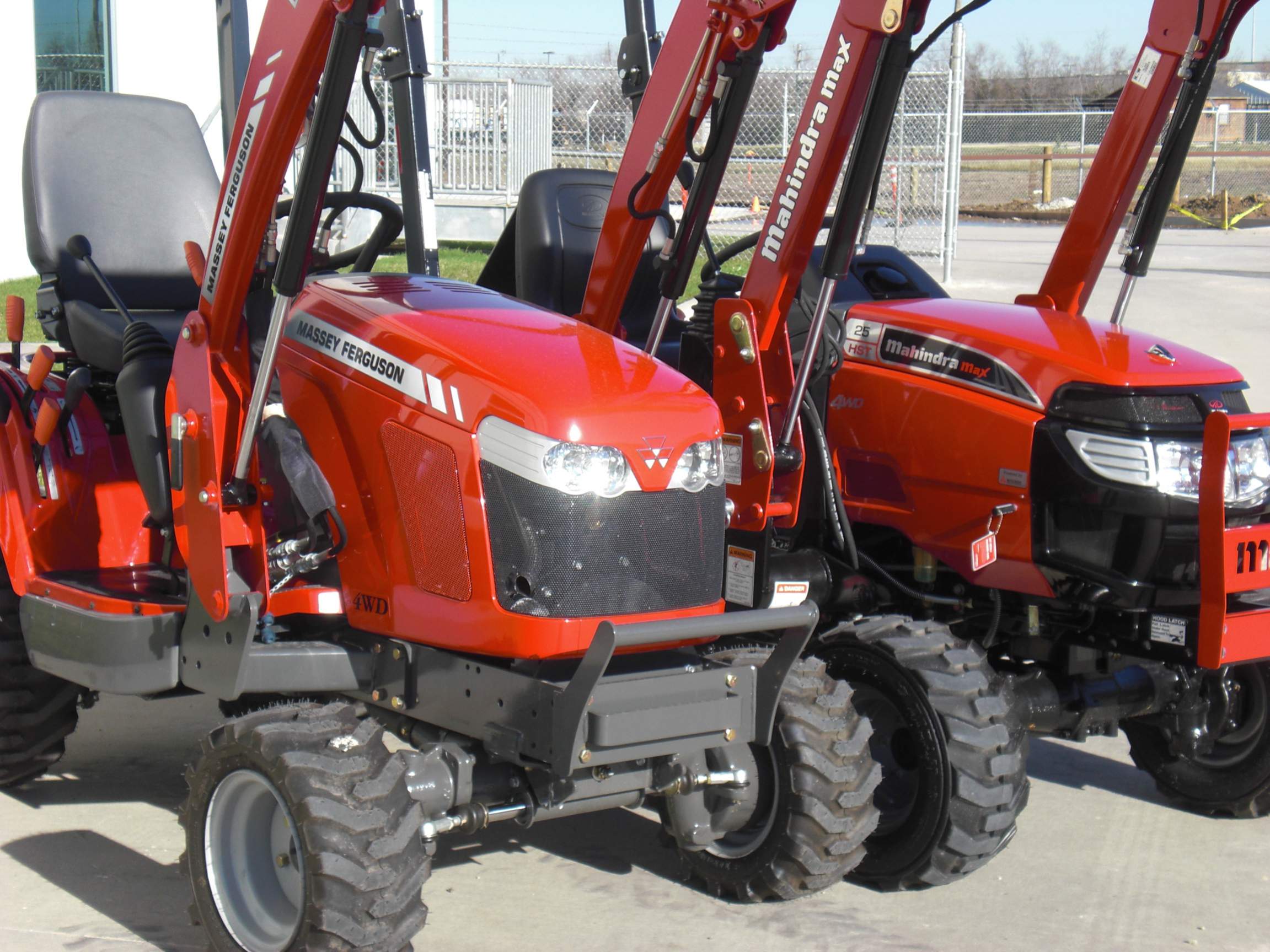

You can see here that the Max is really in the same basic size category as the GC. Just a tiny bit larger. Do note the higher seat but lower ROPS on the GC. Not sure how a 6' tall guy would handle a roll over on a GC. If you draw a line from the top of the ROPS to the front of the hood, the guy's head would be taller than that line. Max has a folding ROPS in case you have a low shed.
Slightly taller tire on the Max. Metal hood vs non-metal. Steering cylinder tucked behind the front axle for the Max. Grill gaurd a little bigger. All minor differences, but I'd say still the same class.
When you put both up on a lift and take pictures of their undersides, that is where the difference really shows and an argument could be made that they are in an entirely different class.
If people are not bored with this subject, I can put these on a lift and snap pictures of the undersides.

Can't imagine anyone would object to some pictures of the Max! Lift it!
