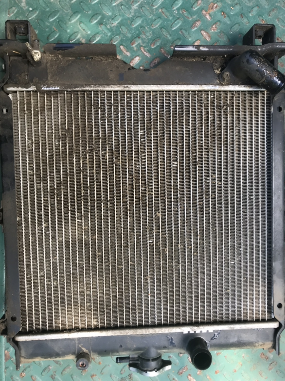

I’ve got a grasshopper ZT with a Kubota diesel in it. It happens fairly slowly but the temp keeps creeping up. The radiator is clean. The air filter is clean, the fan belt is tight, the fan shroud is in place all but a little bit at the bottom which I don’t think has ever been there. There’s no fan clutch, it’s direct mounted. I’ve taken the thermostat out and ran without it and there’s no change. I put the thermostat in a pot of water and heated it on the stove and the pot was very near boiling before it opened. I honestly thought it would fix the problem taking that out but it didn’t. I might repeat that that test with a thermometer since it was supposed to open at 160 degrees. I’ve taken the side panels and hood off to see if better ventilation would help and it does but not a notable amount. And it blows more heat down my back that way. The radiator is as hot as the block when checked with an infrared thermometer. So it seems to me the radiator is taking heat but not loosing it. I’m pretty much at a loss on this one.

I had a similar problem with my Montana diesel tractor and what I finaly discovered was that the cooling fins in the radiator were clogged with built up dust and tiny peaces of grass etc. this was only at the bottom 3-4 inches of the radiator cooling fins so it was hard to see it. Looking at the radiator it appeared clean but uppon very close inspection I spotted the clogging in between the fins, after cleaning that out with some degreaser and water pressure the overheating problem went away. Now I keep a close check on that so it wont happen again.

I took the radiator out and cleaned it. It looks pretty clean but on close inspection there was quite a bit of trash in it. I’ve cleaned it, put a new fan belt on, new thermostat in and I’ve got some chemical radiator flush to go in after I put it back together.
