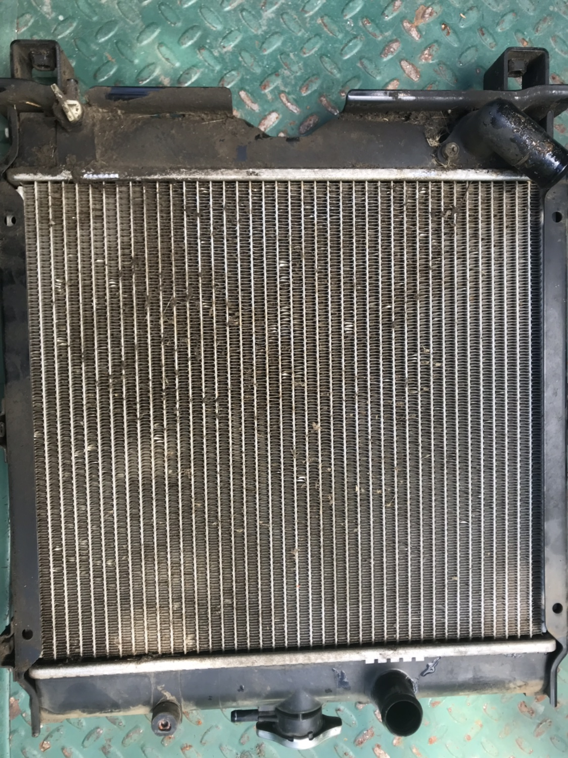

I took the radiator out and cleaned it. It looks pretty clean but on close inspection there was quite a bit of trash in it. I’ve cleaned it, put a new fan belt on, new thermostat in and I’ve got some chemical radiator flush to go in after I put it back together.
Straighten as many fins as you can as well while its out.

Today I removed and cleaned the radiator, which had a surprising amount of dirt in it, installed new thermostat, installed new fan belt, did a chemical flush and put everything back together. And it was running cool until a leak in the lower hose drained the radiator. But I think it’s working properly now.

   / Kubota diesel overheating. #150
It must be dirty, as I can't see thru any of the fins in this picture, lol!!
David from jax
Ahhhh yeah that kind of obstruction will cause a wee bit of overheating lol
My tractor rads get a deep cleaning 1-2 times/year. Hay chaff and dust builds up to the point where any exterior obstruction on the hood causes temps to hit 200 and more.
