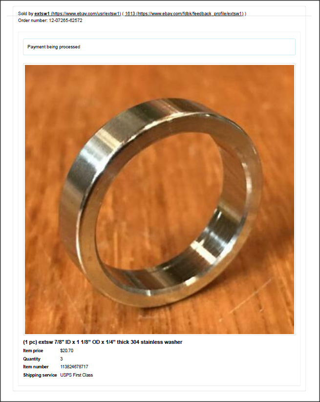

1. I ran high lift blades on the old ZT, and really liked the cut quality. I did not bag any thing, mostly just sweep up what windrowed, if anything. I bought new Kubota blades from Messicks. I did not realize at the time, but the only Kubota blades available are low lift blades. I am able to find high lift blades, but none with the 7/8" diameter shaft hole- all of them are 1-1/8" diameter. Does anyone know of anywhere to source 7/8" shaft diameter blades for this deck?

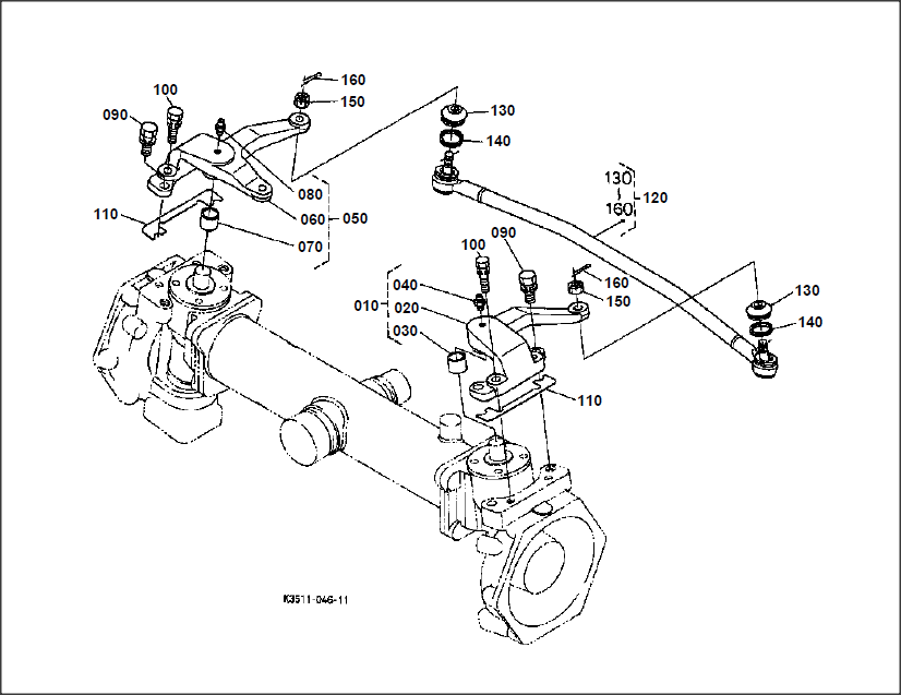

4. I feel like it is kind of tricky to keep my mowing lines straight. The ZT was tricky also, but I was able to keep things pretty straight after a year or two of experience. Is this normal, or this there some steering play I need to look for and correct?

  • I got three SS spacers, in order to be able to use blades with 1-1/8" mounting holes. Been running Gator G6 Mulcher Blades 396-814 for one year with those. You will have many more choices with these spacers in place. I may go back to the OEM 70050-94622 blades next time just for comparison.

  • Check the steering for any slack, including the "king pin" plastic bushings 070 seen below. Once all good, double check the rear wheel toe-in.

Plastic Bushings 070 & 030:
SS Washer:

Concerning the spacers, I was kind of thinking that was going to be my only recourse, but wanted to confirm
that there are no readily available blades with 7/8" shaft holes. I will look into finding some and then get the high lift blades I think I want.

Concerning the steering, I will look for play at the #70 bushings. I do note that the rear tires seem to have a lot of positive camber, in other words, the tops lean out. The outer edges of the tires are worn more than the inner edges. It seems like worn bushings would lean the wheels the other way?

If you leave the engine idling and stand on the right hand side of rear axle while looking at the 060 (arm knuckle) & tie-rod ends while turning the steering wheel slightly back and forth, you will see it there is excess slack in the plastic bushings etc.
It should all be pretty tight.
If doing this alone, the operator seat safety switch may have to be jumpered temporarily.

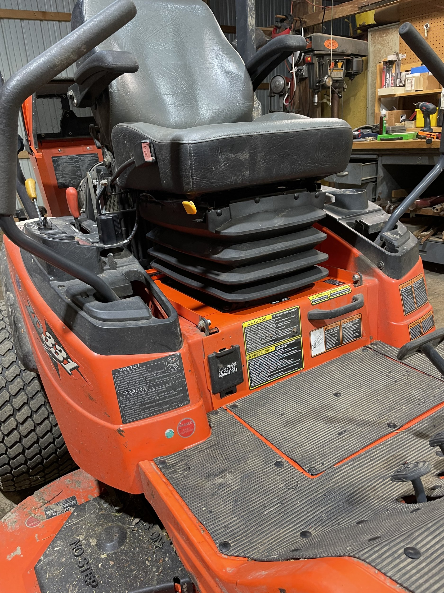

Since I have both a ZD331 and a F3680, I actually think the ZD331 rides a little better. Both are rough on the posterior, but neither of mine have what I would call a really comfortable seat. The little rear tires on the F really magnify the bumps in lawns.
It’s the price you pay for traction.
The front mowing deck tires on the F don’t really transfer much “shock” to the operator since the front deck rolls in front of the machine more independently than the hanging mower deck on the ZD331 zero turn.

I will be sure to check that this week when I have the mower out again. Thanks for the tip.

I added a Grammer self contained air suspension seat to the ZD331 and cast iron weights in the rear and that gives a fairly comfortable ride and added traction
