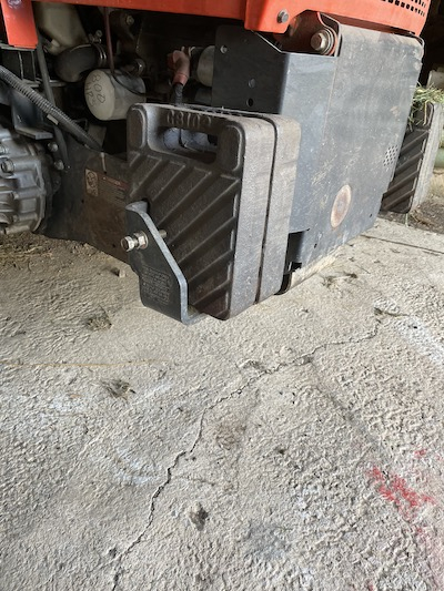

IMG_0193 3.46.34 PM.jpegPic of the weights

I wished kubota made weights for the front of the ZD1511 :mad:

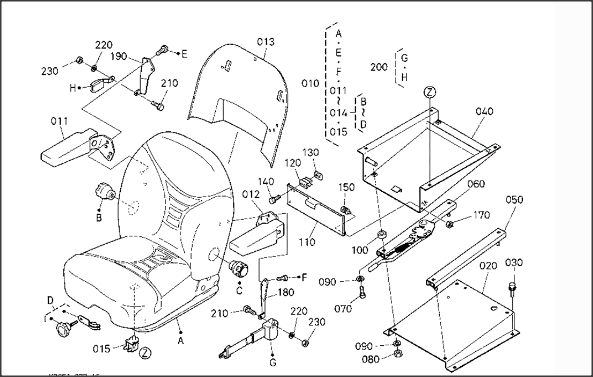

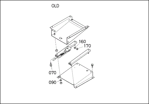

As far as I know Kubota F3680's have no suspension at all in their seat base, but the seat itself may have springs etc.
Perhaps F3680 owners can clarify?
Here is an example of one F3680 seat base:
Here is a complete seat of another F3680 year:

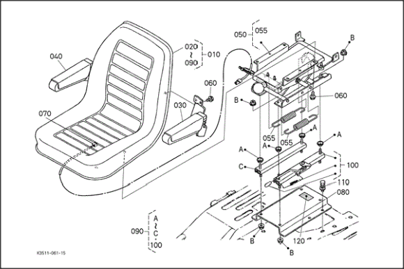

Here is a seat of F3060:
The F3060 rides perfectly OK in our yard rough areas, but certainly there are better suspension seats for those willing to spend the money.
So different Kubota F models may have totally different seats.
I.E. buyer be aware and pay attention to this detail if mowing a rough yard.

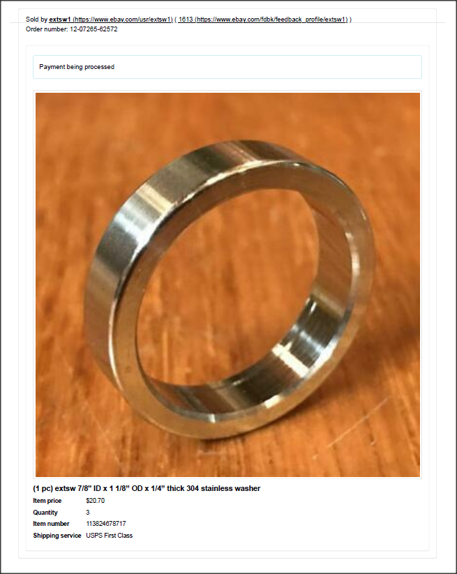

  • I got three SS spacers, in order to be able to use blades with 1-1/8" mounting holes. Been running Gator G6 Mulcher Blades 396-814 for one year with those. You will have many more choices with these spacers in place. I may go back to the OEM 70050-94622 blades next time just for comparison.

SS Washer:
