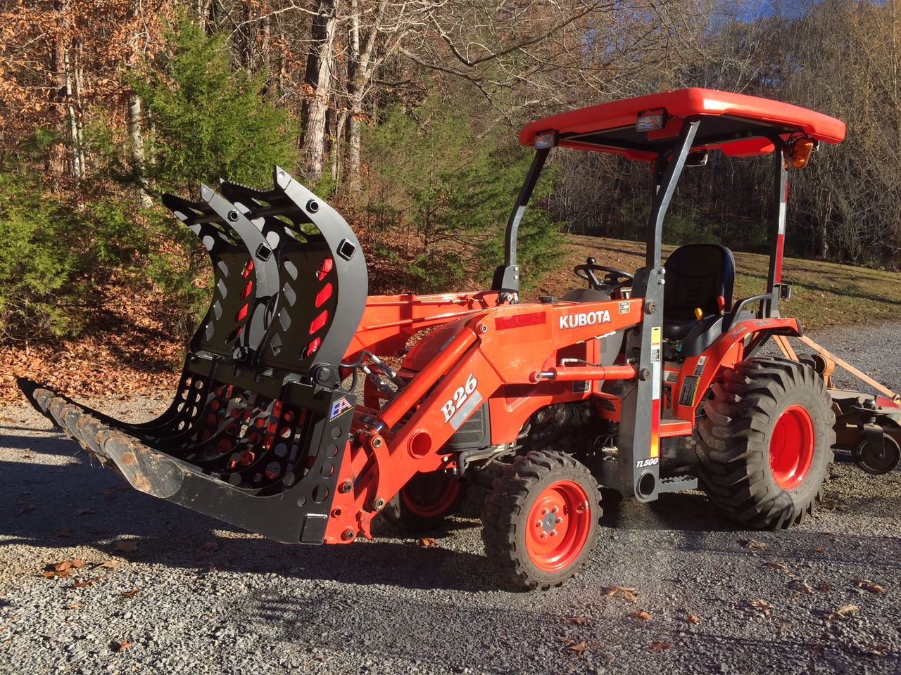

B26 handy as a pocket on a shirt.
   / Kubota FEL - B series vs BX series #36
OHHHHH NOOOOOOOOO.... IT`S JAWWWWWWWWWW`S :laughing:
Heyyyyy... do you leave that unattended anywhere...??? Thats a REALLY nice tractor, i`d like to hide that in my garage for the next 20yrs... lol lol lol
