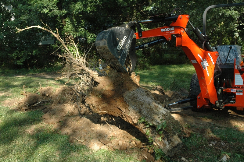

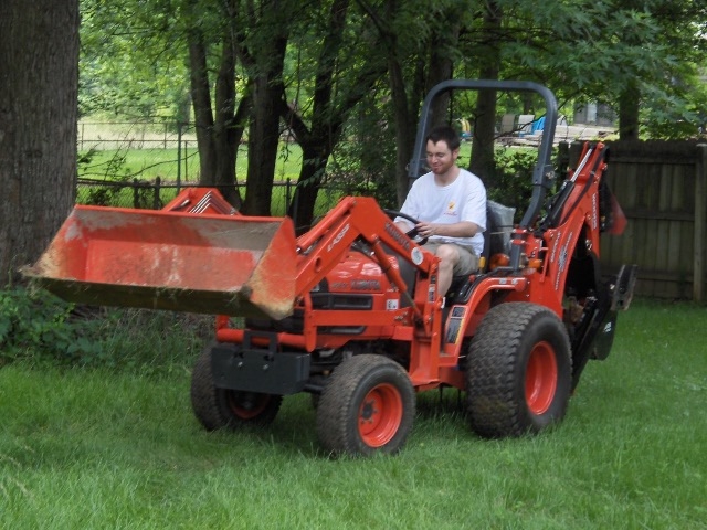

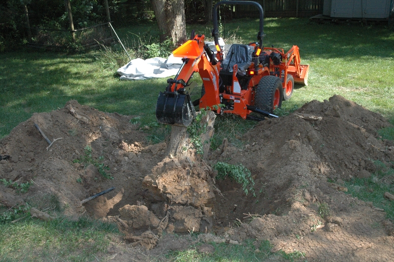

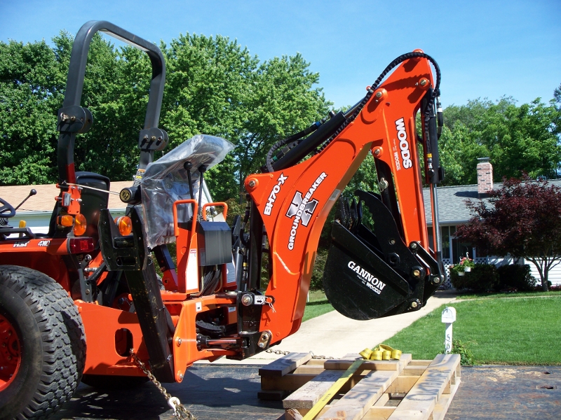

Although power wise they are about the same the BX's seemed tiny. I was originally focused on a BX24/Kioti CK20 (no Kioti dealers around though). When I finally saw the BX24 I was amazed at it's size. It would of fit in my MaxiVan, which would have solved the problem of getting a trailer. I did note though that the ground clearance was way to low.
As other's have wrote - the BX's seem designed as lawn mowers with extras.
Since I never fired the BX's up I don't know what an engine at 3200 rpm sounds like (rated rpm for max HP) and I still don't know what my 7610 sounds like at 2600 RPM (rated rpm for 24HP) but I do know that at about 2000 rpm my 7610 has plenty of power to pull a stump and carry a truck load of sand.
If you've got to worry abour FEL work get a B. If you are also concerned about stumps get either a TLB or a B w/ a BH
