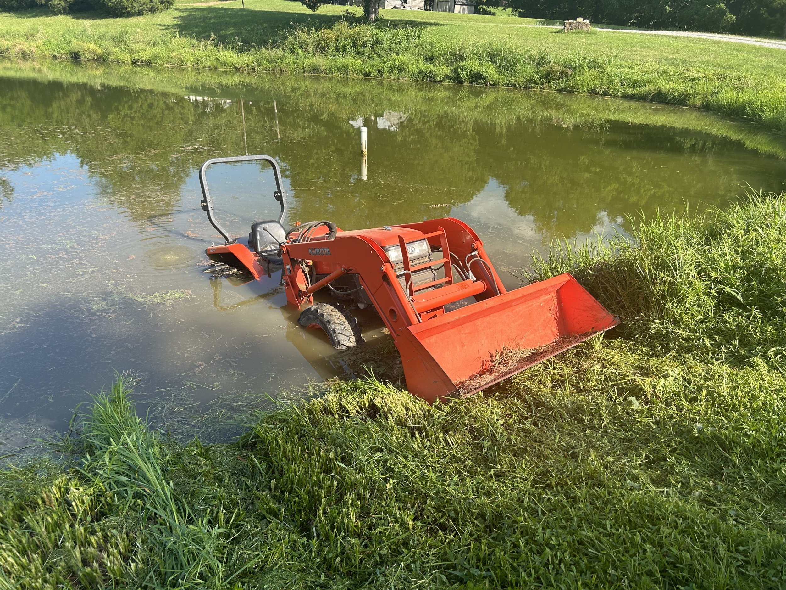

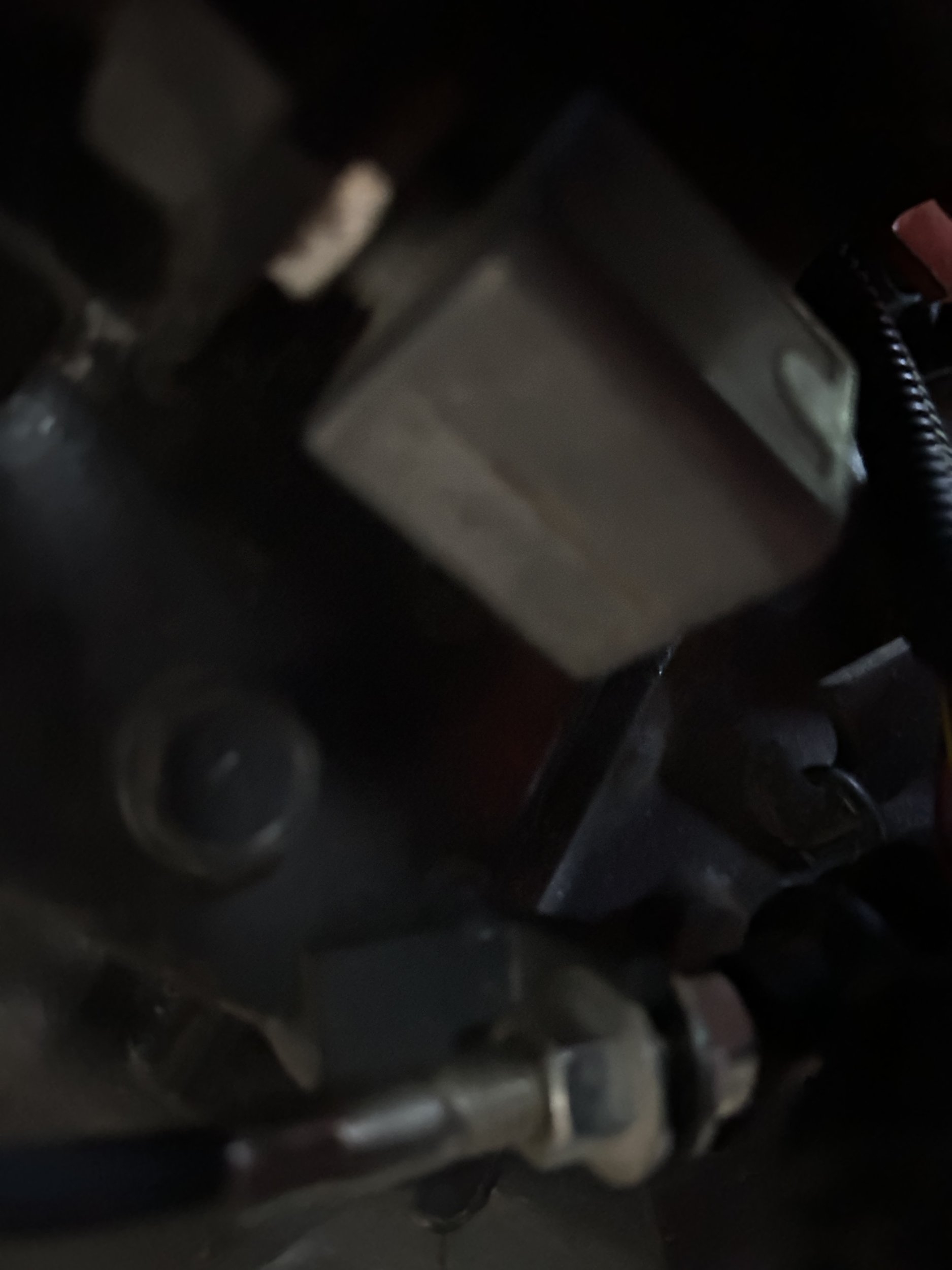

Subject: Electrical issue
Kubota L4400 will not start. I have never had a problem with the HST treadle.
I have replaced the switch part #TD060-53902 switch/neutral and the 6-year-old battery, but still nothing when I try to start. Fuses appear all good. I suspect an electrical issue. I have not yet checked the starter or solenoid. A month ago I had a bath,(see image) but there was not an issue before now.
   / Kubota L3400 seat cutoff switch #24
My neighbors Jim and Bucky came and we eliminated the treadle switch, pto switch, and seat switch but still nothing when turning the key but the panel light for the battery, glow light and oil light. So Bucky was drawn to the starter and solenoid since only a clicking sound was also heard when turning the key. He jumped the starter and got someting in addition to clicking. It was the starter which was not replaced but only kicked a couple of times. The cost was $80 for the switch part that I had broken troubleshooting 3 days ago.
