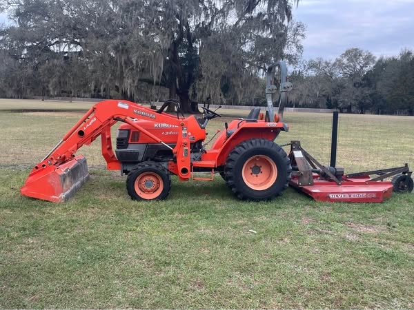

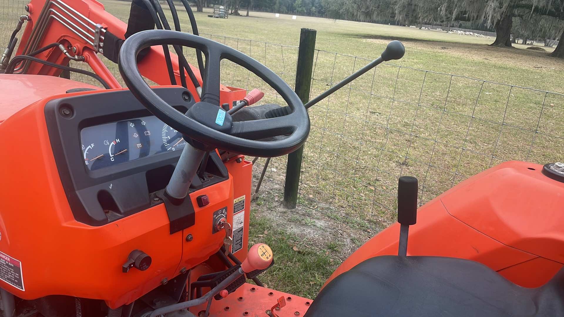

This L3400DT beauty is a 2009 with blade and bush hog,
DT with stick in the middle.
Any trouble with these? ONLY 258hrs!!!
Says 3 range but shows hi/low?
Are these better then Hydro?
Asking 16k

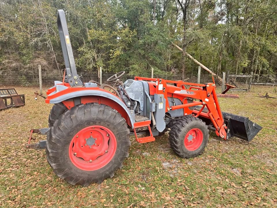

I also found a 2006 Kioti DK 45s with 1300hrs rear remote for same price with more attachments but shuttle arm is loose, drove great but can't decide on brand.
Thoughts. Would like to add 3rd function at some point to either.
Kioti I can run lines from rear remote for grapple if needed.

Kubota is in great shape and seems fairly priced. If you are doing lots of loader work the shifting vs HST is the only downside.
But it you are doing mowing, and general use it would be fine. On the DK45 you are getting more HP and more tractor, but at 1300 hours, and looks like it's lived outside most of its life.
Just depends if you need the HP, if not I would lean towards the Kubota for the hours and condition.

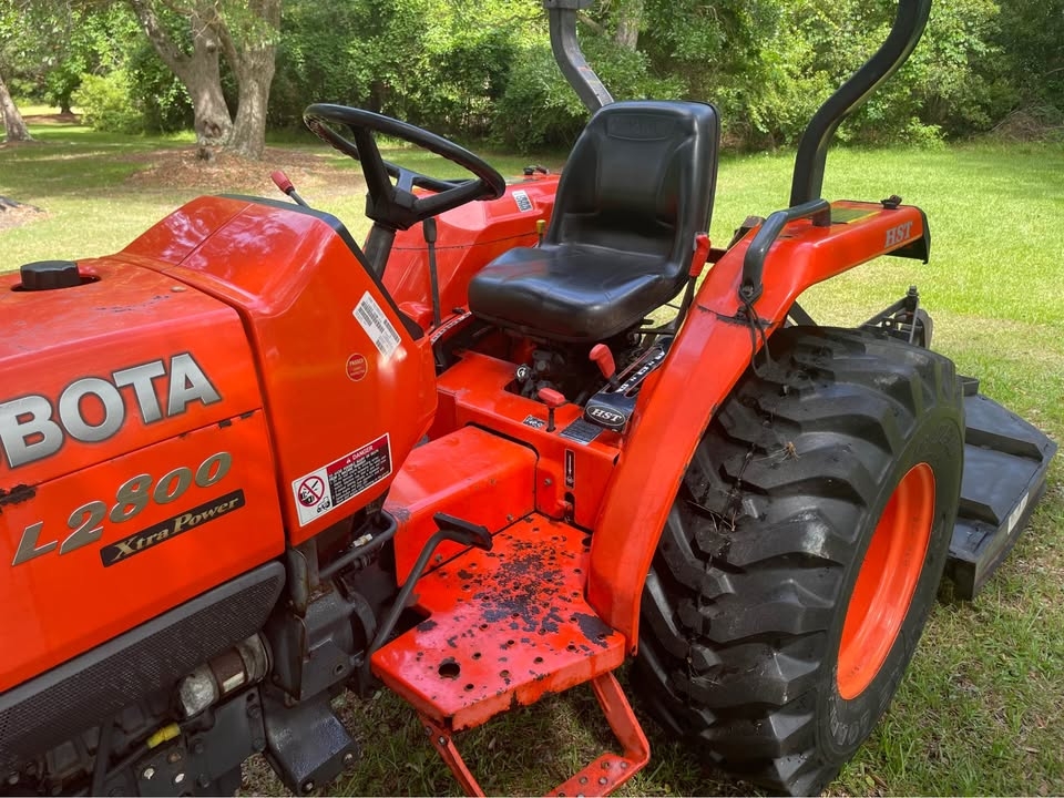

How well do you trust the seller of the Kubota? Find out what serial number the tractor has... Got any more (or better) photos? At best, this is a 2007 model and it has been out in the sun it's whole life...
I would also guess the hours are not truthful based on tire and paint wear... but that's just a guess.
Under the model number, L3400 there should be an "XtraPower" sticker (?). In 2008 the new engine was larger and had this distinction. 2009 definitely should have it.
You can see this in this photo:

It’s a shame the Kioti never had inside storage, I would be concerned about weather rot on tires and hoses, and decreased resale value. As with most of us, you will most likely decide to eventually upgrade for more power and desired options

Looking at the first photo again, the instrument panel and the orange cover looks way too clean and not faded. Those parts (along with a new hour meter) might be from a 2009 model. The rest of the tractor, especially the rims... are faded like it's much older, with more hours.
Serial number will be what you need, it's on the frame, left side. If that is not there - it could be stolen. All the keys are exactly the same... for L models.
If you are buying this used, there are so many scams about sending money and they "ship" the tractor to you.... don't fall for it. You need to test out the clutch, if it needs replacing, you are looking at $3,000 (?) for a dealer to do it.
Also, brand new, this tractor might have cost $15k since it's manual.

So ask the seller to send you specific photos (if they don't have the tractor, they can't send you those photos). I would ask a photo of the sight glass on the left side of the transmission. It should not be "milky" in color.
Also have them send a photo of both front axle case. One looks like the paint is gone from the bolts... might have had an issue with axle seals. Which, if truly below 300 hour, should never have happened.
And of course a photo of the serial number plate!!!

These appear to be FL tractors given the landscape and trees etc. The Kubota wheels are faded yes, but that could be because the main tractor was covered except for the wheels, 3PTH area.
Getting a look and driving it would be key to the decision.
