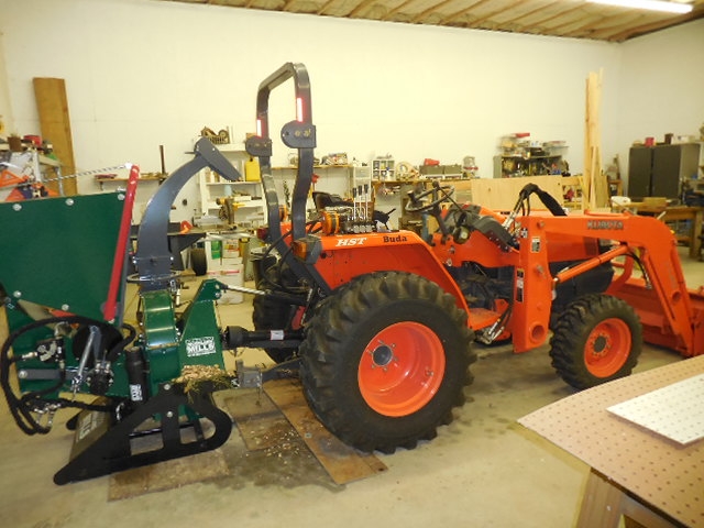

I also have a 2009 Kubota L3400, but mine's an HST. I wouldn't consider anything now without the HST. But then, that's a personal preference; YMMV. Here's a pix of mine after a day's work running my chipper:
I now has 230 hours :) It's treated as a tool, not as a toy. And no , it won't be for sale for $16K. It's an inside baby and cared for it pretty much as one. It has served me well, especially when I need it most.
I see all kinds of “tractor trades” in my line of work and it is amazing how much better sheltered tractors are. I mean put a coat of wax on those and they look new.
The added benefits are of course mechanically speaking and they are numerous.
Wouldn’t touch an outside kept machine nor take any of these in trade.
Does urs read "XTRA Power"
