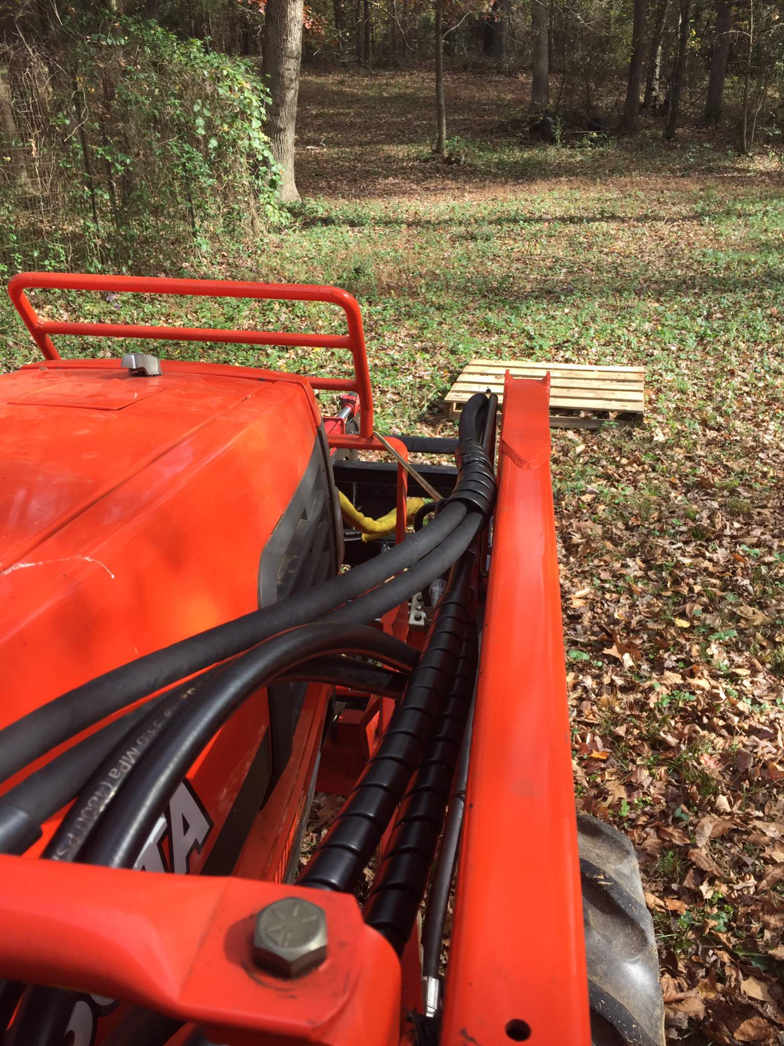

"...3. Had new hoses made for hooking up the diverter and new hoses to run to a new grapple
4. Plumbing was checked and rechecked...." When you get some light on the subject, can you take photos of the plumbing? What goes where?

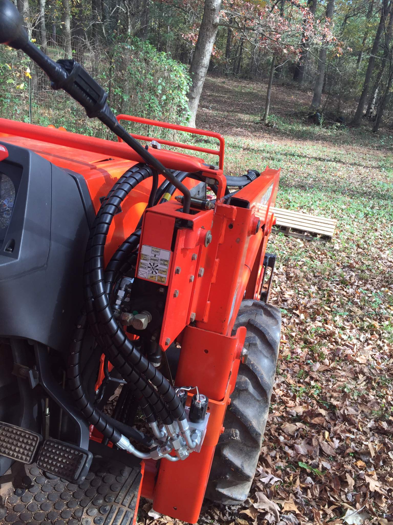

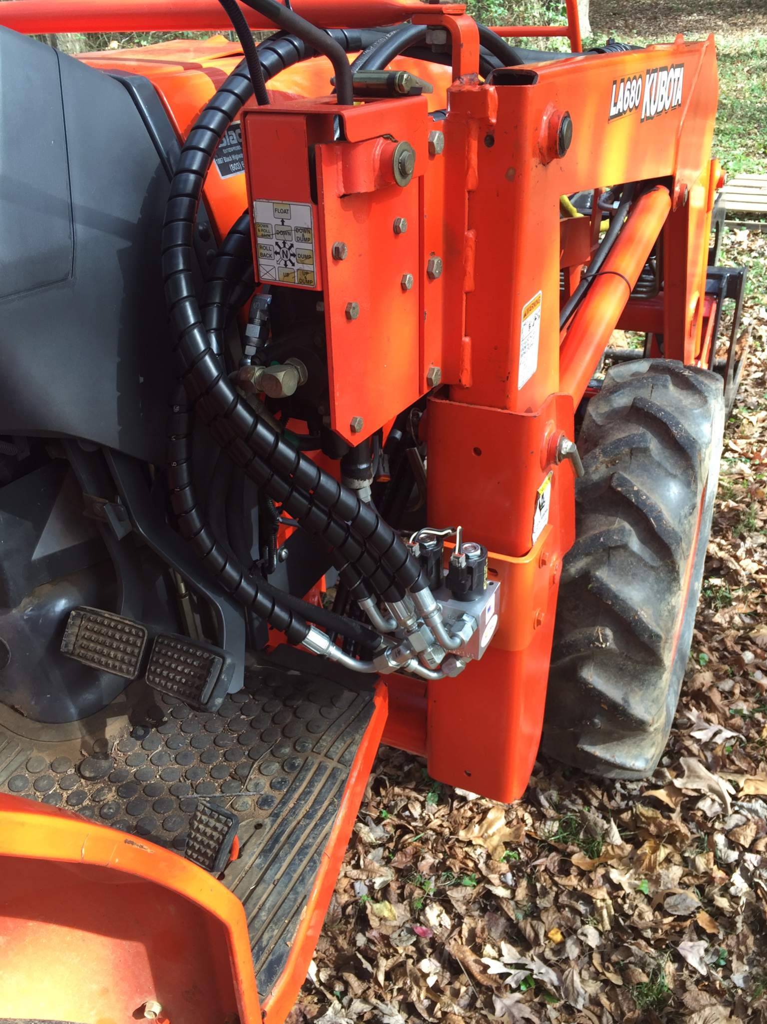

I took these pics on Sunday before I started working with it. Not sure if these pics will help you but I hope so.
When plumbing for the grapple I followed the instructions that came with the diverter. I came off of the valve where it controlled the bucket and from there ran new hoses to the diverter. From the non energized ports(to the grapple) on the diverter I ran new hoses to the front of the loader with QDs to the grapple. It was pretty simple but routing the hoses was a challenge.

Shouldn't the 12v valves be open on one and closed on the other? You have the 2 hoses with the largest loop in picture 1, one hoses going to one valve and the other going to the other, Is that Right, that would also make the other 2 wrong. If the boom is working everthing before it is good, it has to be from loader valve on. It just doesn't look plumbed to me.

Yeah, hard to see the routing on the hoses, but it looks like to me that you have outlets B1 and B2 paired up, and it should be A1-B1 and A2-B2 as the pairs. But it's hard to see for sure.

I blew the picture up, and here what I saw, looks correct to me:
Yep, I think you are correct - didn't notice the red ducking under the green...
