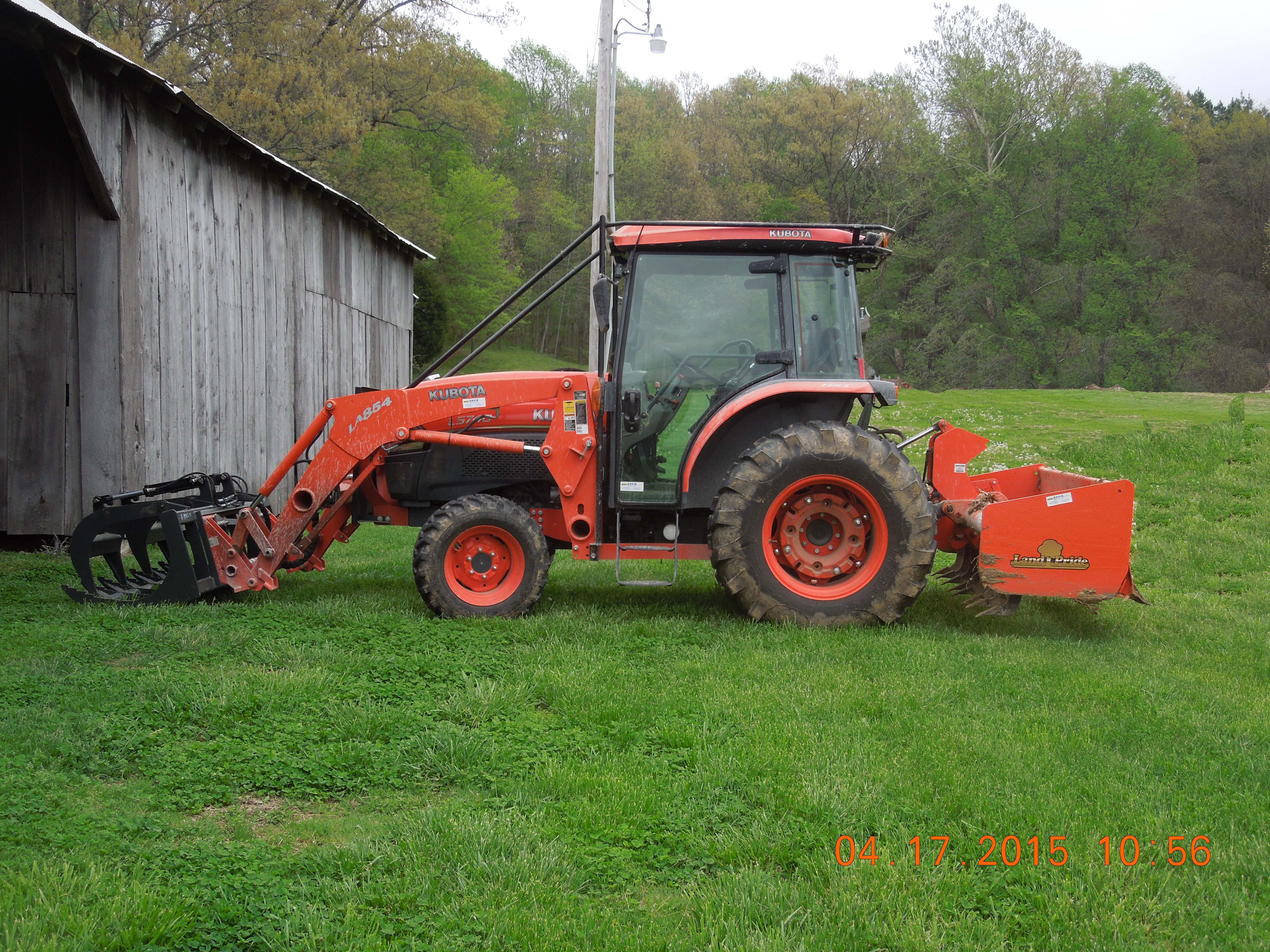

Interesting thread with great advice, nothing significant with which to disagree. I would however, spend a few more dollars ans get the MX5200, not a power thing just some hand add-ons. I own something that would work well, an L5740HSTC, three rear remotes with TnT ,third function valve, loaded tires with wheel weights and limb guards. Down side is the cost and in use it wont do any better than an MX4800 or MX5200.

I like to take a lot of pictures from the time the first machine shows up until it's done. It helps later to locate wires, pipes etc. and you learn a few things.
