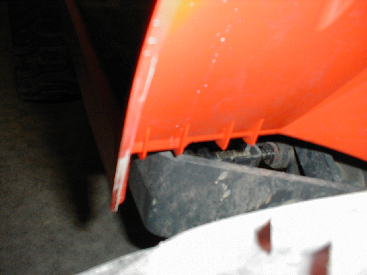

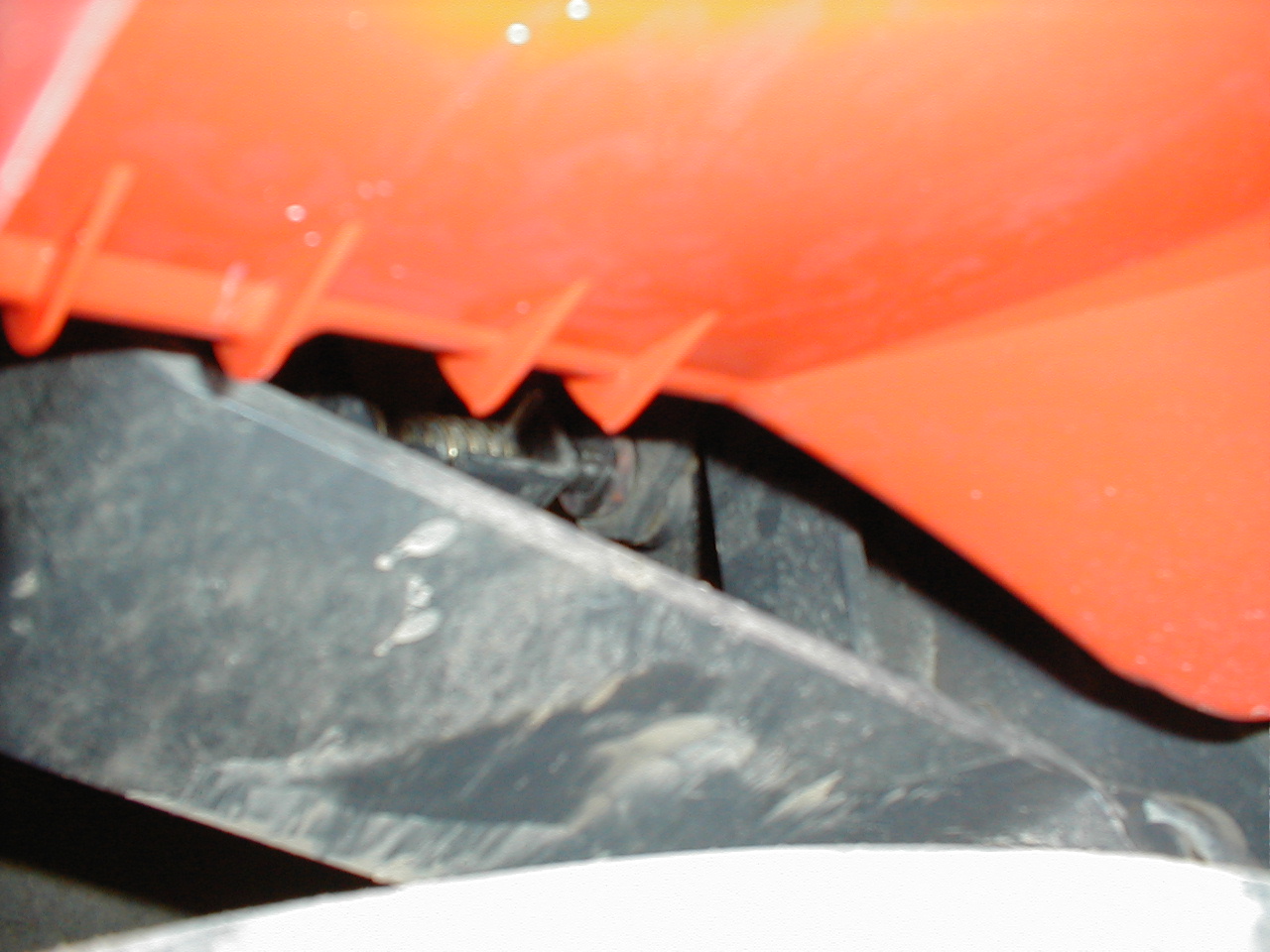

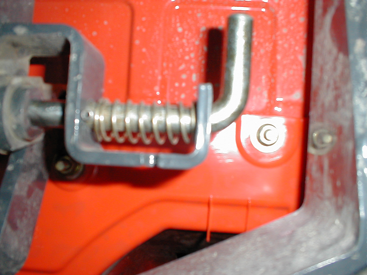

Here are a few pictures of the reinforcement ribs.

With my newly replaced fender, new design, there was no new or added brackets that I could tell to support the fender.
