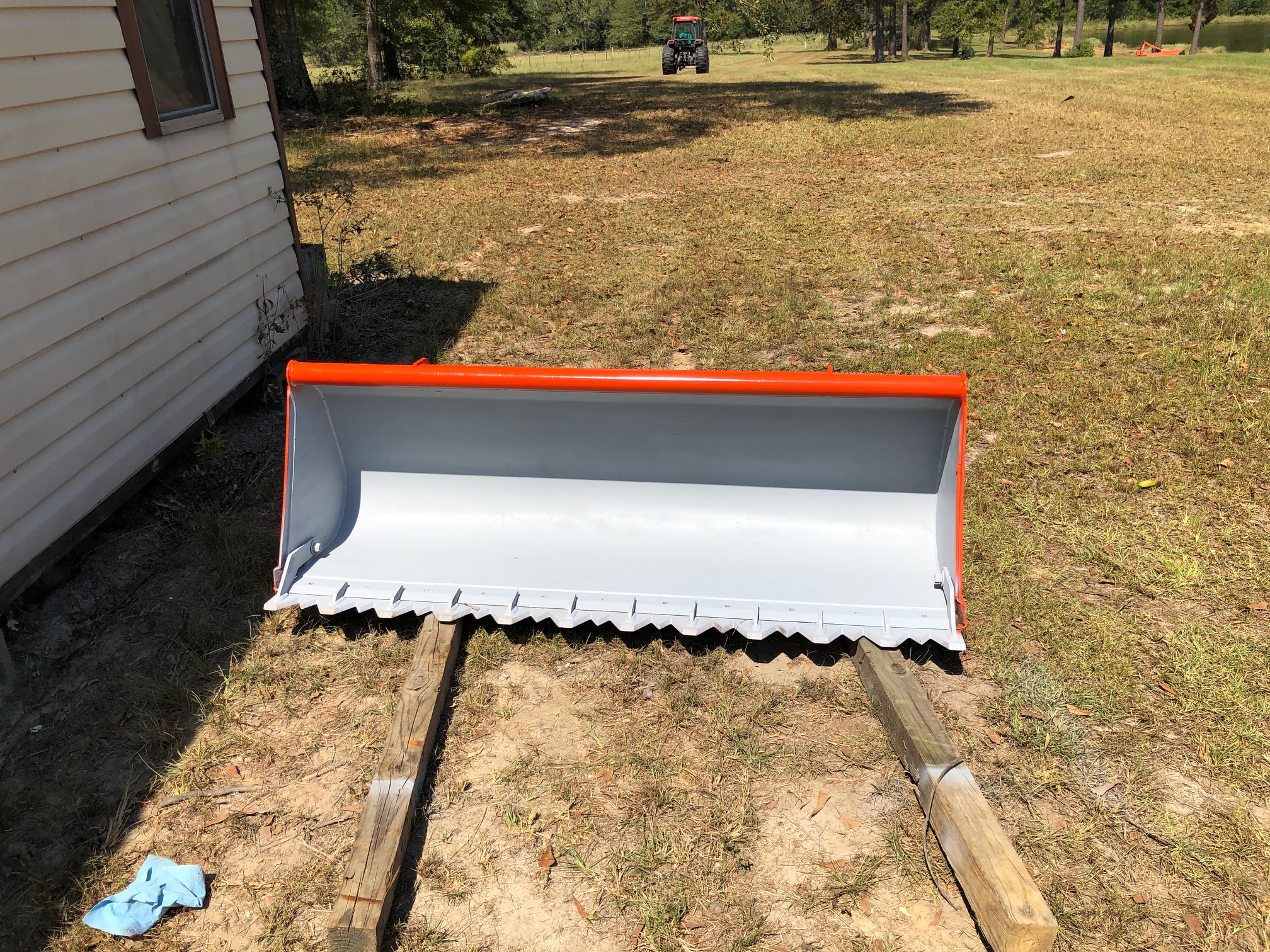

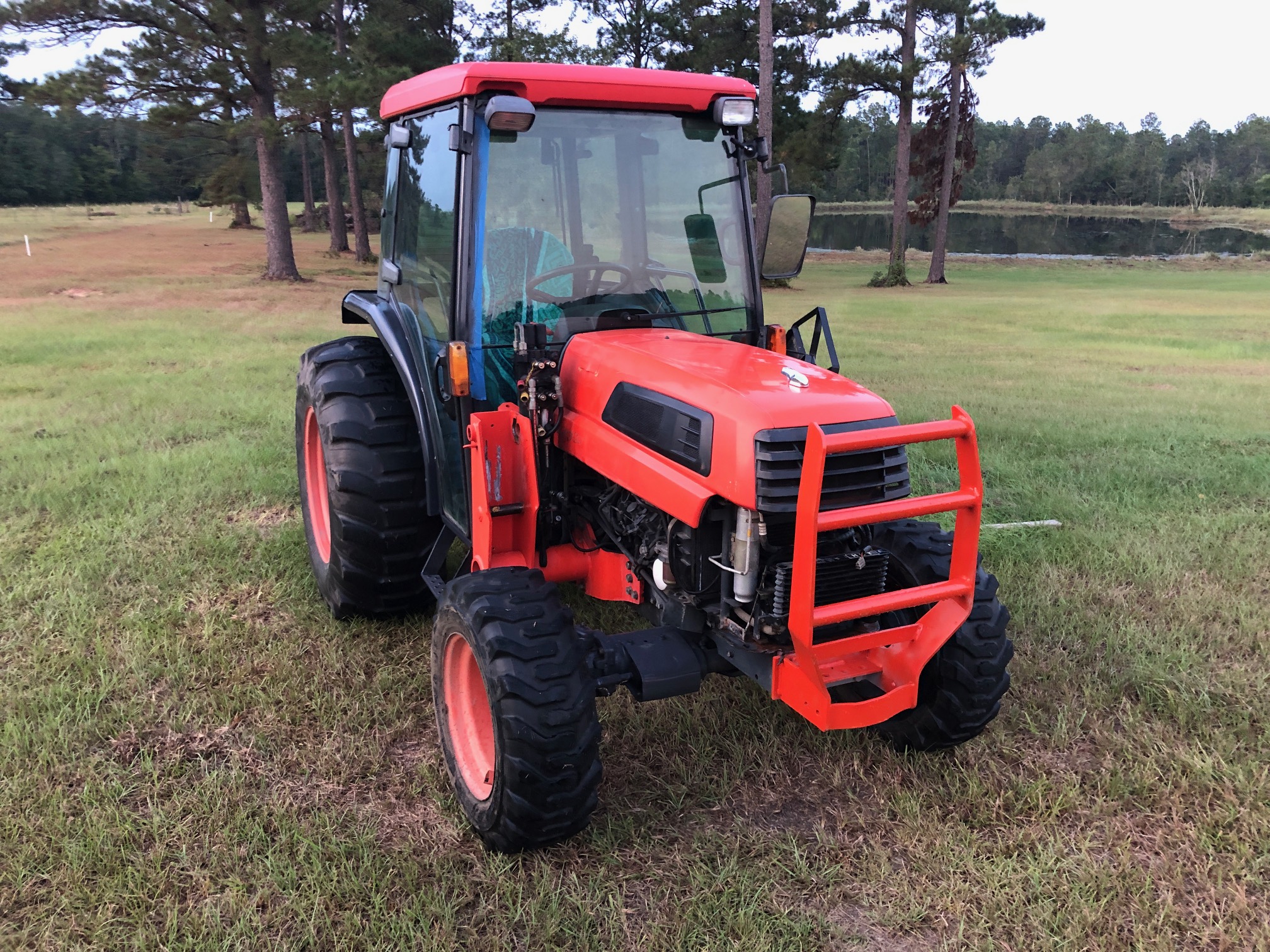

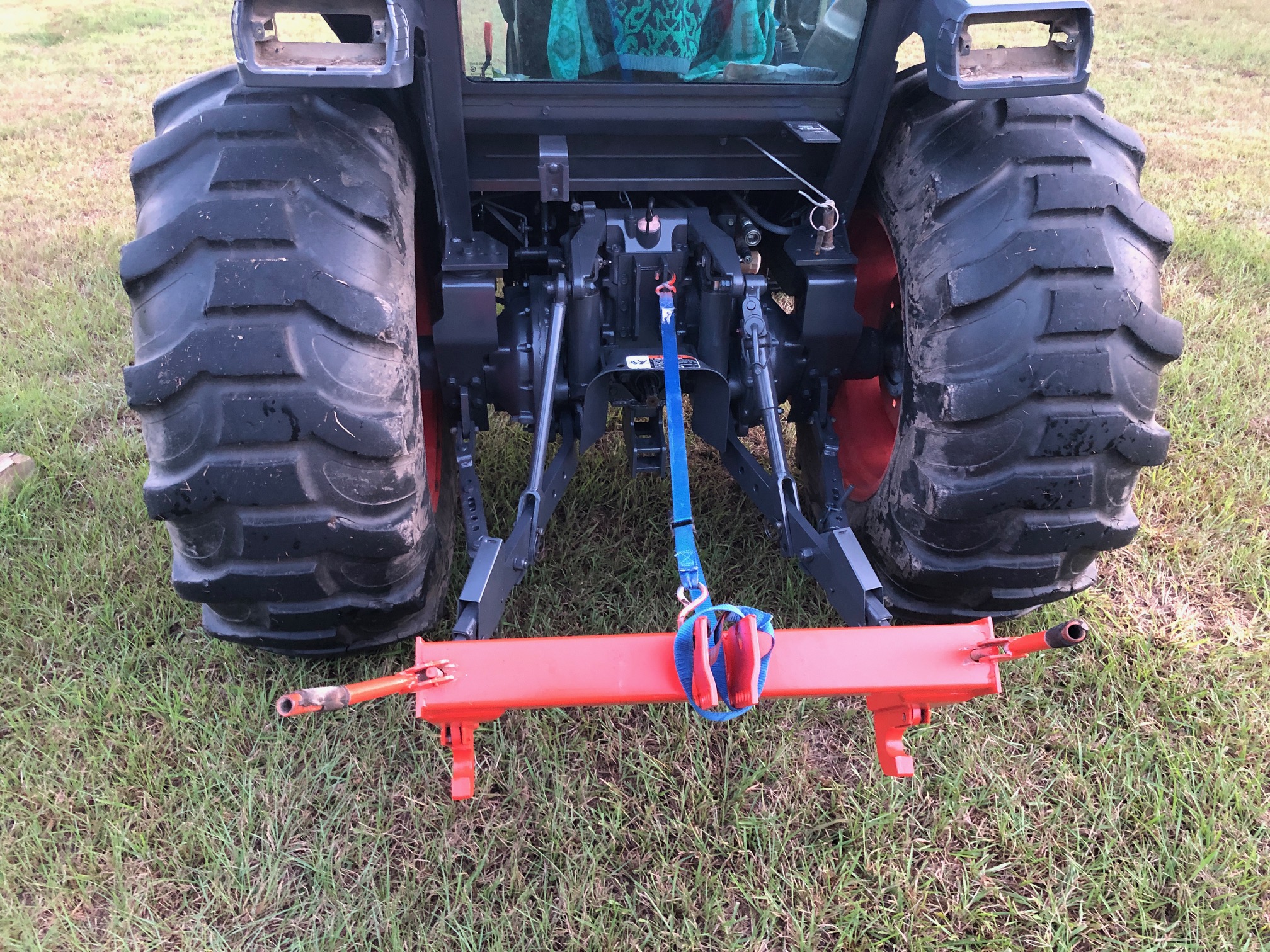

Here are a few photos of the tractor and an update -
First, after all the complaining I did, I am actually a big fan of the Kubota paint and primer. Turns out the cost isn't as bad as I made it out to be as the quality is really good. For the bucket I think that Rustoleum covers very well and is a better deal but for the rest of the tractor the Kubota primer works great.
The 3pt area was degreased, washed, sanded where accesible, any rust was treated, washed again, wiped down with thinner and painted. It came out better than expected.
Fenders, door handle, cab frame, brush guard and steps were prepped and painted the same way. Excellent results.
Was going to do the hood in the same manner but have since decided to take it to a buddy's shop and have it sprayed in a booth. I feel confident I could get a good coat and even shine with rattle cans but don't know if it will be as durable.

Looks good. I'm doing same deal with the hood on the M9, having it done in a body shop. The hood is probably twice as big as yours and had a couple 'whoops' dents from the previous owner and every time I look at them, it irritates me.
Wheels are easy. I run masking tape (the blue stuff) 2" wide arounf the edge carefully and make a cardboard cover for the wheel nuts and mask the valve stem and go to town with a rattle can...

Thats a 5030 HSTC isn't it? I had one a long time ago (where my screen name came from, 5030). I see you are minus one mirror. Nice tractir, just not large enough for what I do. I require at least 75 PTO horsepower.
   / Kubota Paint and Primer
#48
It's a L4330. Purchased it used with one mirror but it has been a very nice tractor. Going to clean up real good too.
