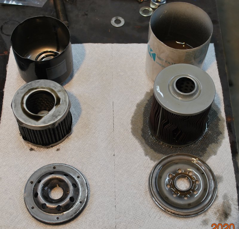

I was recently playing with a filter cutter I made ... cut open a used New Holland engine oil filter, and a Kubota Hydro filter that were waiting to be recycled.
I was surprised to find that the Kubota filter was not what I would call a high quality piece of work. Cheesy spring plate bypass spring, no exterior screen on the filter media .. which appeared to be paper one step above a Walmart fram filter. The NH engine oil filter was very robust, real spring for the bypass, screens on inside and outside of the filter media, mounting plate twice as thick as the Kubota part, nice thick crimped on end caps filter cage. Kubota part was not the worst filter I've ever seen, but far from being a quality industrial part. This particular unit had the filter media collapsed ... most likely from me not giving it enough warm up time in sub-zero temps.

Kubota and every other equipment manufacturer has a vested interest in providing filters and fluids of a quality that helps optimize and lengthen the performance of their branded equipment so that equipment gains public favor and widespread approval. Quality is more important than price point.
Aftermarket filter and fluid retailers have a vested interest in market share for their products, the big picture for them is the fluids and filters themselves, not the equipment those fluids and filters protect. The benchmark of aftermarket filters is the price point and not failing or causing an acute equipment failure while they are in use.
I absolutely agree with this and have done price comparisons and cut filters apart for decades. OEM, especially the Kubota and Deere I'm familiar with, were much better made and in most crease cheaper than the alternatives. The exceptions would be odd duck, limited proprietary use filters where there was no competition for the OEM company.
Now, for a truck filter a lot of the aftermarket oil filters would likely be OK and the higher end ones I cut apart over the years were respectable. Fleetguard comes to mind as honorable but there were others. Even so, I use Toyota oil filters in my Tundra and they are the least expensive. I use Purolater air filters if I can get them and OEM if I can't. Cabin filters are also Puro.
Equipment makers likely sell more oil filters than anything else and know everyone knows the price and will switch in a moment. So, they price them right, keep equipment in good shape and let the doubters know or think other parts are as fairly priced. It's another story but OEM paints are usually top shelf and bargain priced as well, especially for the quality they are.
So....is it logical to assume that a similar comparison might also be made between Super UDT2, and non Kubota hydraulic oils, with the same or similar spec.?
I have long suspected that suggesting/requiring Kubota Super UDT2, and particularly for an out of warranty Kubota, may just be Kubota and dealer price gouging/brain washing/fear mongering.
