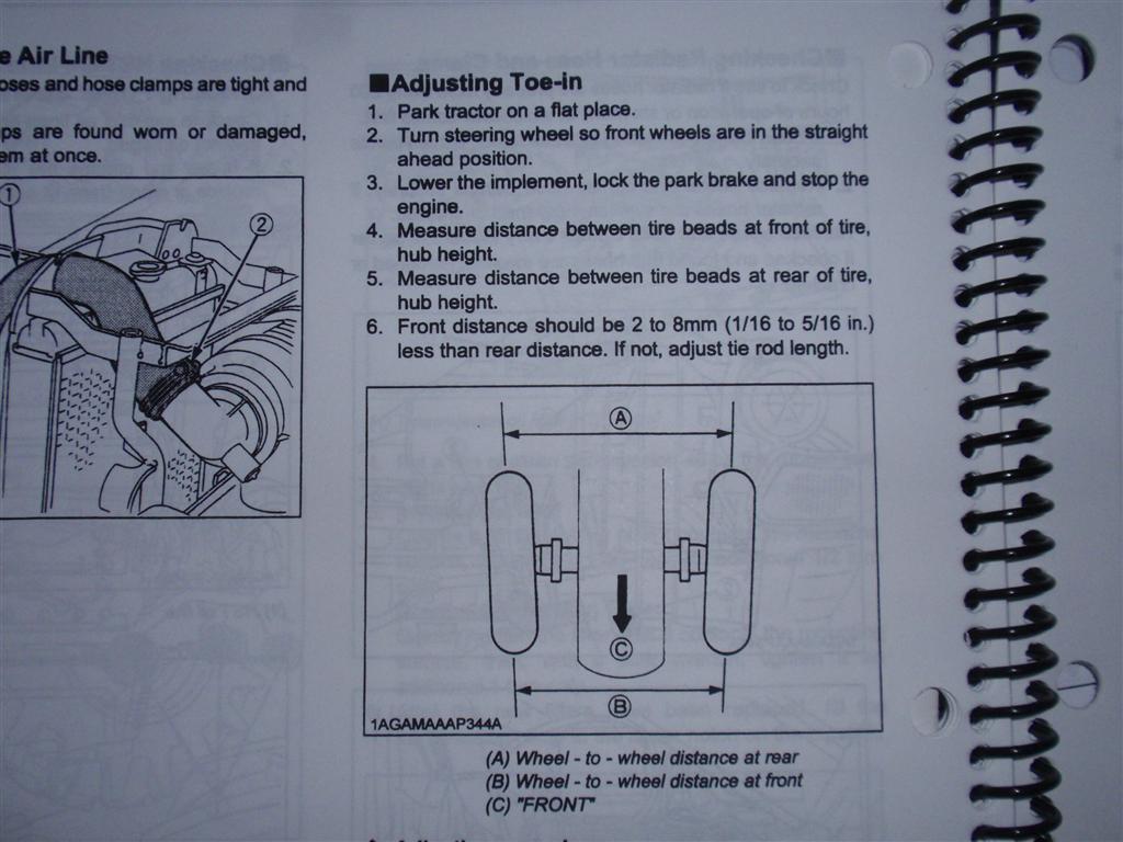

Tires L-3130-HST right tire wear on outside. front axle problem.
   / L-3130-HST right tire wear on outside. front axle problem. #22
It's not 2". Attached is a shot of the toe-in adjustment spec from the L3130 manual.

At 2 inches your tires will not last very long... the outside edge of one will grind off...
Are you sure it isn't 2 cm ?? Even that is a LOT for use on hard surfaces... KennyV
I will call the dealer monday to find out what they say.
Thanks
attachment.php
AH HAH!!!! That's it!!! I read it wrong...I forgot Kubota is foreign!!!

Thanks everybody for all your help....I think we nailed it down, now I can buy some new tires!!! OH Boy!!!DUHH!!!:ashamed:

Well ... at least you didn't go for the 8 side of the (2 to 8 mm) and set it at 8 inches toe in... that may have required you to use the rear wheel lock to move forward...
Glad you are soon to be in a much better handling and steering tractor... KennyV
