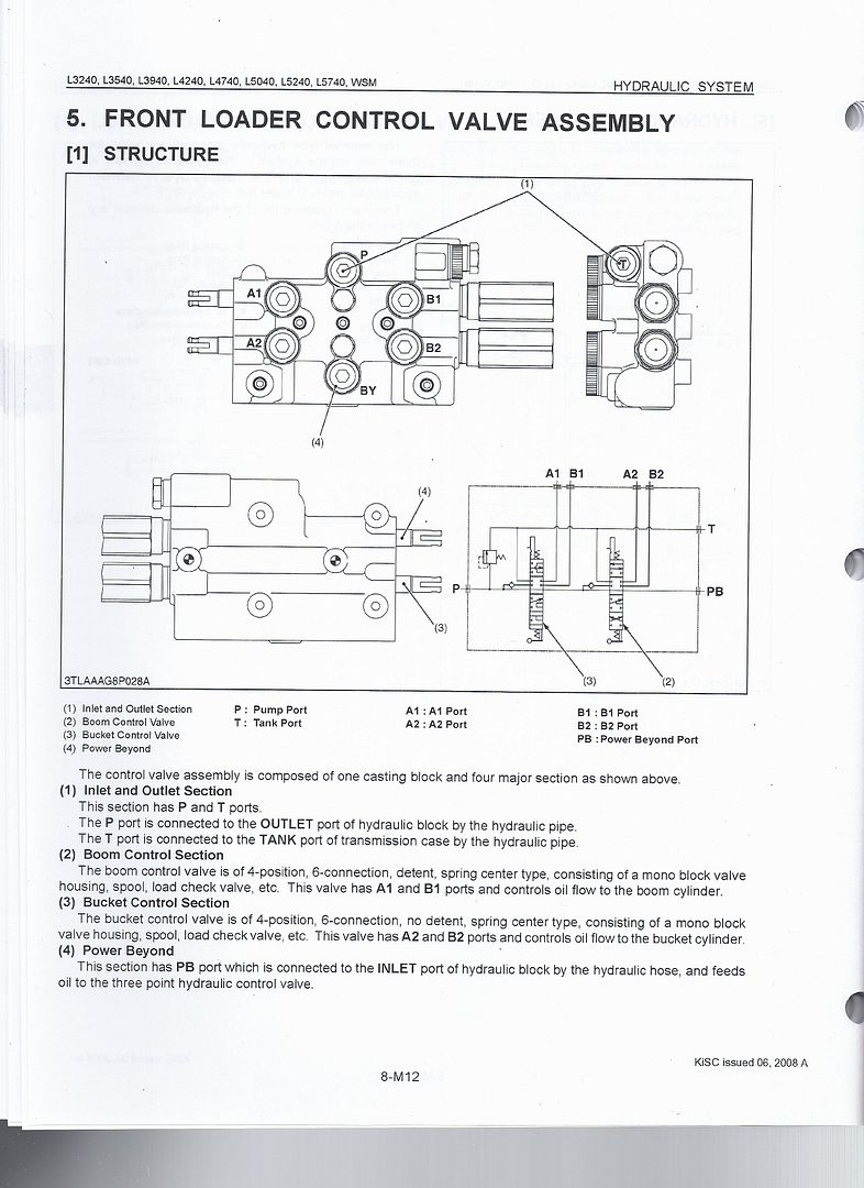

Kuboman I'm doubtful your dealer is correct saying it's normal. I checked my manual and when it comes to the FEL control valve it didn't differentiate between the cabbed machine and the none cabbed unit. Seeing I had a little extra time I decided to add a few more scans so the guys can continue the debate. Very interesting stuff being discussed here by some very knowledgeable people.
In adding the scans I hope it may help others sometime down the road.

Roy;
Well this just keeps getting more interesting. But this test you suggested I just did.
I installed a pressure gauge in the down circuit of the FEL deadhead.
I installed pressure gauge in rear remote, deadhead.
I feathered the down circuit to the loader and achieved a steady 700psi.
I then engaged the rear remote. I got 700 psi at the rear remote. Now here is the fun part. As I engaged the RR the loader lifted. Yep that is what I said. The loader went up. Disengaged the RR and the loader settled back down.:confused2:
Maybe someone who can read the schematics better than me can explain this.

If the rear remote circuit back-feeds pressure to the loader valve and the loader valve was leaking in the up direction, the larger surface on the piston side of the boom cylinders will create enough force to overcome the smaller piston surface on the rod side of the cylinders, meaning the loader will raise.
Feathering valves does funny things sometimes, I don't fully understand the valve geometry and the PB part of the circuit, I just know that it works, better in some cases than others obviously.

Kubo,
Sorry, never even gave that a thought but yes the loader would lift some do to the spool configuration. What happened is that when you moving the loader valve to the lower position it also opens the cap end of the lift cylinders to the down stream PB which feeds the RR. Loader should only lift until both sides of the cylinders see pressure.
Did you get pressure readings or do the intelligent thing and go what the heck and stop?
This at least confirms again that the valves are plumbed correctly, but do to me not thinking it completely through caused you a little panic.
Would you be willing to try it again only possibly disconnect both lift hoses or use the curl. That spool does not feed flow down steam to the PB port. Would sure like to see if both pressures are the same with the RR dead headed.
If they are the same this will really scramble my pee brain.:confused2::confused2:
