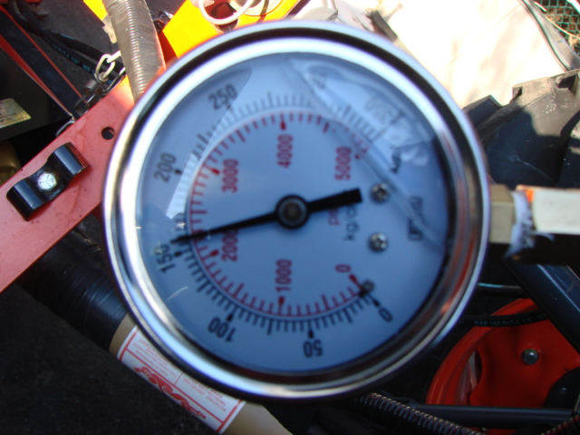

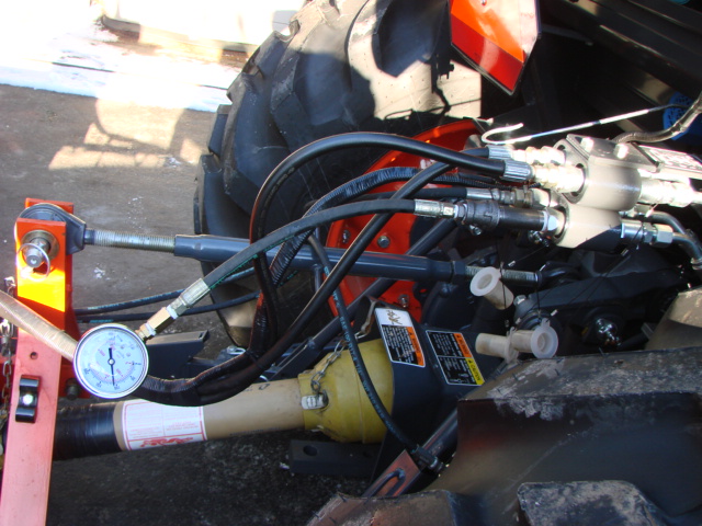

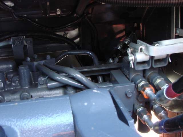

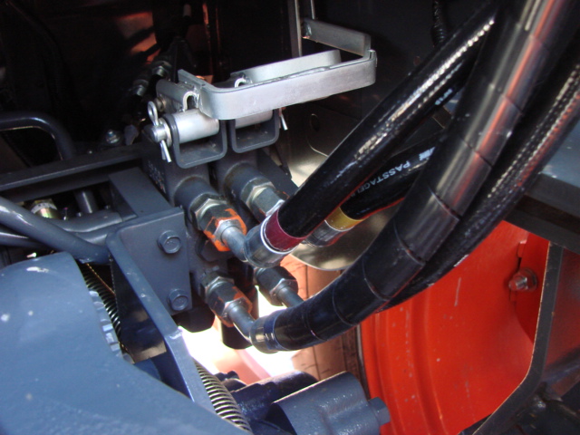

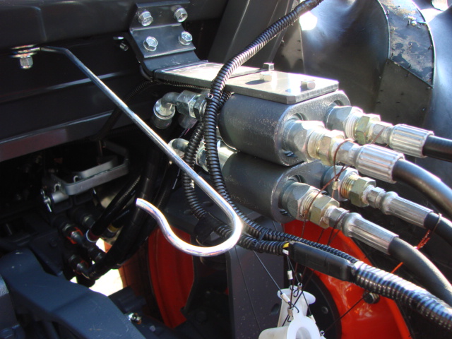

Test completed. The only test I couldn't do was on the FEL. I found out the female connector on my gauge was to large and I really didn't want to start removing the one on the line due to the mess.
I did however do the test on the rear remote and the gauges I'm using are only a month old and fluid filled so it should be accurate.
Tractor was at normal operating temperature and at idle. I did the test four times with the same results. I also included photo's of the plumbing and routing. Mine tested at 2250 P.S.I. If I can locate the proper fitting to test the FEL portion I'll do that as well. Hope this helps.

Thats great info. Do you know what your relief is set at? The real test I guess is to know if you have different pressures between the loader and the rear remotes.
Have you done anything to your relief or is it still factory setting?
