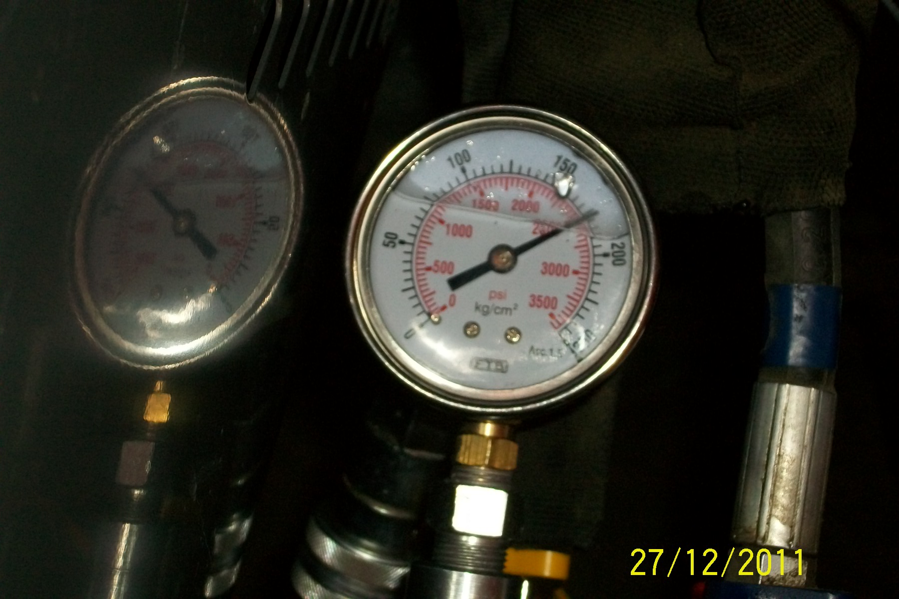

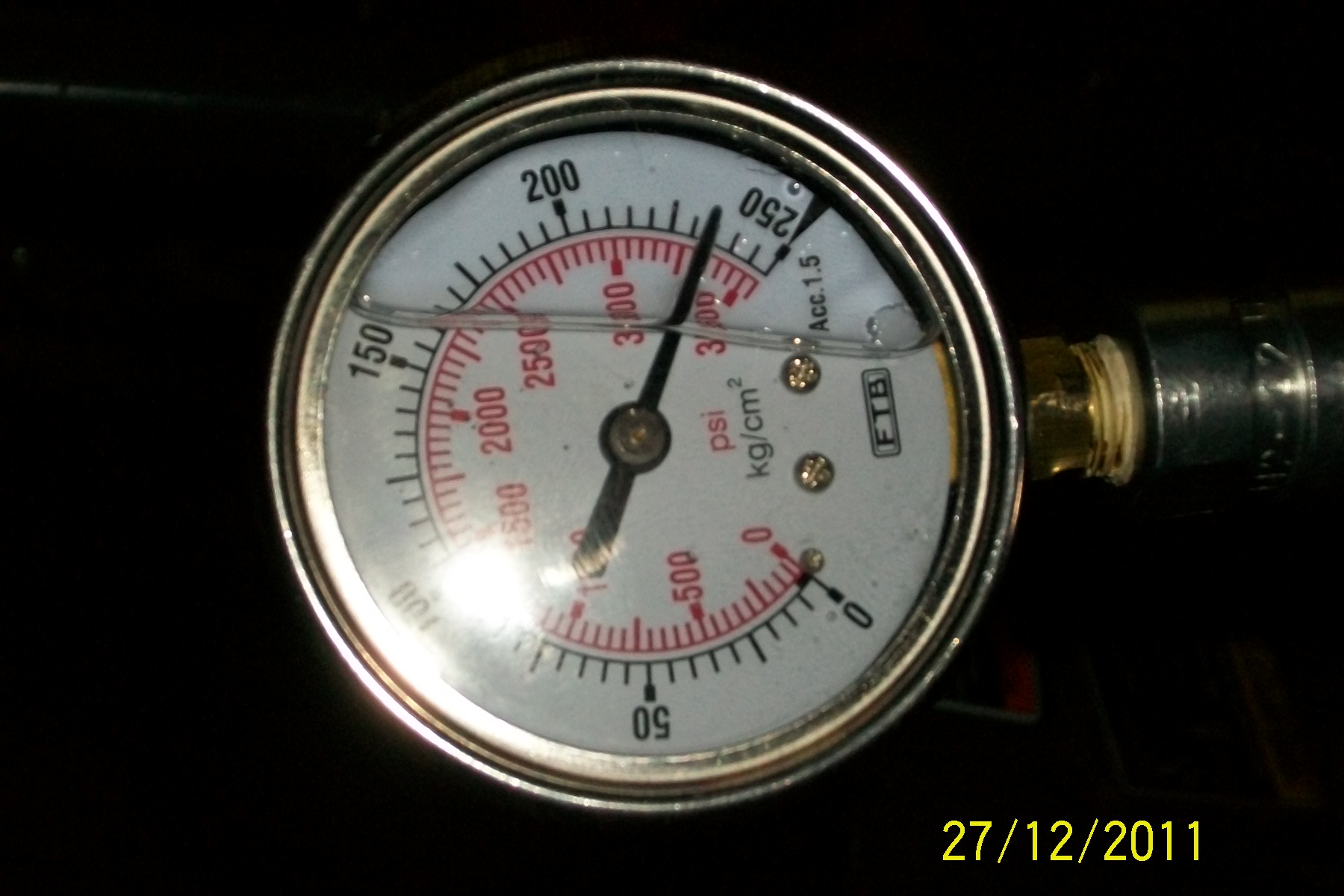

We would all like to see a picture of the 3200 psi on your gage.
One other thought came to mind. Did you perhaps drop the gage and cause it to read high.
If you put it back on the FEL valve for a pressure check would it read 2550 psi as you stated? If so, then we can eliminate that possibility.

I will see if I can get that done today.:thumbsup:

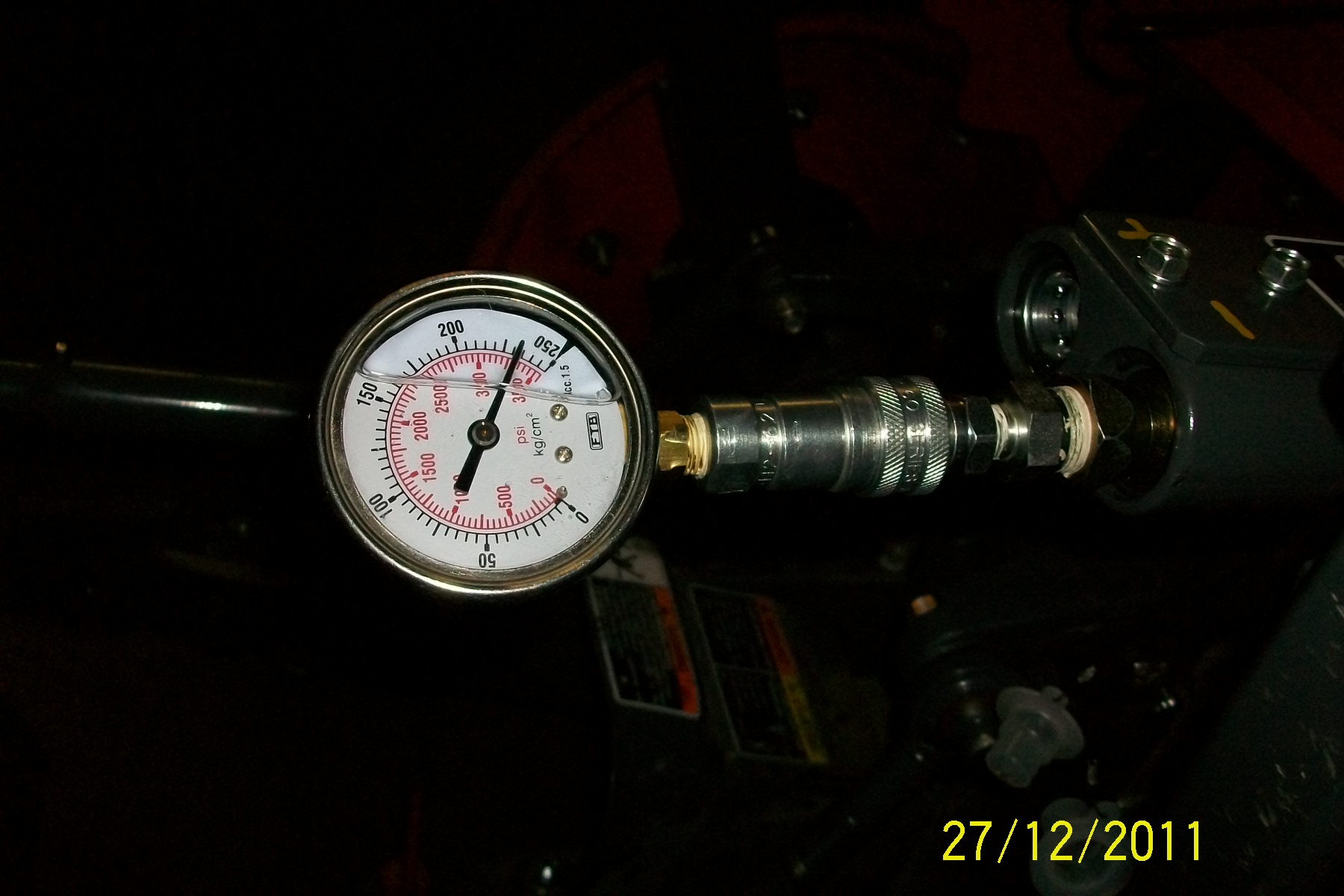

Good thought but I tried the feathering. Just a nice steady build to 3200 psi:(
   / L**40 rear hydaulic pressure
#65

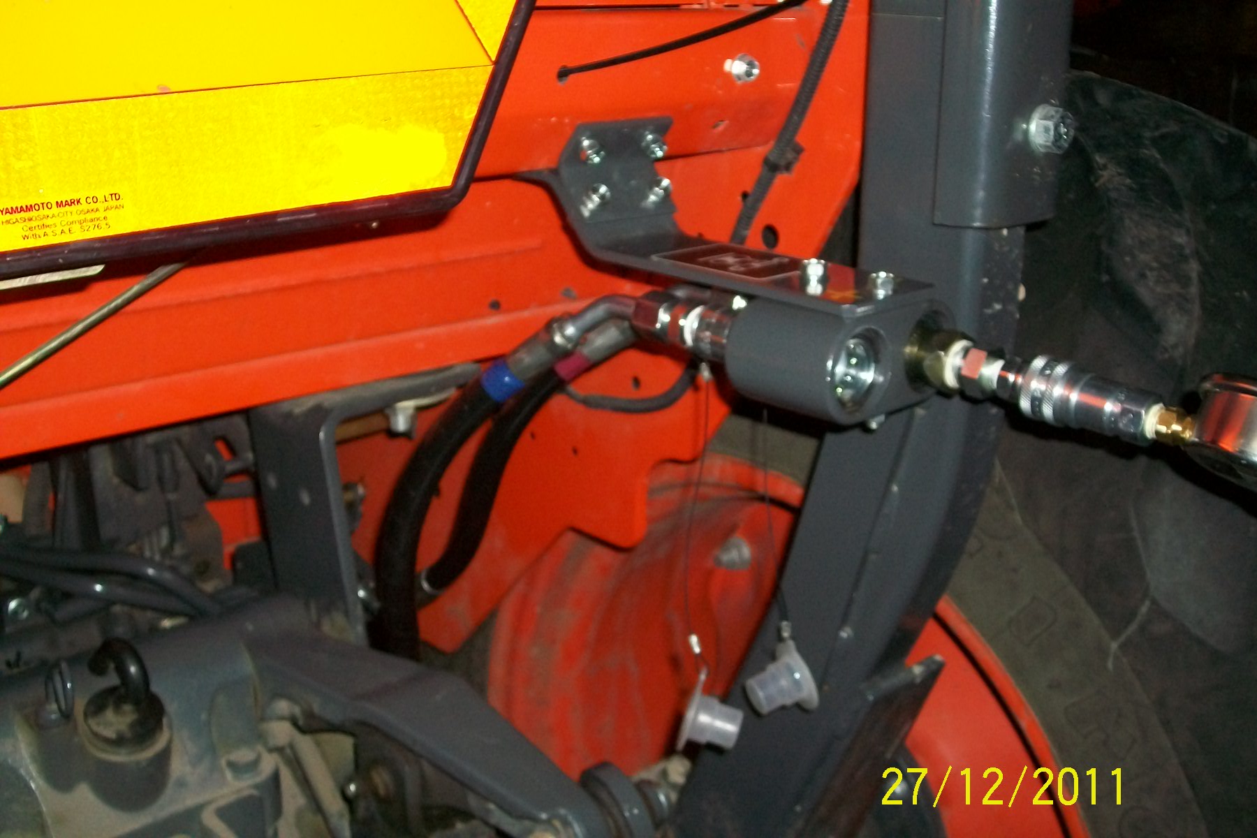

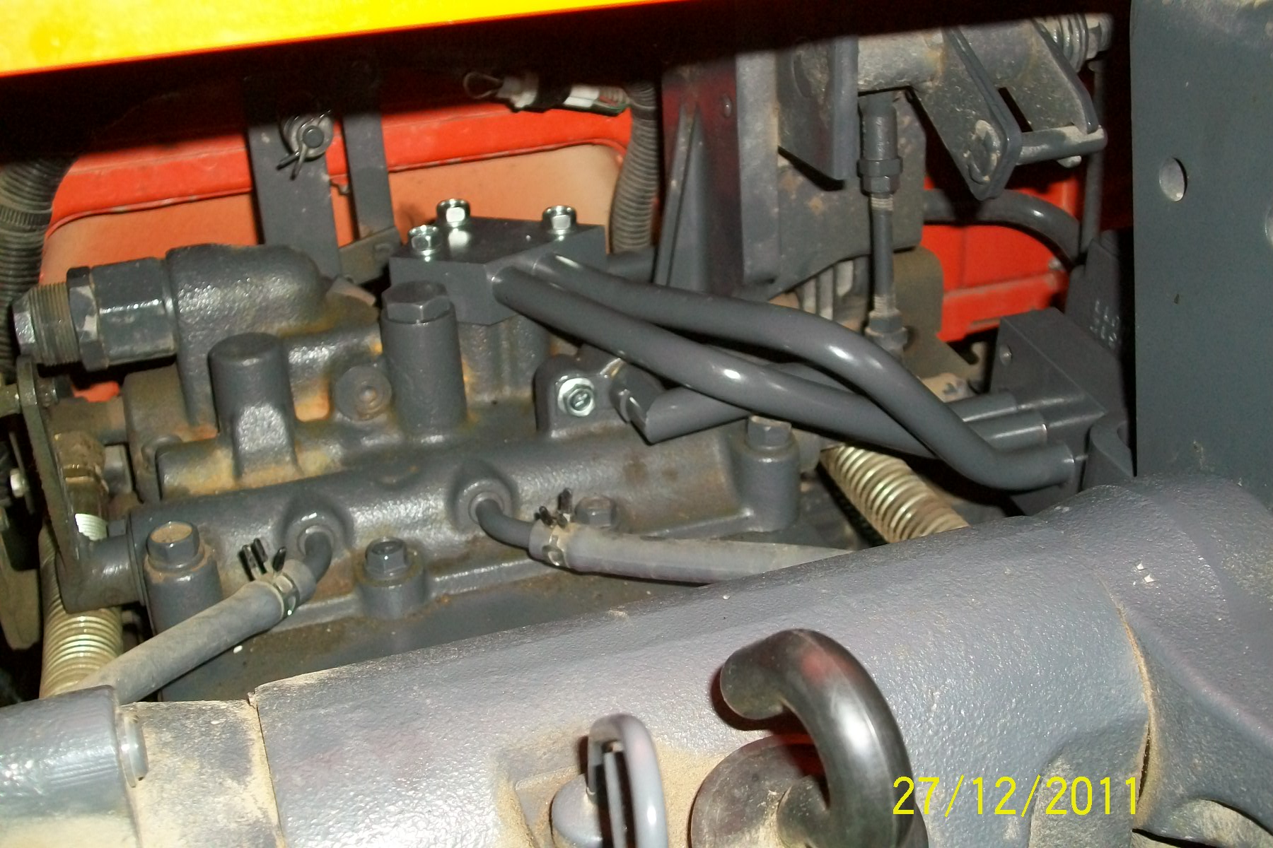

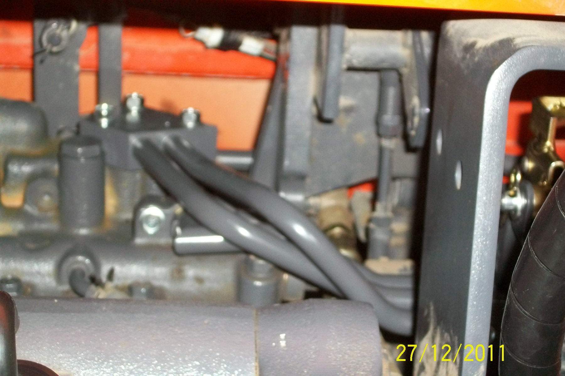

Ok here some pics.
Some of the gauge on the rear remote and some of on the loader. A few of the installation.
All taken same rpm and temp.

Bucket rolls back and the pressure dumps at rear remote. You are right that is what should happen. The more I think about this is I think it has something to do with the flow through to the PB with loader lift circuit. I think with the rear remote activated it dumps a small flow to the backside of the relief which over pressures the remotes. Which also explains:confused2: why lifting the loader and running the remote gives a huge pressure spike.:confused:
