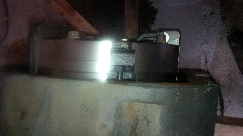

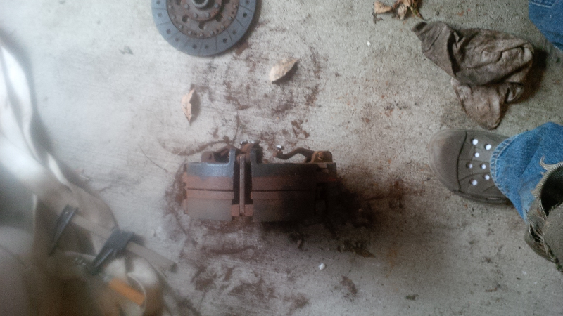

There is a noticeable difference between the old clutch and the one I installed as far as the geometry. The release bolt on the old clutch had a huge gap (bad didn't work). The fingers stuck out much farther on the old clutch.
