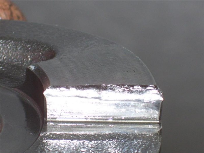

Scott in IN said:
My 3400 clicks when running my rotary cutter and my serial number is in the 54,000 range. I always start the PTO with the tractor at idle and then throttle up, to disengage I try and decrease the throttle down to idle to keep it from clicking. If it starts to click I'll mash the clutch and throw the PTO lever. Man, I hope this doesn't become an issue. I researched the Kubota line a lot before I bought my tractor (which is worth way more than my car).
Geez, I'm going to call the local dealer here in a few. Which may be a another issue as I bought mine used to save a few thousand dollars but is should still be under warranty right?
Your tractor has a basic warranty that covers everything for 24 months or 15 hundred hours
If it is under 3 years old and with less than 3000 hours it still has a powertrain warranty, and I was told by Kubota that the repair work for PTO issues will be cover under the powertrain warranty. Which is nice to know, but does nothing for long term ownership of these tractors and after the warranty has expired. From my experience I'm not going to risk it unless Kubota can assure me that they have come up with a replacement cure and then install it and then stand behind it.
Kubota has been good at the temperary fix so far and its not cost me anything but downtime and the cost of a rental tractor so I could finish what I had started, but after the warranty expires it's your baby as of now, but I'm seeing what options there are to cure this issue.
I will admit the first when the first time the PTO went out of my tractor and it was in the shop for 5 weeks, that didn't set real good with me and the fact I had made a tractor payment and didn't even see the tractor for a month after the third week from buying it.

Well I just got off the phone with my local dealer's service manager who basically told me there was nothing to worry about. He said that the service bulletin (PID -2005-022) had to do with adding more SUDT (a quart or two) to quiet the clicking. He said that the clicking did not damage the tractor and there was no problem with the pto clutch as long as I had a properly adjusted slip clutch on my implements (which I do). He added that the people that were having problems were probably using old implements without slip clutches which was causing the problems (hitting big rocks and stopping the implement). I guess I'll just run it and see what happens.....
Hummmm?
Hummmm?
Ask him why Kubota no longer uses the two way locking cams in these tractors. I'm sure it's not because of old implements and big rocks. I have proof that my old B2910 never had issues with old implements and big rocks with over 3000 hours of use doing the same type of work it, when it took only a couple hours of PTO use the first time it faild and around 25 to 30 hours of use with the new and improved cams the second time it failed. I'm hoping for around 50 hours before they go the third time with the second set of updated cams that was their solution for their design flaw.
Show your service manager this picture of second set which are updated cams that came out of my tractor and ask him if it took care of the problem.
Also Kubotas soultion about adding more oil as a cure is proof they knew of the problems that in time would they have and it did nothing but make the noise less noticeable and really did nothing except cost you more money by having to add more oil when you service your tractor. I see that as a half (you know what) type of cure when the real problem is the system itself is bad. Kubota knows it, but I don't see them ever admitting it.

I'm just wondering why the old system was changed to the new non-racheting system if there wasn't a problem with the old system?
