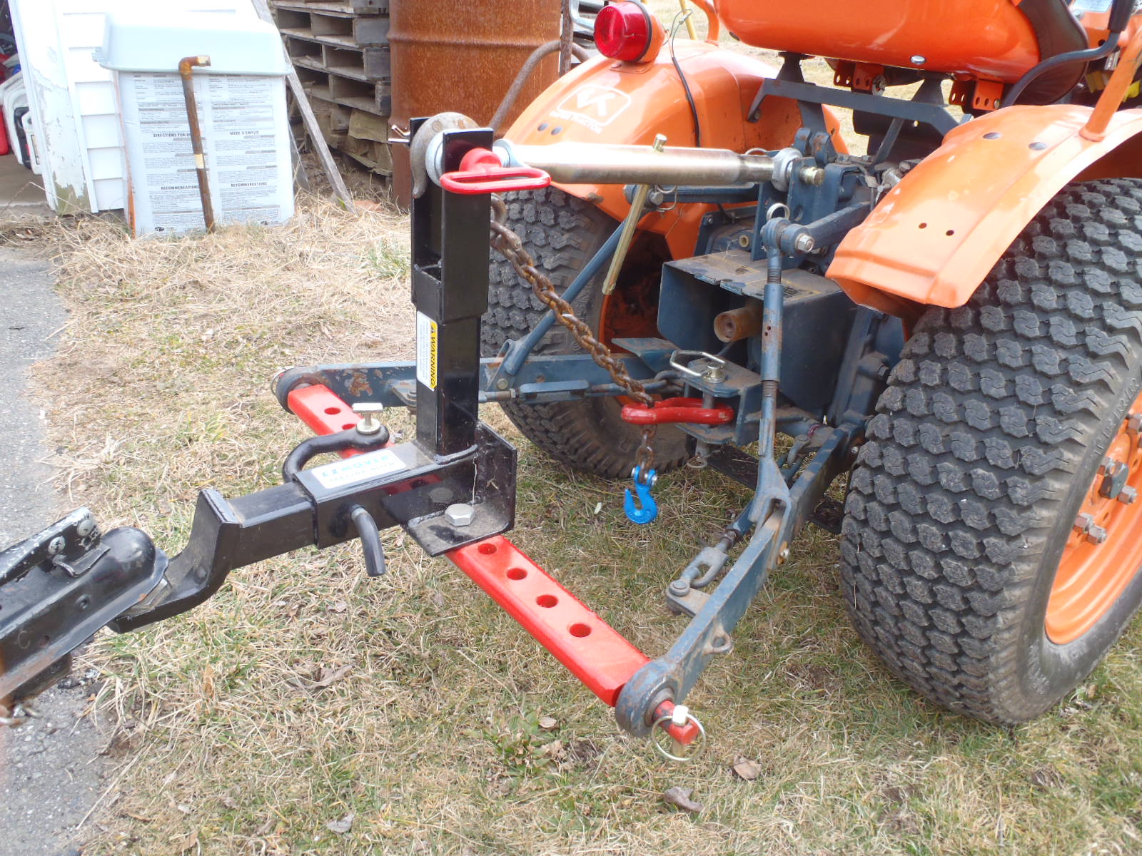

When towing a trailer with the 3pt, I add a chain connecting the draw bar on the transmission to the top link on the implement.
This prevents the 3pt from rising if the load center shifts aft:
Great idea for sure. I have not seen this before. However, may I caution anyone to at least give the chain a couple inches of slack, if your weight distribution is more towards the back causing the 3pt to lift, your going to want a way to know your load is unbalanced. Knowing this may effect how brave some may get in tough terrain or what have you just by knowing that you won't have X amount of weight on the rear tires. Seriously though that's a good i-dear Baby Grand.
I use the general rule of thumb of a 60/40 weight distribution when loading trailers, 40% to the rear of the axle(s) center & 60% foreward. Not that there is any way to measure this perfectly but most can get a fairly good idea where their load sits. ...unless your moving marbles of course.
