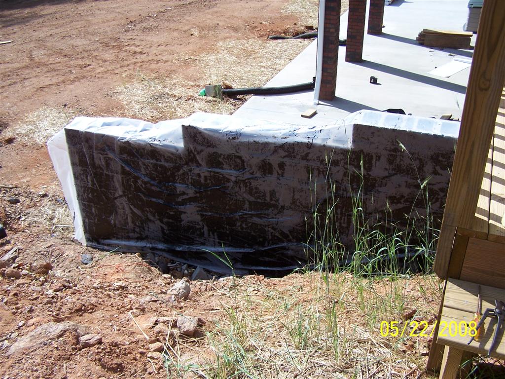

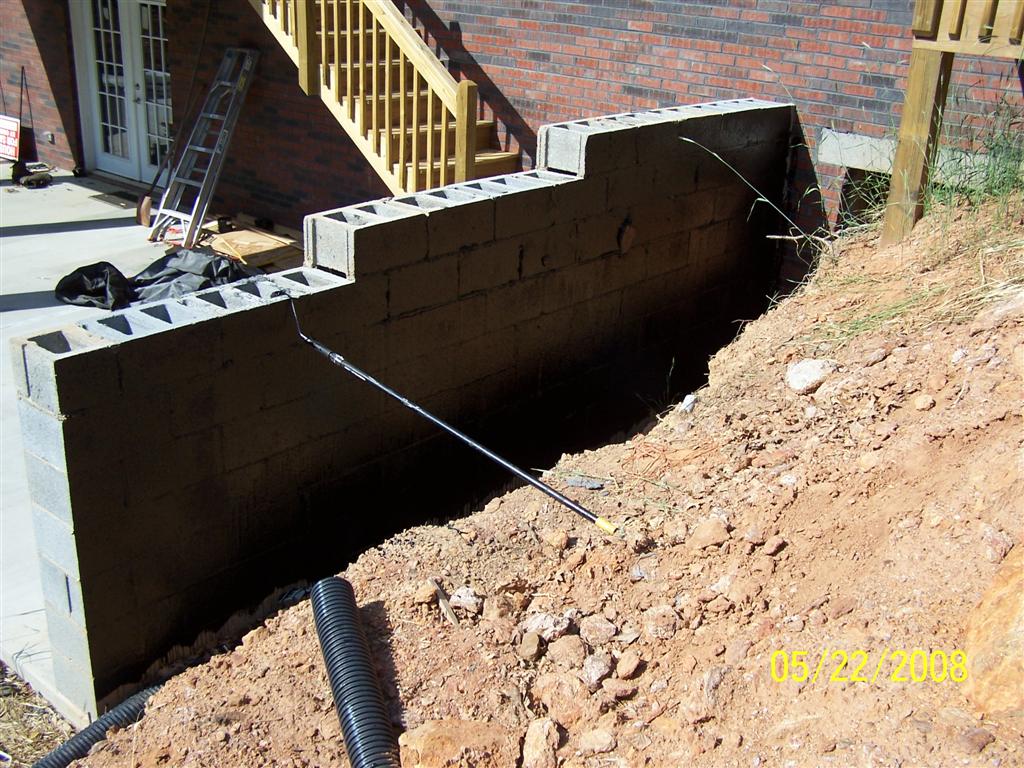

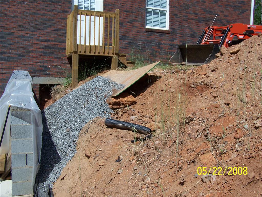

Started with the retaining walls in back.
1st pic is with waterproof applied, 2 coats.
2nd pic is with construction plastic added.
3rd pic is adding washed stone.
I finished with about a foot of dirt on top and spent therest of the day grading around the walls. I did not get pics of the grading but will post some in a couple of days.

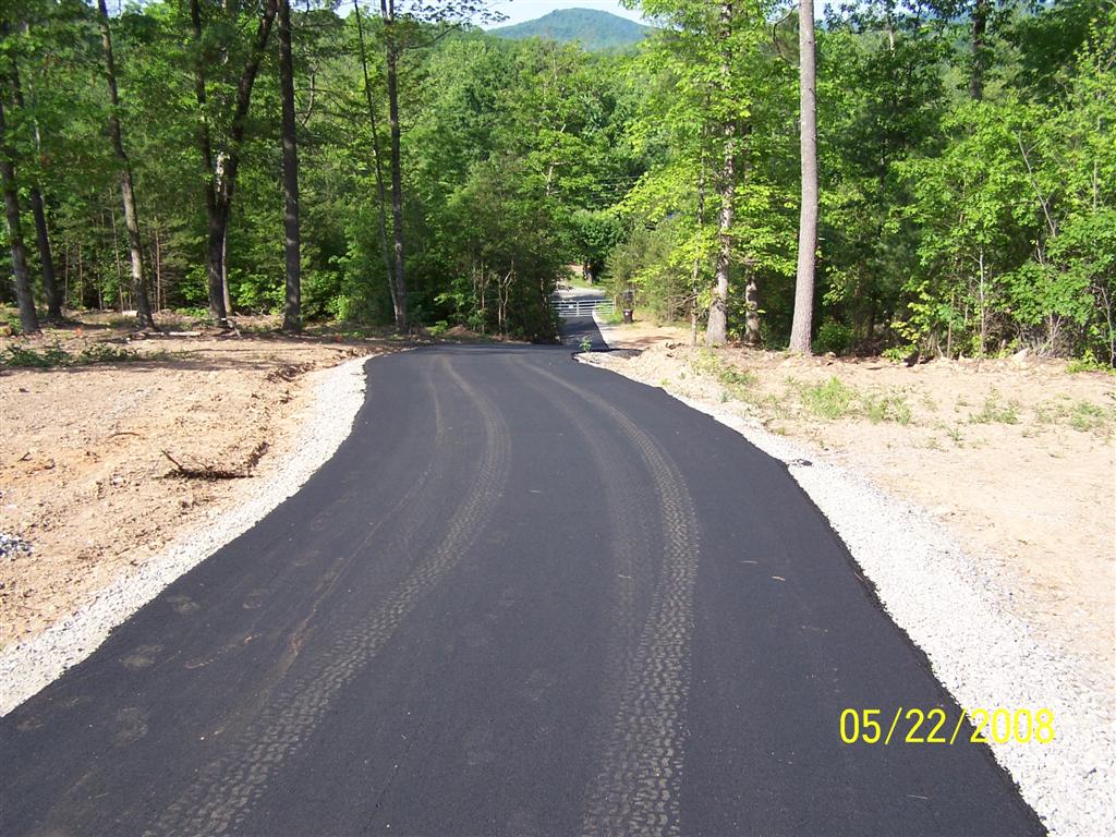

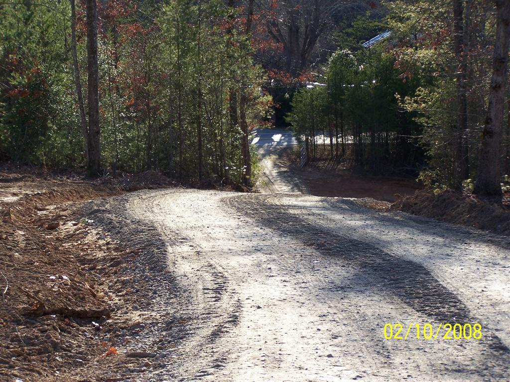

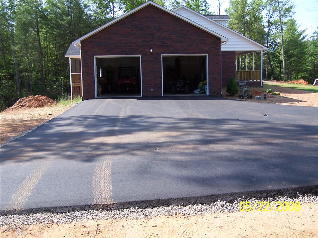

Was able to get the driveway and pad poured last week.
1st pic is the pad.
2nd and 3rd pic is a before and after of the drive.

   / Land Clearing to House Building... #355
Oh man, that sure looks nice.
With the incline you have you'll be happy you surfaced. I've given a lot of thought about doing mine as well, especially after those rains we had. It dries up quick and gets hard again, but while it's wet it's terrible.
Yours looks really good. How thick did you go David?

Rob,
You are correct about the incline. With gravel it was hard sometimes to get the F250 Powerstroke up it without spinning unless I used 4 wheel drive.
Most pavers around here go 2" thick. The guy I used went 3-4" on the pad and on the incline. The flat area at the bottom of the hill is 2". He used a vibratory compactor on the incline. Overall he did a great job. He takes a lot of pride in his work and came back by two days later to check on the road and said he would come back once a month for the next few months to make sure everything was holding up and curing.

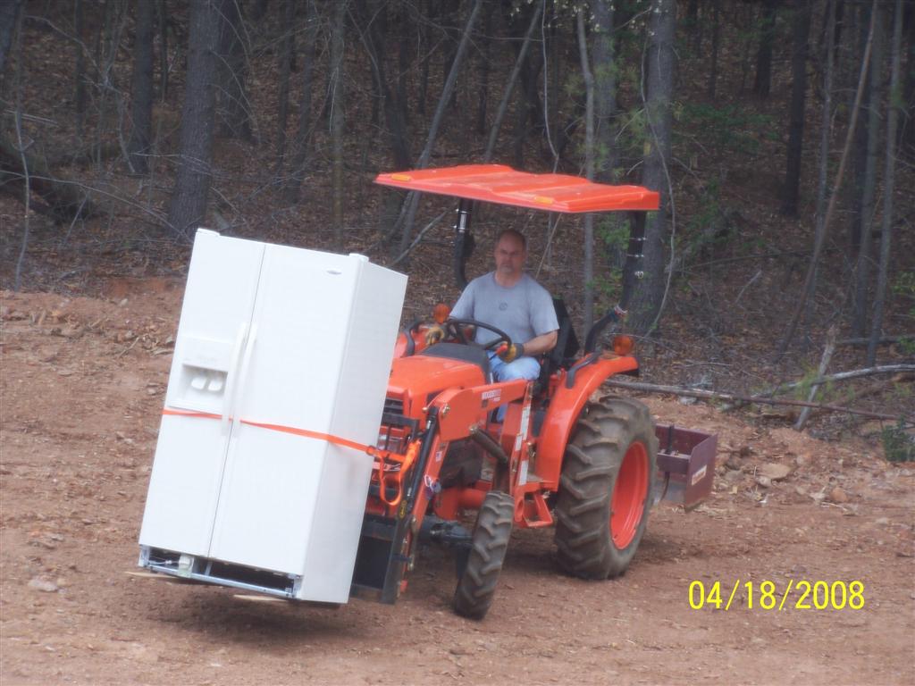

I had to use the tractor to move one of the refrigerators to the basement. Sure made it easy to unload off the truck!

Hey David! The drive looks great! I wish I had the budget for the asphalt right now. My slope is not giving me any traction problems, so I'm in no rush other than aesthetics.
Love the refridgerator pic. It's always nice to see tractors used in creative ways.
