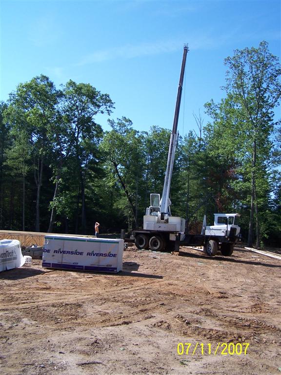

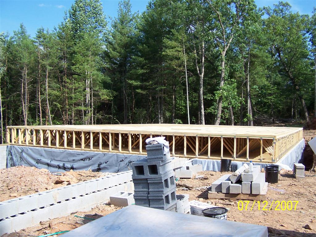

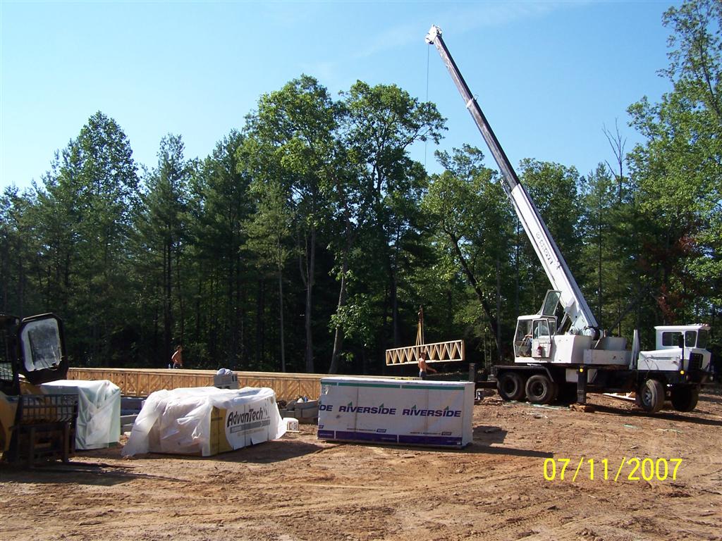

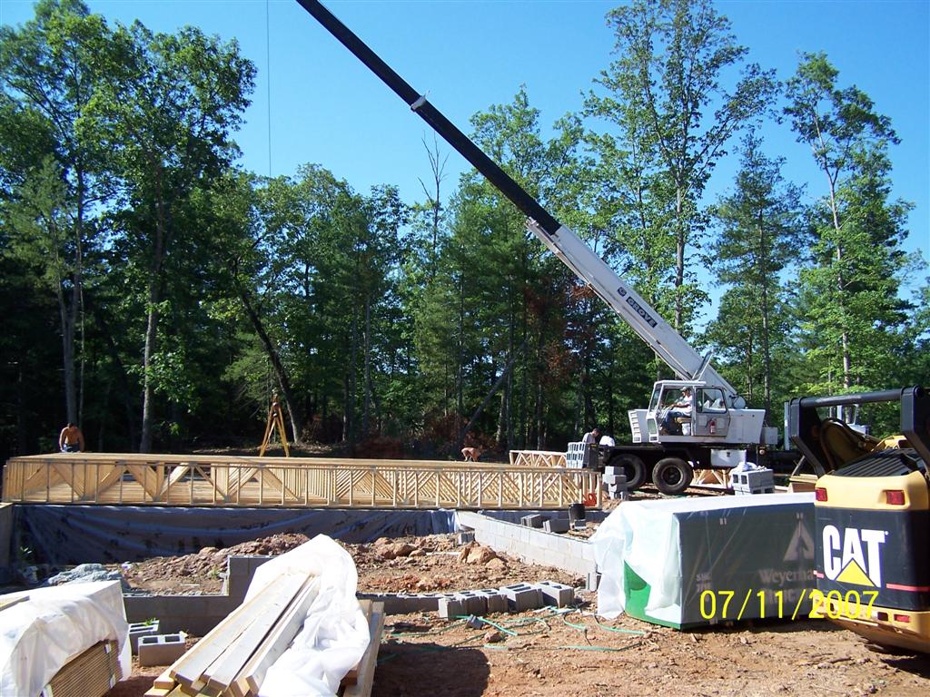

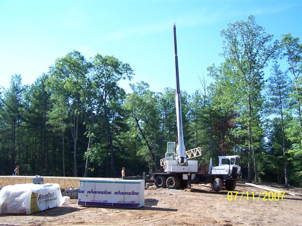

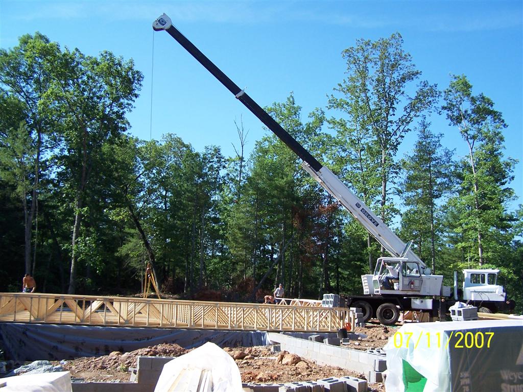

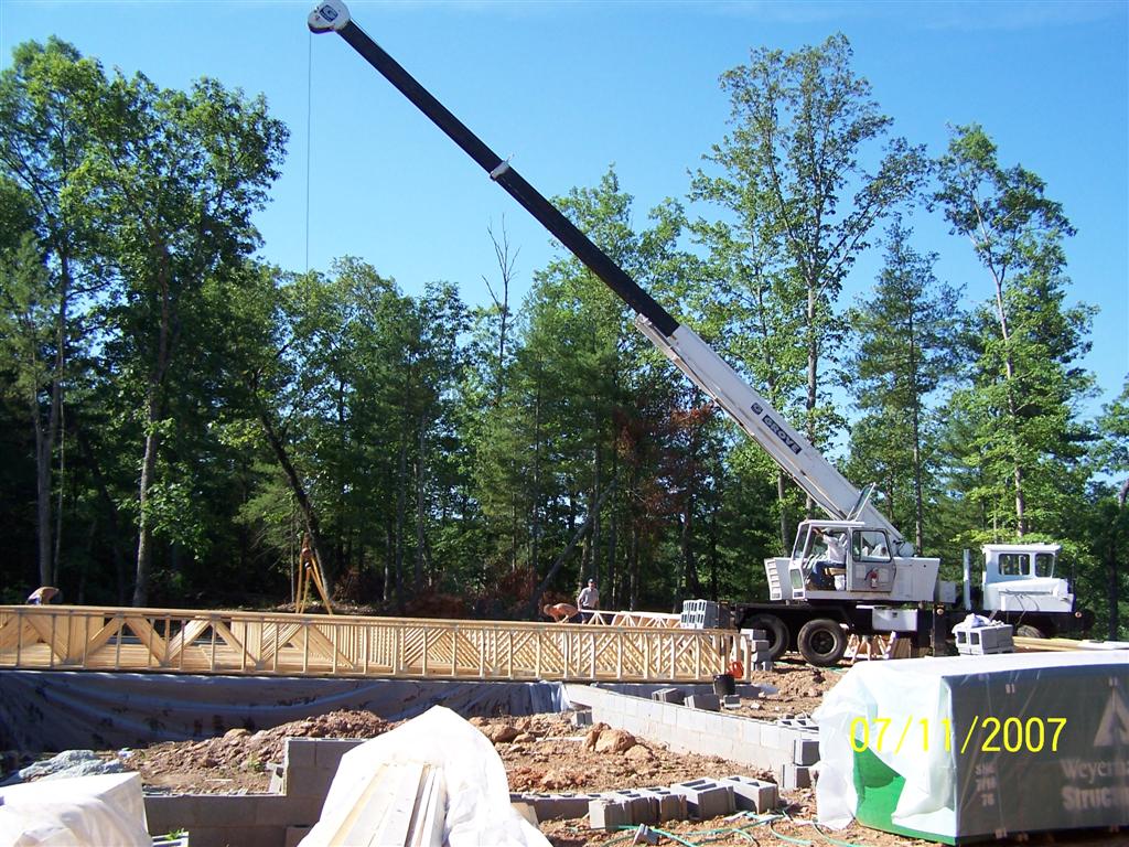

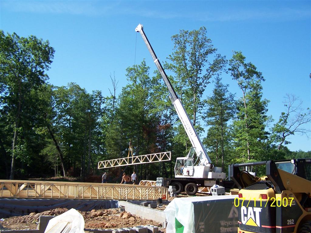

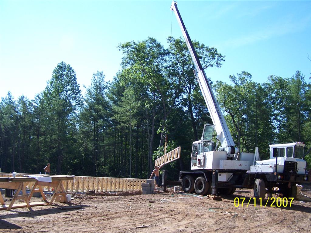

Crane and floor trusses arrive!!

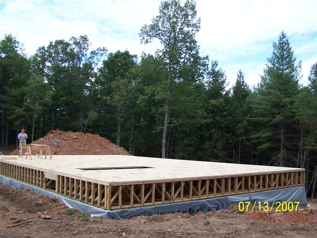

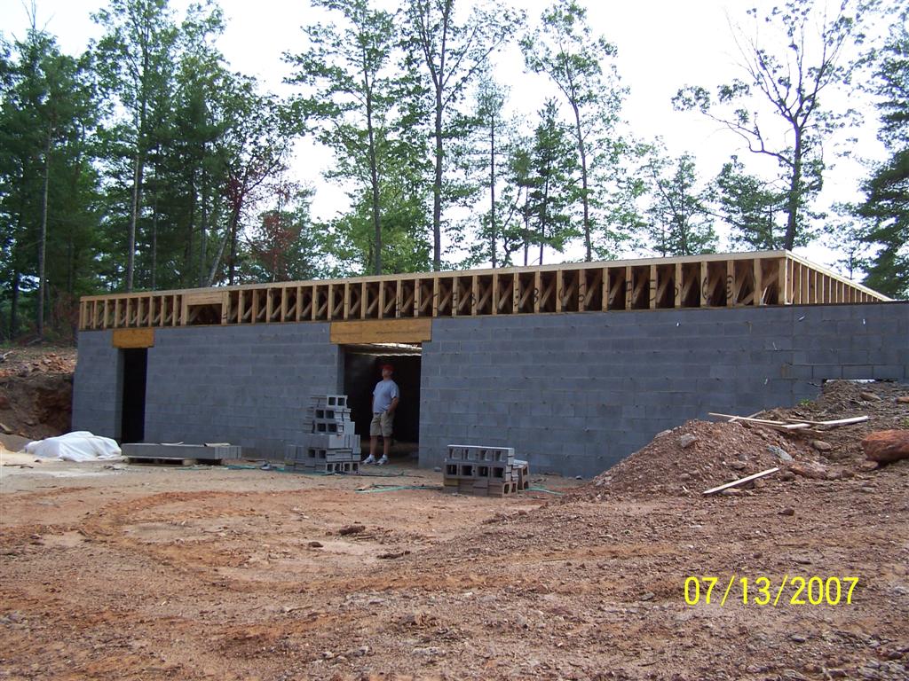

Sub-floor going down.

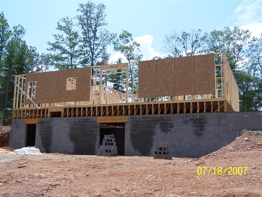

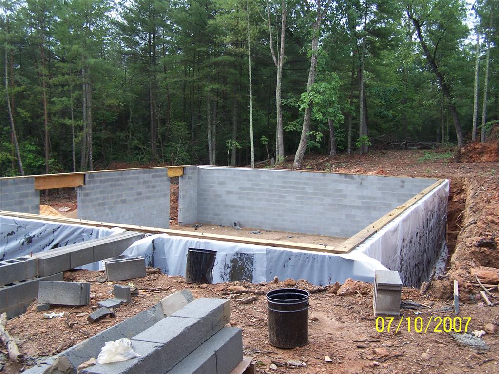

I noticed there was no rebarr in the concrete footings nor in the block. How did they bolt the subfloor to the block?
   / Land Clearing to House Building...
#54
The rebarr was "inside" the footings. For the block, they were pumped full of concrete with tie-down bolts inserted to hold the seal plate.
I have a picture with the seal bolted down, I'll try to find it and post.
#55
Found it. This is the best pic I have showing the plate bolted down.

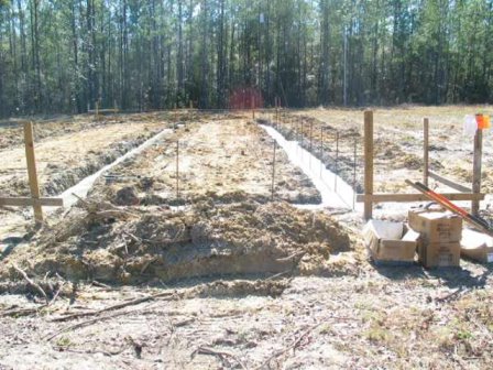

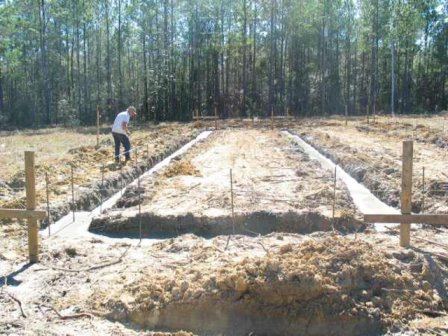

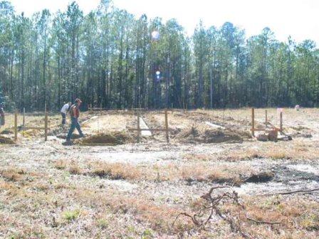

Great looking place you have going!!
I was curious how the block was tied into your footers?
Here are a couple of pics of how our footers were looking before the block was put in.

PSDStu,
Here the block are set with mud, no rebarr required. They do require every other block to be filled if rebarr is nto used. My builder fills every block however.

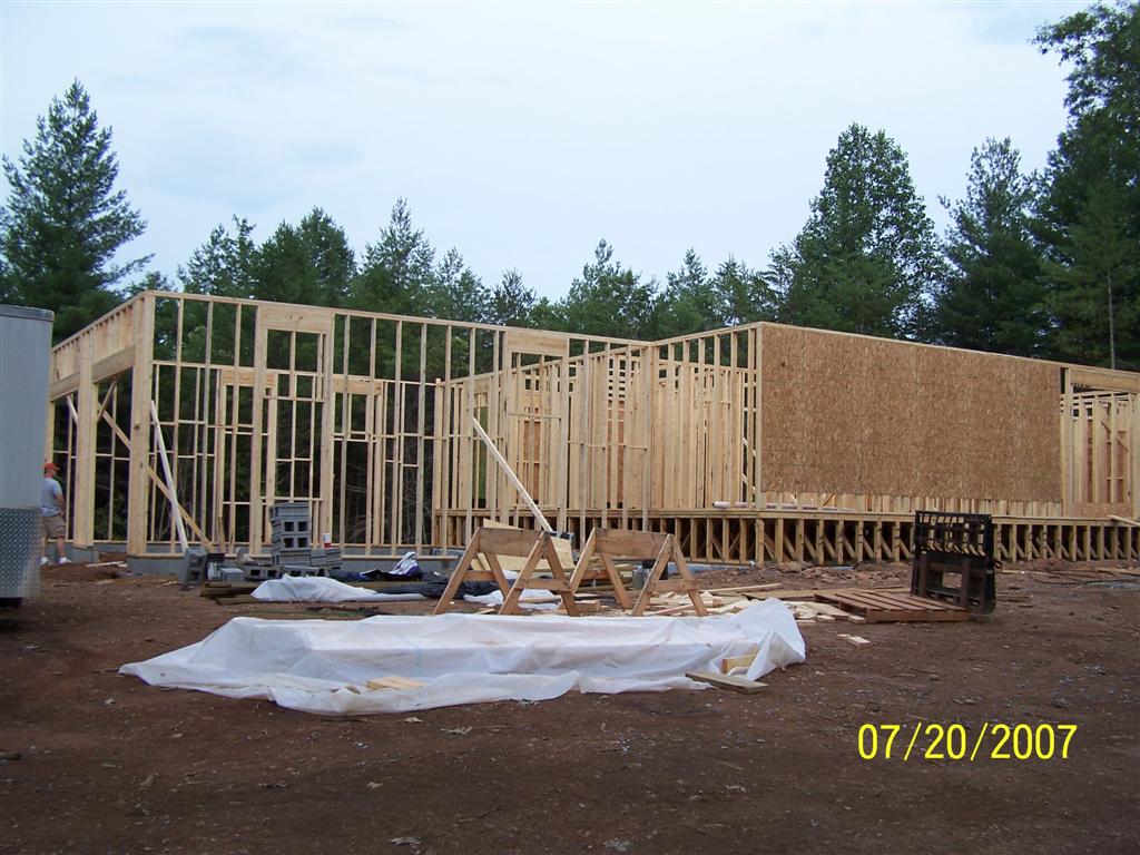

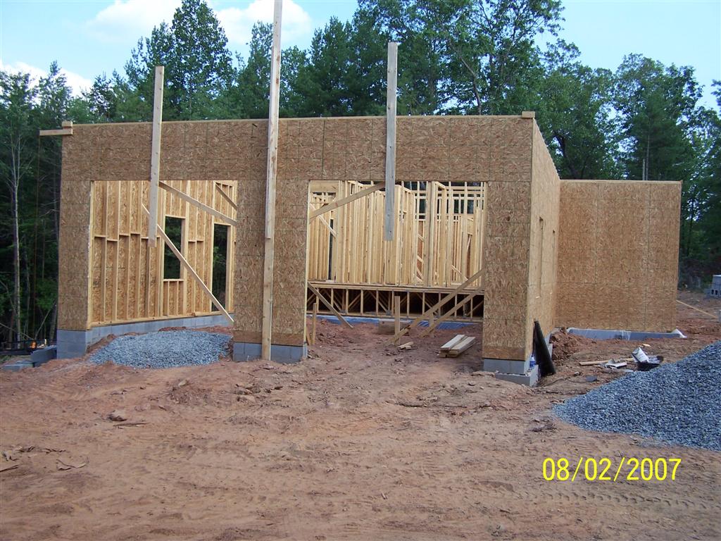

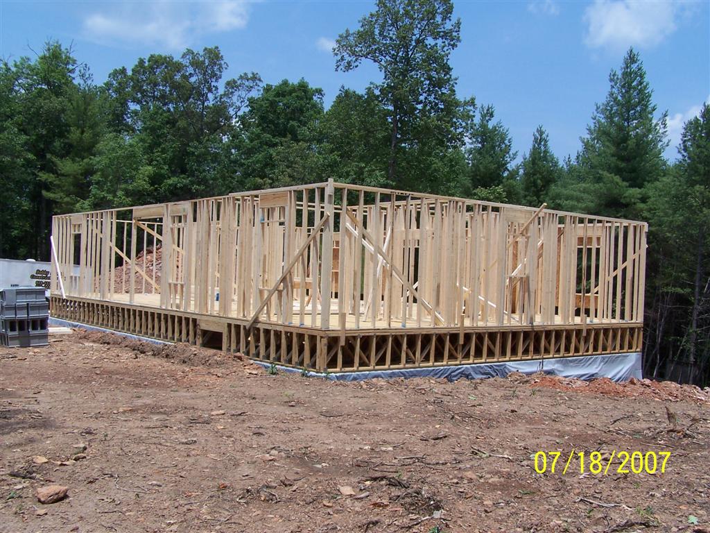

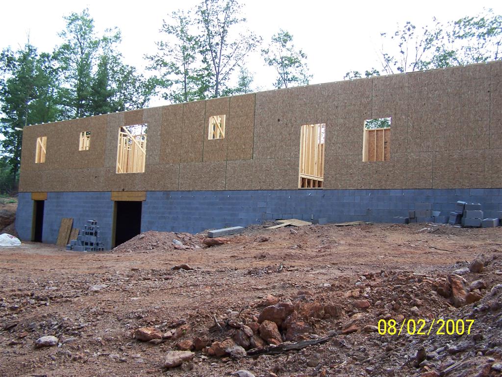

Framing starts...

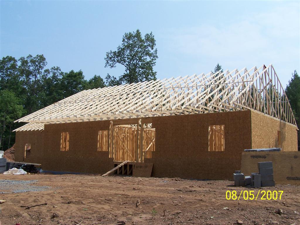

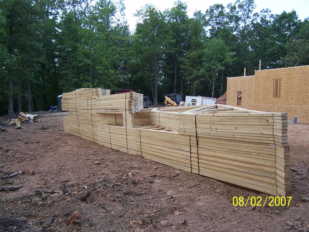

Roof trusses arrive!
