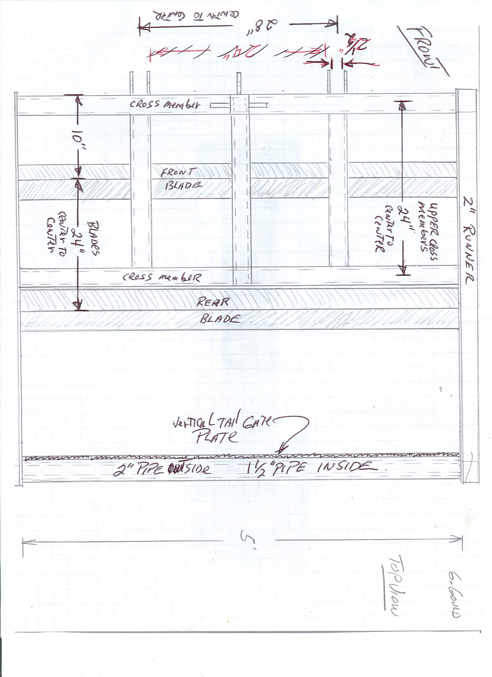

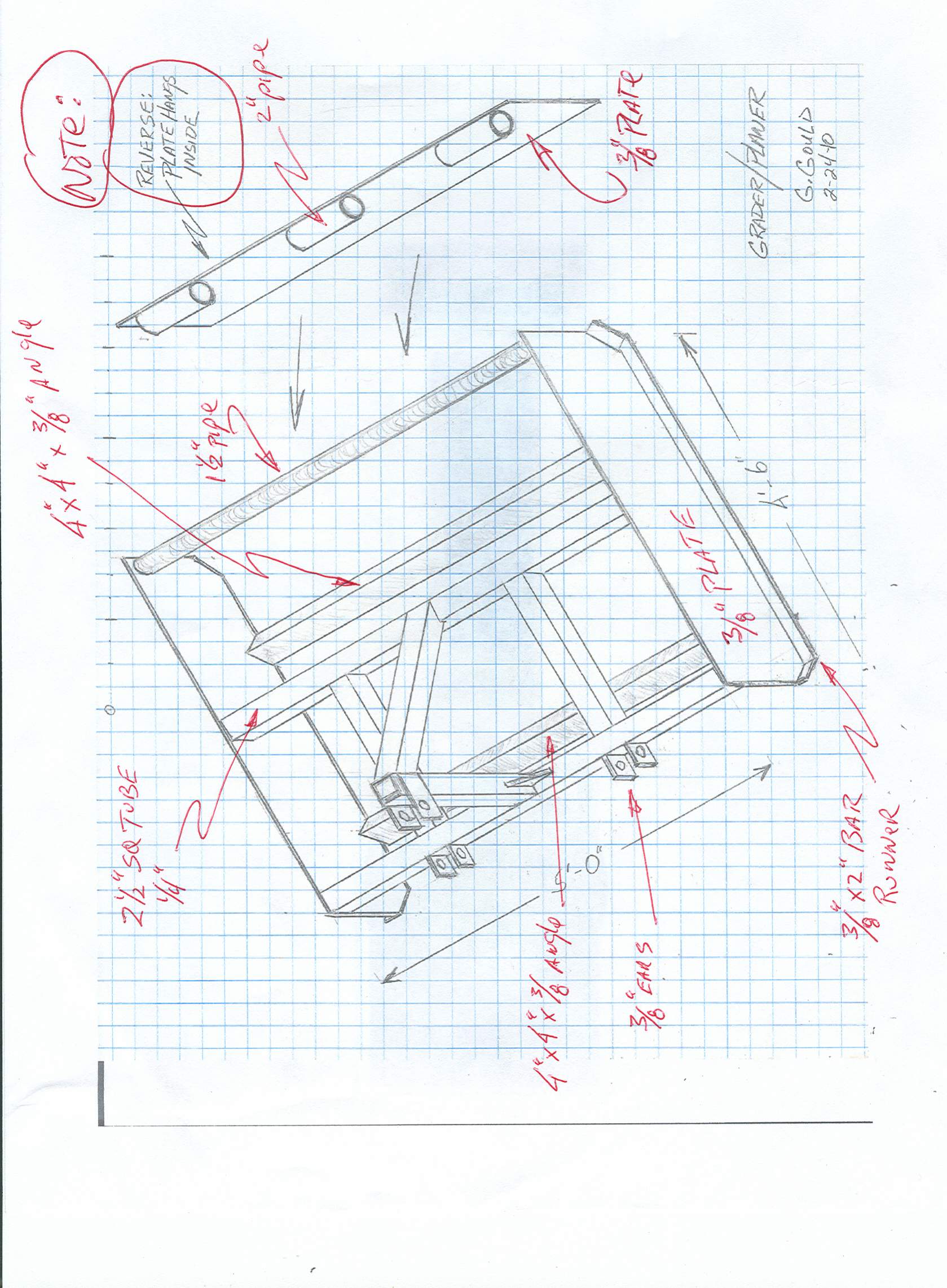

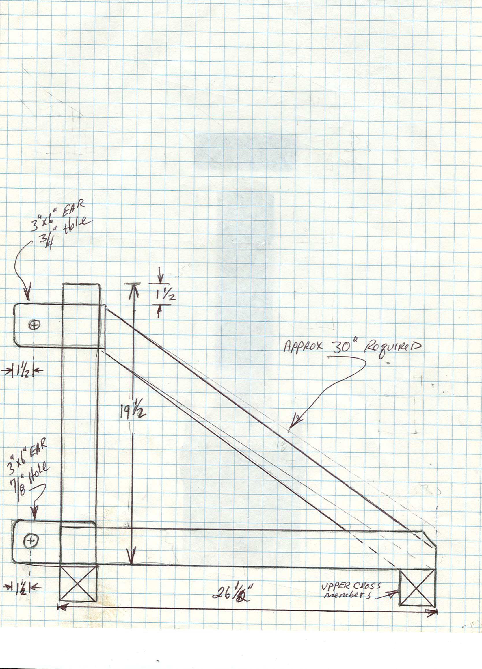

Gordon,
I am new to this forum, but I am looking to build a grader very much like yours. My question is how far did you extend the cutting edges from the bottom of the grader? Did you mount them to angle iron and at about what angle?

Welcome to TBN Jeremy.
Take a look at the first picture back in post #10 on page one of this thread. It show how the cutting edges are mounted and should help you. The blades are mounted on 4" X 4" X 3/8" angle iron which would put them at about 45* and I set them 3/4" below the runners. I am not sure if this is the best way. It is just how I did it because I didn't know any better. Hope that helps.

When I built this larger 8' landplane in 2009 I built it with the blades flush with the wear strips. Seems to work very well and you can easily load it up with dirt or gravel. Something to consider is setting the blades lower maybe a full inch and having a wear strip with wood shims between them and the frame for spacing the blade off the ground. This would allow you to dig deeper when remixing the gravel and fines on a driveway. When you wan't to finish grade as in the last two pics you could add the shims to make the blades flush with the skids.

The skids are 5' long on mine and work well enough for most things. I could see building one with longer skids for dedicated driveway and gravel road work with up to 8' skids. When I was looking at pics of some of the factory made models most had skids about 4' long. I found a deal on some beam drops that were a little over 5' and made them as long as possible which is what is in the pic. You have to think about the limitations of longer skids though, the extended skids can limit your use when backing up to objects and take up more room on a trailer.

The skid spacer thing is simple really, instead of welding the lower wear strips in place weld studs on them and drill holes thru the beam flanges and bolt them down. You can use wooden spacers to space the wear strips away from the main beams/skids thus lowering the skids running surface.

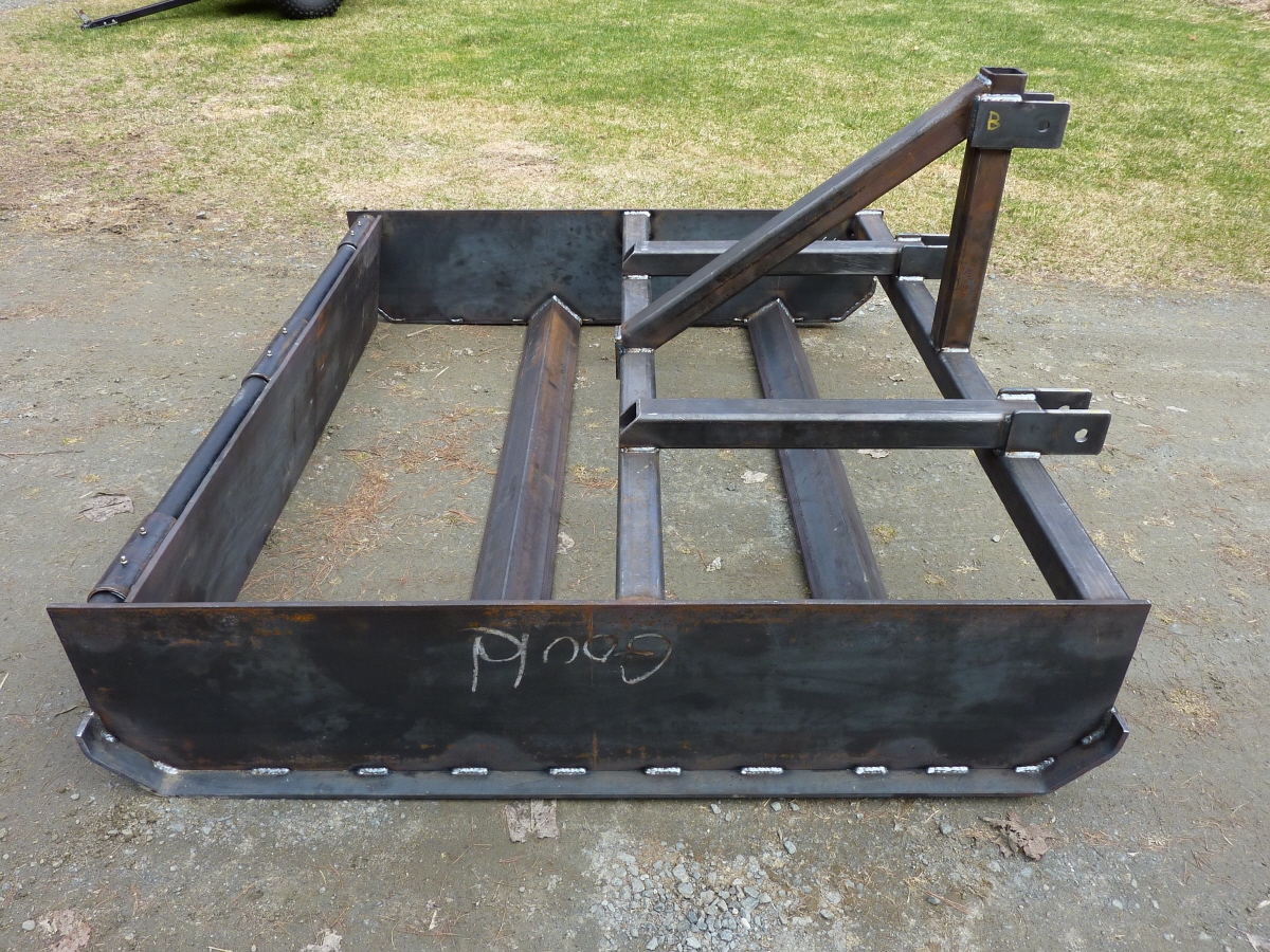

In looking at my needs I realized Gordon's land scraper would fit my needs more so than a box blade. I'm building one of these with a combination of scrap steel and new steel. I had a 48"x30"x1/2" steel plate laying around. I had a local shop cut it in half (the long way). I purchased most of the materials listed on Gordon's bill of material. My total investment right now is $353 some of which is surplus material for other projects :) I'm guessing the weight upon completion will be somewhere between 500 and 550lbs. Overall dimensions are 48" long and 60" wide. Yes, I'd like a longer one, but... that's the plate I had. Right now all of my material is cut. Grade 8 bolts and 7/8" hitch pins were purchased. Tomorrow I start welding. Pictures to follow.

Here's the progress. Welding never took place as my brother needed some help that involved some seat time on the tractor. Naturally that took precedence over this. I'm out of plate material at the moment so there's no rear gate going on just yet.
