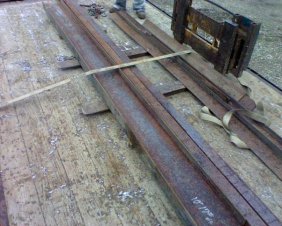

/ Land plane/ grading scraper #58
Where did you buy your cutting edge from?
I was lucky as I got the blades for free from my local council. They are used ones that they don't want but have an unused cutting edge so I could use the new unused edge and welded them on for the cutting edges as well as the wear slides, If I ever wear them out I will just weld a new set over the top of the worn ones, I don't think I will wear them out though. I ended up using five 7' blades, 2 for the cutting edges and one and a half each side for the skids. I would think any local council would have used blades that you may be able to get your hands on.
My local farm machinery mob does sell new 7' grader blades at $160Aus each.
