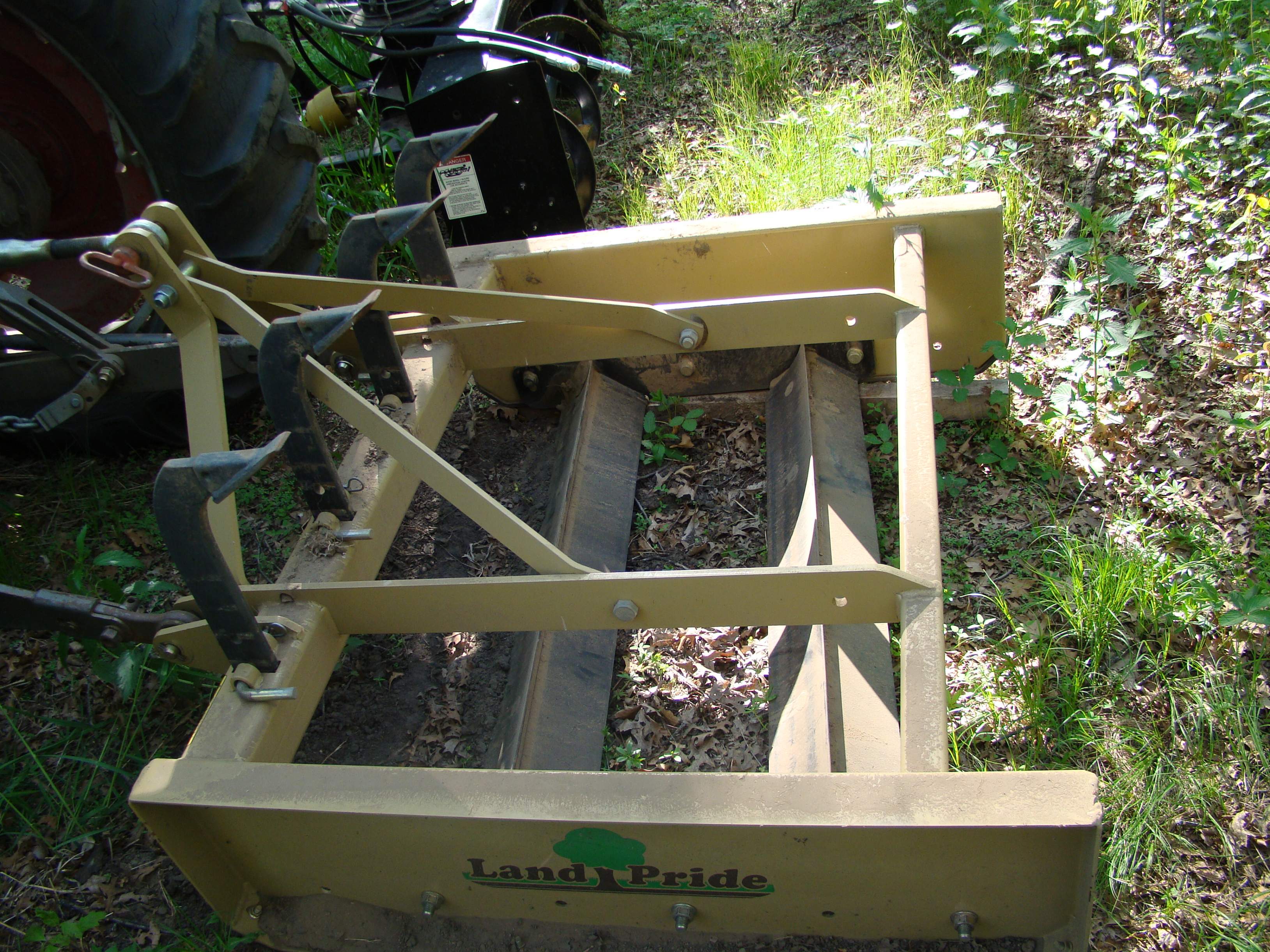

I'm about ready to purchase one of the Land Pride grading scrapers but am as yet not completely decided whether it will be the GS1548 or GS1560 model. My tractor is a Massey GC2600, 25HP, 4WD, with 3pt lifting capacity of 1191 lbs at the ball ends. I've been using a 5 foot boxblade with 4 scarifiers to maintain two drives/roads without any issues to speak of.
I'd prefer to have the gs1560 to extend past the tire width and for the extra 74 pounds to aid the rippers digging into the hard packed gravel which experience with the the boxblade would indicate that is a benefit.
Here's a quick summary of present members who've purchased the graders and their tractors to aid my decision.
Newtattobob, BX1850, GS1548. No problems
Tom H BX2200, GS1548. No Problems "more than enough power"
RPRaymond BX2200, GS1548. No problems.
Granite Tractor, B-3030, GS1560. No problems.
PSdx B-3030, GS1560. No problems "just fine in 2WD".
BlacknTan B-7800, GS1560. No problems.
Mlevendo MF180, GS1548.
So despite common misgivings about power and traction issues using this type of grader with any given tractor there has yet to be anyone who's felt this implement has has proved too big/heavy. That info combined with my own experience using a 5 foot box with no issues has me thinking the GS1560 should not pose any sort of problem with my GC2600 tractor. Is there anyone here who has information that the 5 foot grader may prove too large for my tractor?

I have the 48". Once or twice I have snagged, had to back up, and start again. I think the bigger model would be a stretch for my 22hp Kubota BX. I run with Ag tires. I don't know anything about your Massey. Do you have hydro tranny or straight gears? Which type tires do you have and what's their diameter. If you run hydro, is it 2 range or 3? If straight gears, do you have an extra low pulling gear? Can you ballast the rear of the tractor (not the scraper, but the rear of the tractor itself)? What does your tractor weigh?
If you have straight gears with X-low pulling gear, ag tires, and ballast for rear of tractor, you're fine. If you have 2 range hydro, turf tires, no ballast, I would worry. Can you give some details?
The Massey appears similar to the BX2200 with a few more horsepower. Hydro two speed, loaded turf tires rear/front 26/18. Outfitted with front loader and operator total weight in the 2200 pound range.
Using my 5 foot boxblade as a guide which differential lock and 4WD could manage in all road conditions coupled with a quote from someone in this thread saying that the the drag from the grader is less than his same sized boxblade I feel reasonably confident the 5 foot scraper would be fine but, and that's a big but, ....:) Speaking with the dealer today he doesn't seem to think the larger model would not pose a problem for the GC2600 but it's purely conjecture.
Tom, curious what conditions hung you up? Scarifiers down/up? Wet/dry? Snaggin large rocks or other?
Thanks.

Jay,
It was bigger rocks down in the roadbed (pit run) that snagged the ripper. If you are able to run a 5' BB, then a 5' grading scraper should not be a problem. Your turf tires won't get the bite ag tires would but having them loaded helps overcome that.
You may well be o.k. I don't feel qualified to promise you that you will, however. Maybe someone else can chime in here.
Good luck regardless of what you decide.
Tom

Thanks for the info Tom. I'll pose the question another way, any here with the GS1548 and a sub-compact tractor wishes they had gone bigger? My biggest worry is weight on the rippers to ensure they break the surface without too many passes but I'd also like the unit to extend past my tires. Interestingly, when not using the rippers the 48" inch model actually provides more pounds per linear inch of blade on the ground therefore should dig a little better than the 60" model in that scenario.

That make sense, plus for many apps the boxblade is essentially dragging material across the ground whereas the grader blades are digging. When the scarifiers of the boxblade are digging in past 3 inches or so is the time I'm most inclined to lose traction. On hard packed gravel (in addition to making many assumptions) if a large portion of even one grader blade were biting in at only 1/2 inch that potentially is far more surface area therefore drag than 4 scarifiers at 3 inches.
I spoke to another dealer this morning to pick his brains and they feel the 48" would be the ideal unit.

Well after calling Land Pride directly today the plot thickens somewhat and it becomes clear the only to definitively answer my 60" question is to buy one and risk being under tractor-ed. After speaking with Land Pride and discussing my tractor and usage they feel the 60" would work. The reasoning being that the tractor can easily lift the attachment and unless I'm scraping clayish type material I should have enough power/traction. This info coupled with info gained here from actual users has me at odds though, perhaps a flip of a coin is in order.
/ Land Pride grading scraper #113
The 60" unit may work for you, sort of depends on your circumstances and would be great if it did indeed work. Get the 48" unit and your sure that you have a unit that will work for you. Unfortunately without actually using one at your place, it would be a gamble to get the 60" unit. :(

Agreed, but I'm stuck on the 5' width due to this being the size of the boxblade I've been using to grade two roads and though only a small difference in size not only will the 48" require more passes the extra width theoretically should provide smoother more consistent transition side to side. Perhaps I can negotiate an out with the dealer on the chance I need the smaller one. I also have to admit that after watching the youtube video of the GS1548 bouncing around behind the Kubota sub-compact I'm convinced a heavy unit is needed.

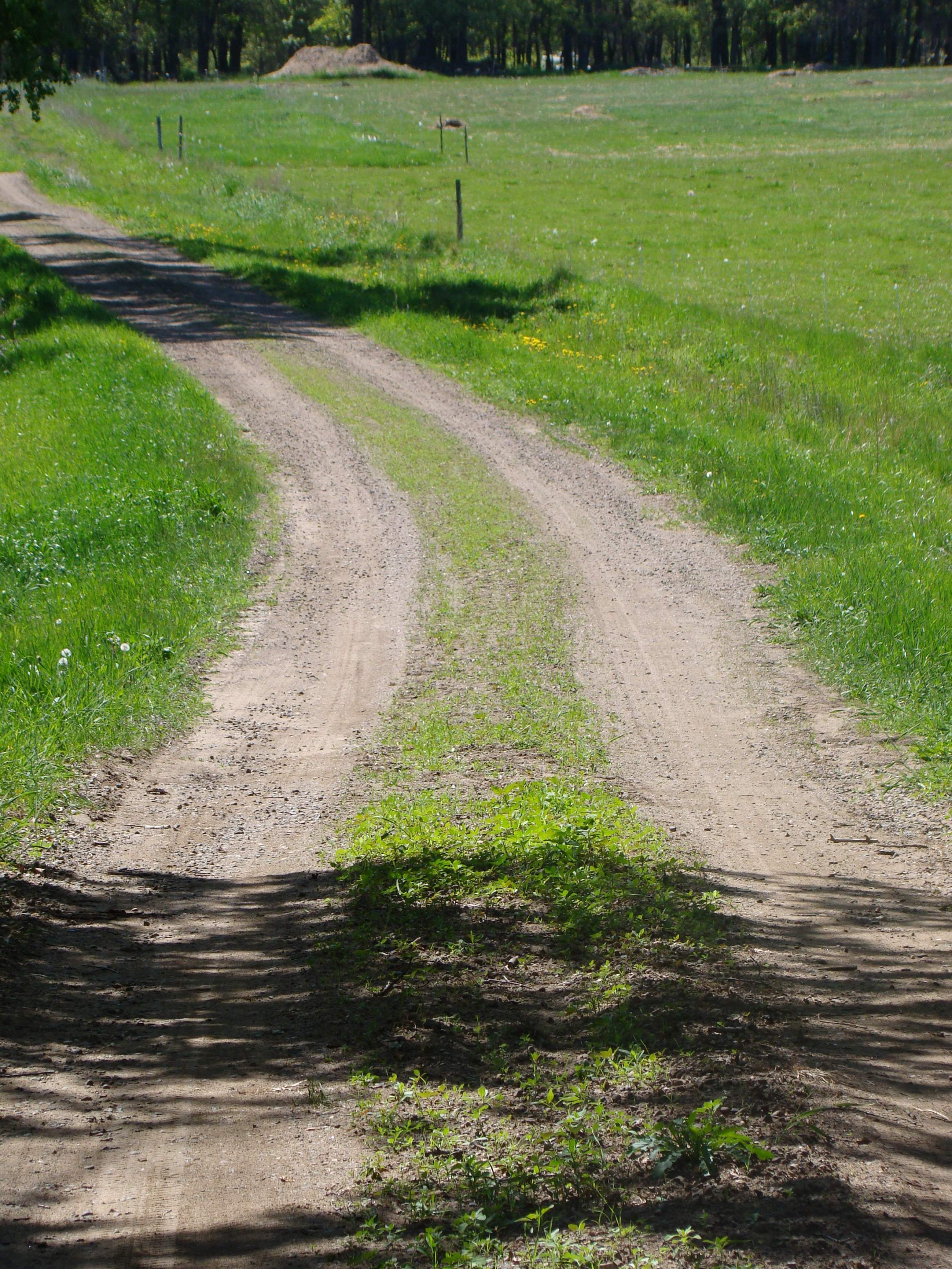

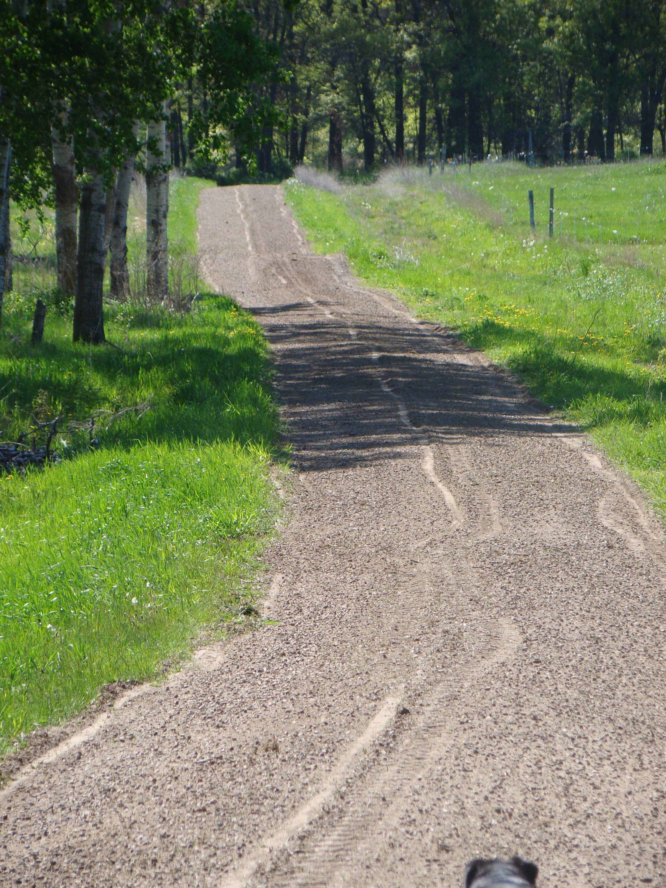

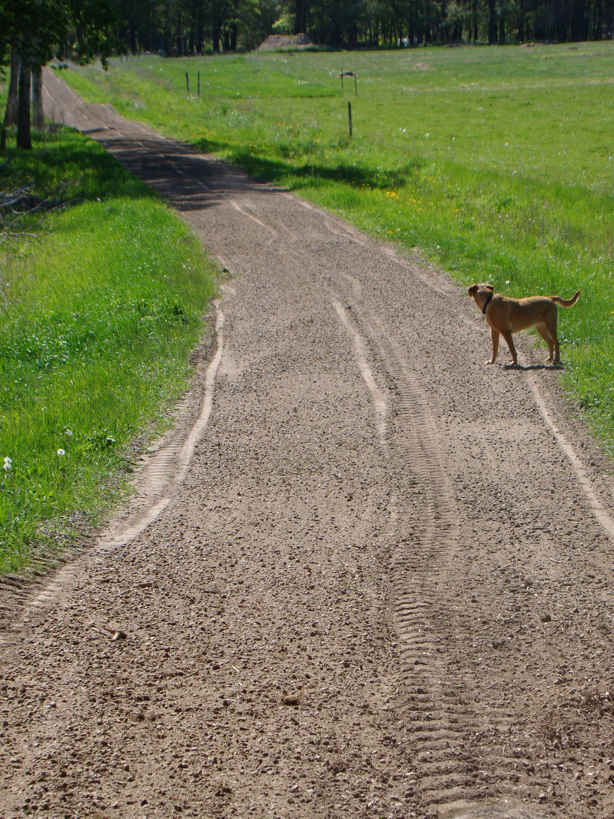

Here's my 5 footer, if the ground is right, it will stop my 5000lb tractor.
I've been reading many of your posts on the topic and have attached a high weighting to them. Man that 5 footer looks huge. I wonder how the sandy roads, it appears you work on, effect the grader size to traction ratio.
/ Land Pride grading scraper #119
My roads are mainly DG. (decomposed granite) During the summer when they are rock hard, is the only time that the grader noticeably works how they are said to work, where you can see the material moving sideways along the blades. When the ground has about any moisture in it, the blades cut enough the the majority of the material is cut and flows up and over the blades. I'm sure that some moves sideways, but there is so much being cut that it is not noticeable to just look at it flowing backwards. If you have noticed in some of my pictures, the ground will actually build up in the box to where it will get on the cross members. On my 5 footer that is 18" and on my 7 footer that is 22". When there is that much dirt in the box, there is a LOT of dirt being moved and often the box will have to be lifted a few inches to allow for more material to flow out. It just happens that when the ground is in those damp conditions is the best time to grade the road. The ground repacks very well vs grading when the ground is bone dry and hard.
I would think that in my conditions when I grade, (usually damp) that I would have the best traction available. Can't say 100% about other conditions because I have only used the grader at my place. And yes my graders are a bit bigger than most of the ones that you see here on TBN or what most dealers have.

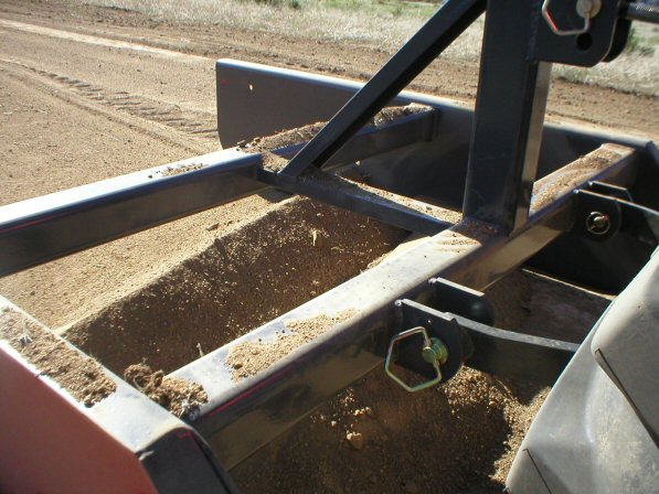

I have the Landpride GS1560. I can pull it with my B2630 (26hp) until it loads up with damp material, this is with the teeth up, then it loses traction and won't pull any further. I have found that the GS1560 works behind my L4610 (50hp) tractor just fine. The GS1560 is going to be too much for your Massey, if you don't have a larger tractor to hook it up to, go with the 48".
