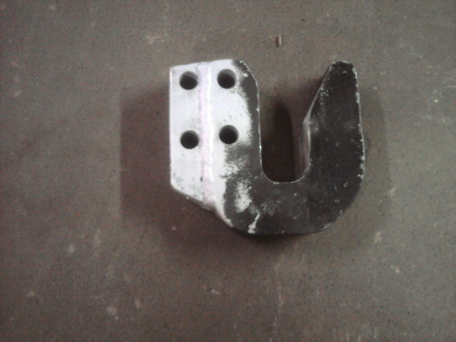

My HF quick hitch has a top link hook about 1 1/4 inches and the bottom hooks are about 1 1/2 inches
   / Land Pride Quick Hitch #120
FYI
Yea the only thing I have found on the HF QH that needed attention was the top hook. It needed extended so that it would reach the top pin (bolt, sleeve) so I did this
That isn't mine that is someone else's but mine looked just the same of course I didn't take a picture.
