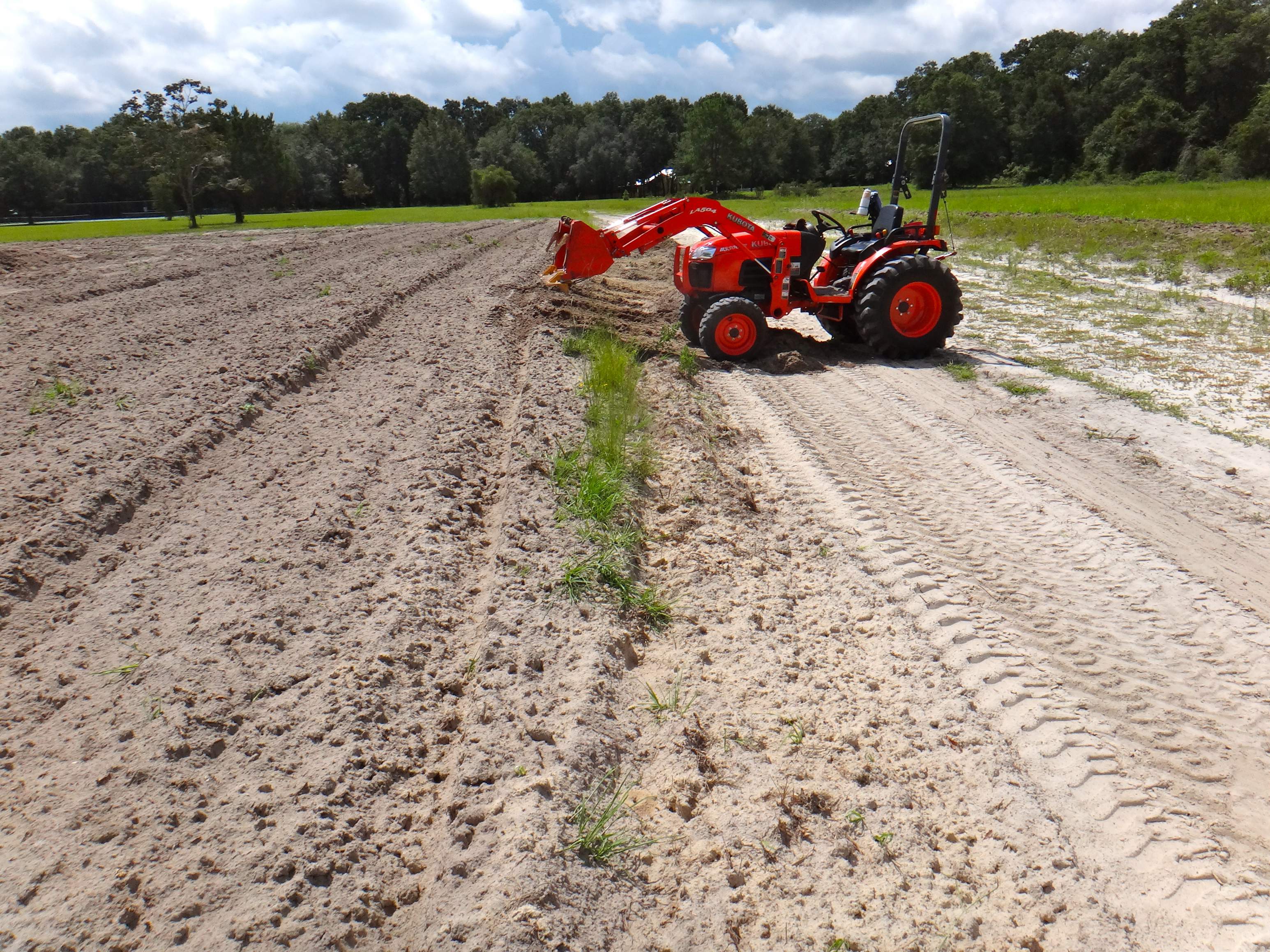

I have an ETA Landscape Rake and a Ratchet Rake bucket attachment. The Ratchet Rake is so much more versatile, the Landscape Rake mostly sits. The Ratchet Rake is far better at corralling leaves and yard debris and moving piled debris short distances. The Ratchet Rake also grades pretty well, if you are not in a hurry,
I use the Landscape Rake on a 45 degree angle grading rutted dirt roads at a faster clip.

I like that look of that Ratchet Rake! The straps don't get in the way?

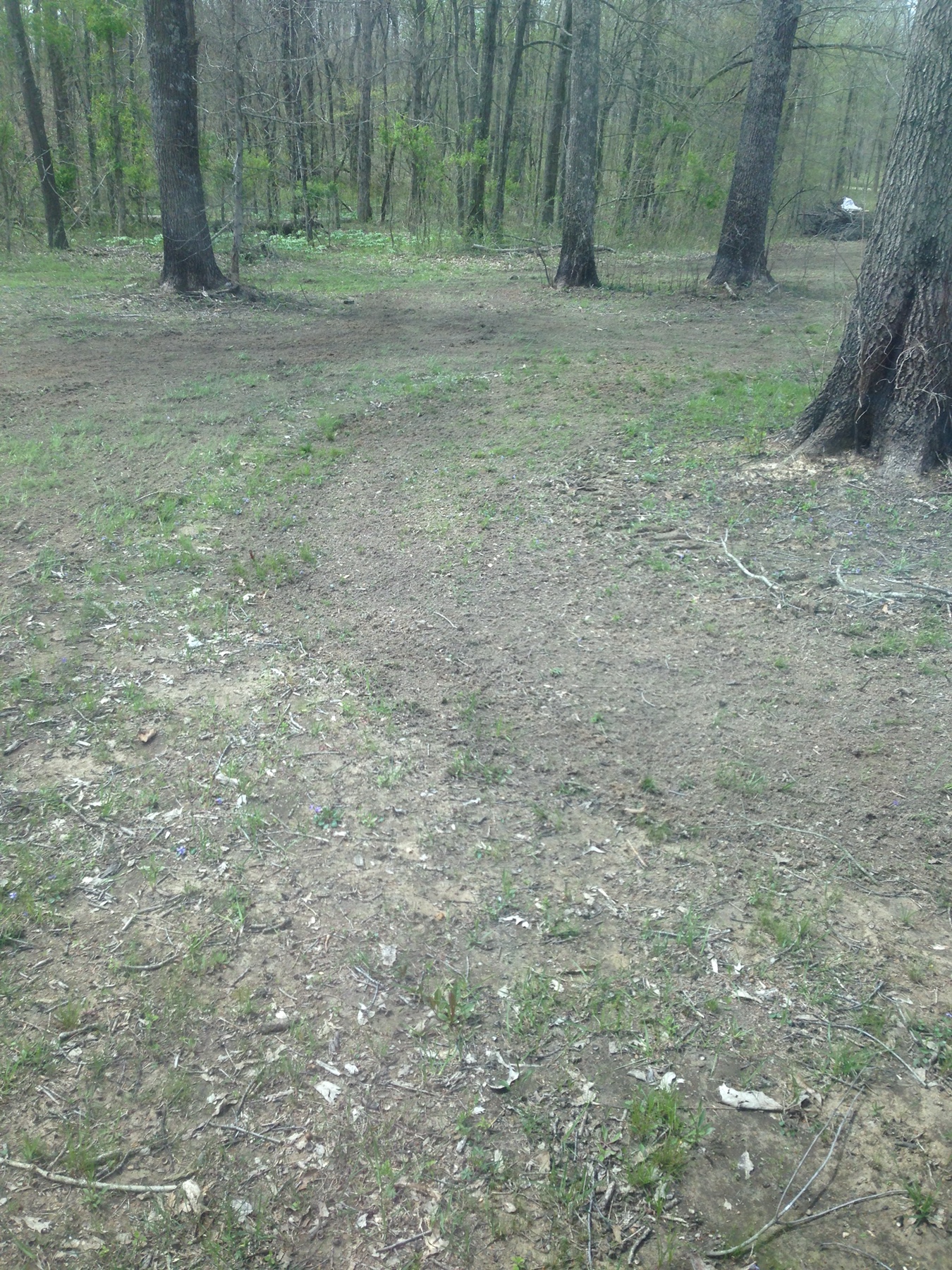

I have the same issue and bought a big landscape rake. It succeeded in tearing up the lawn, and not moving a single branch or stick.
Bought a pine needle rake and it works much better. Not great, but better. It will work good in the spring, in a dry spell and will also do a fair amount of thatching as well.

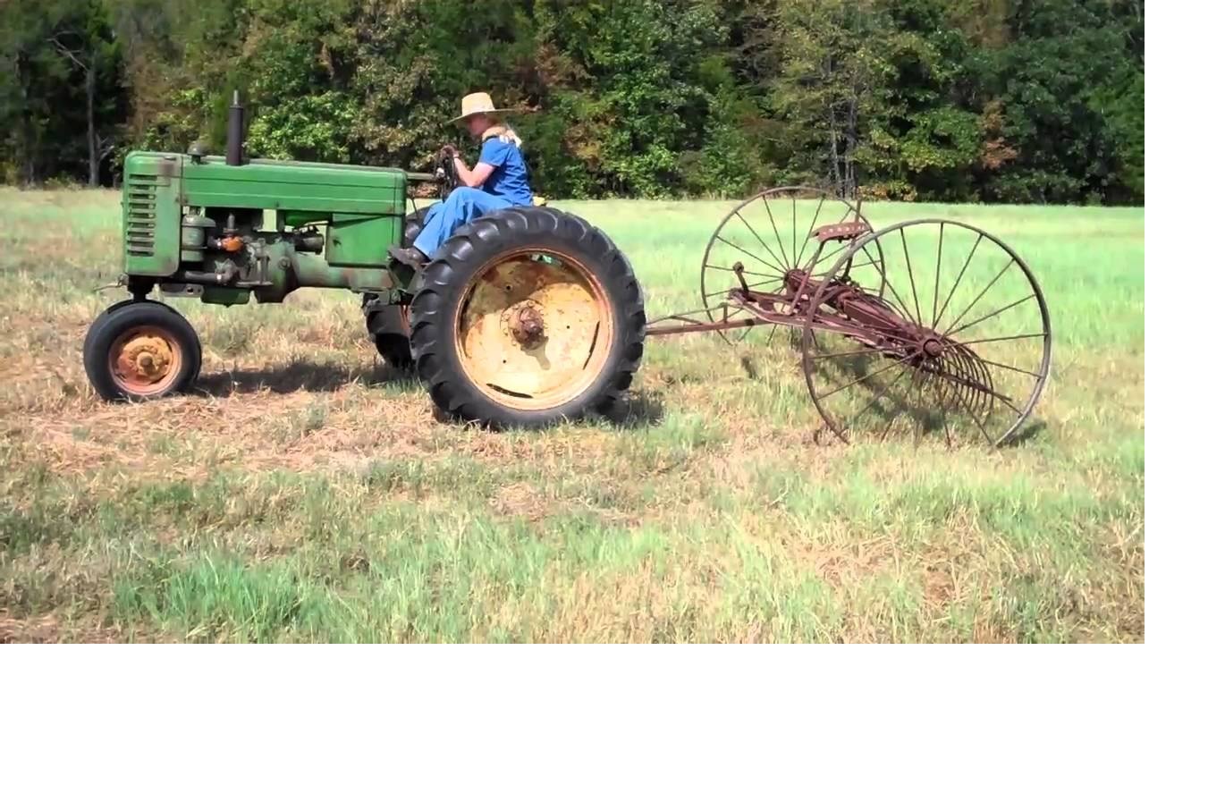

The old dump hay rake would work really well for small limbs.
They do not tear up the ground like the landscape rake.
As a kid back in the 60's (about 10-12 years old) I use to ride on the seat of a dump rake in hay fields and would operate the dump feature
with a foot pedal mechanism while my dad drove the tractor.
I used one a few years ago and operated the dump mechanism with a length of rope, as I drove the tractor.
They do amazingly well raking up lengths of hay, straw, limbs and even leaves to some degree.
Around here you can still find them for $100-$200, if they haven't been painted up fancy for lawn ornamates.

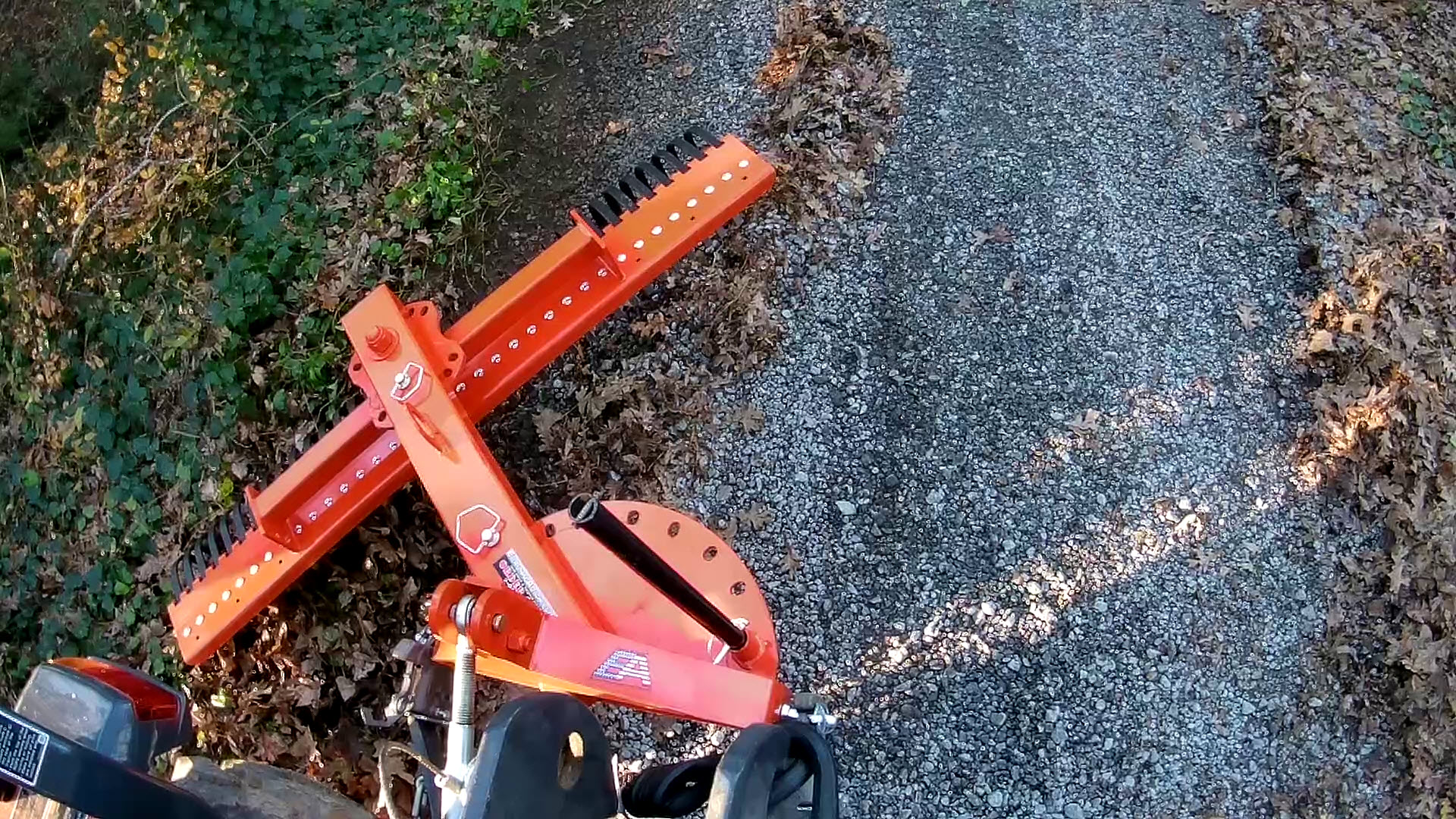

I think it would. I recently bought a Land Shark LS-CMP-LR-72 Landscape Rake, which is 6' long. It's actually made by Everything Attachments, but comes in Orange. It's not cheap but it's built like a tank and well worth it. The most important feature I was looking for was an offest option where the support arm pivots at the 3 point so that the rake can be swung out to the side past the tires. I've attached a few pics. I believe you'd find many other uses for it as well. If you want to avoid tearing up the grass, then consider getting gauge wheels for it.
