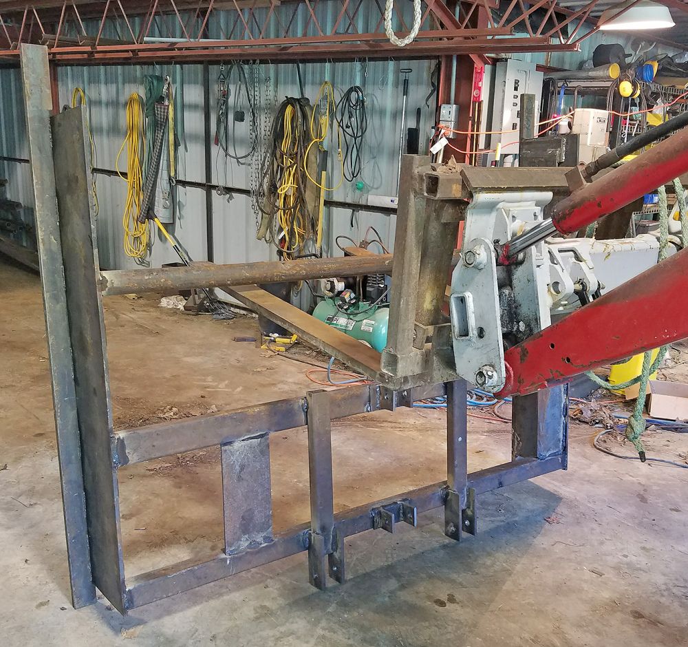

Today, I welded the two side assemblies. Both left and right are identical.
Since the movable mounting plates are offset,
the the offset will cause the left front of the blade to be 22" back further than the right.
If my TRIG still works,, the grader blade will be at about a 15 degree angle,,
(84.5" wide,, 22" offset, is that ~15 degrees?)
The had two materials I had for runners was 1/2" X 6" and 1" X 3". I went with the 1X3.
I figured there may be a time I will need the runners to "dig in", that would never happen with 6 inch wide runners.
The hope is that I will be able to move the two guillotine like plates up or down to adjust the grader blade height.
I say "HOPE", because it may be tricky welding the assembly together accurately enough that the plates do not bind.
The adjustment range will allow the blades to be positioned from one inch above the runners,
to several inches below the runners. Would I EVER want the blades to be higher than 1" above the runners?? :confused:
My initial setting will have the blades even with the runners.
That seems to be typical of others land planes.
Next, I will weld in the three 84.5" tubes that space the sides apart.

Last second design change,,,
I decided to add a bit of angle adjust-ability to the top link connection.
I can use the mechanical link shown, or a hydraulic cylinder,,,
I am trying to get all the welding done on the frame before I add the grader blades.
Hopefully, I will not have any distortion later that would inhibit the up and down movement of the grader blades.
