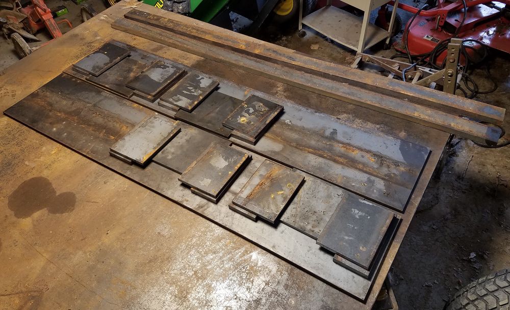

I figured out how I wanted to mount the front blade, then found and cut the steel.
Next, there was a LOT of hole drilling,,, I have a pretty good size Amazon box full of drill chips :D
The front blade assembly is ready to weld into the frame,,,
This blade assembly is 13 inches wide,,, there may not be a need for a second blade.
I will have the frame ready for a second blade,,,but,,
I will definitely try the land plane with just one blade before adding the second.
The blade assembly is massive,, the assembly in the pic weighs over 300 pounds.
I would bet there are complete land planes on the market that only weigh 300 pounds total.
The strength of this assembly is also incredible.
I have no concern that the assembly will easily stop my 60 HP tractor.
The blades, are not only very thick tool steel, but, they are heat treated, also.
If you hit the blade with a hammer, they ring like a bell.
If I do not use all of the blades in the land plane,,,
I think I will cut up the remainder and make the loudest wind chime,,, EVER!!:laughing:

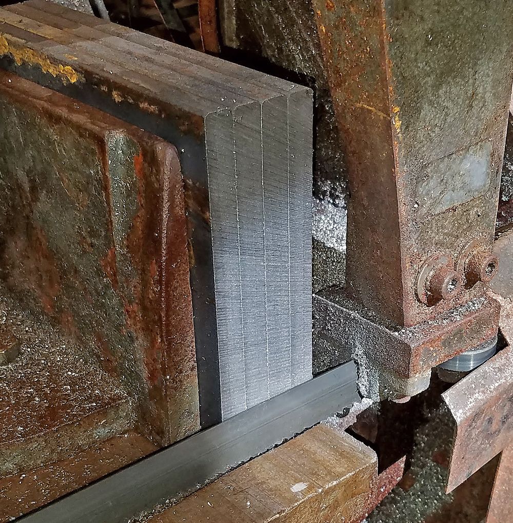

I was drilling the holes for the 3 point hitch attachment (one inch,, I could not find the 7/8" bit :laughing: )
and I took a pic.
I thought some of you might be wondering why I have a clamp permanently bolted to my drill press vise.
The clamp applies down pressure on the parts, when I am drilling multiple parts at one time.
Hot rolled steel varies enough in width, that the vise can not hold all the parts firmly.
The clamp insures that one or more of the parts do not start walking around.
The vise is a "self centering" type. That makes setup easier when you are drilling a bunch of holes in the center of a group of parts.
The drill will stay at the center of a part, whether it is 2, 3, 4, 6, etc inches wide,
both the front and rear vise jaws move as the handle is rotated.
/ LandPlane,, My DIY #39
Drop a strip of cardboard or wood between the moving jaw and parts. They will still be consistently spaced by the rear jaw and the strip will compress with the long ones and hold the shorter ones.
You can also run into the same issue in your saw. You can clamp them all together or if you have a welder handy tack the "drop" ends together so they don't move realitive to one another as they are fed.
