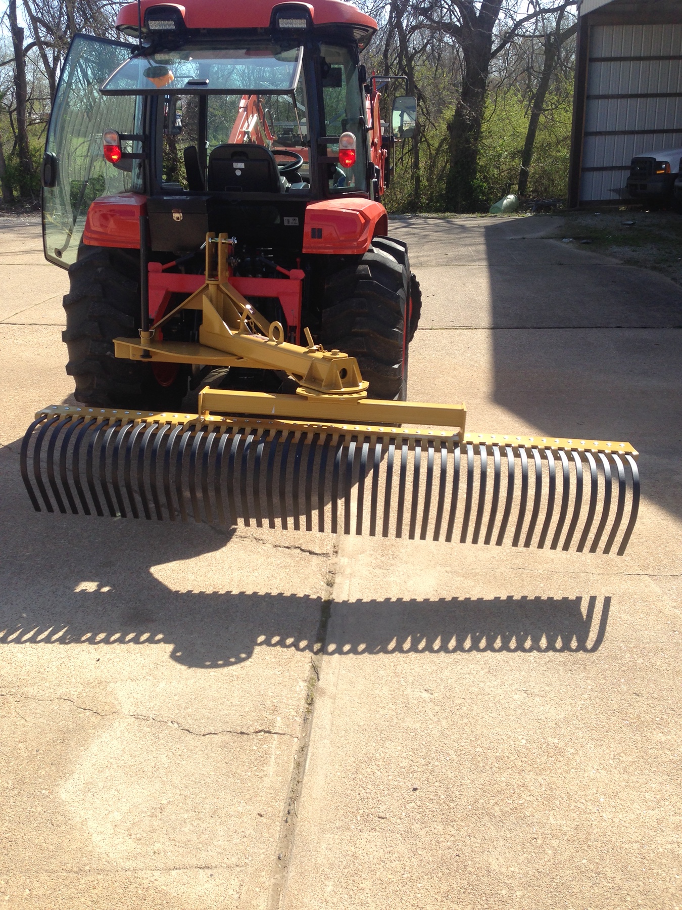

Hey Code - you spin it backwards then drive fwd? If so, what does that do, just fine smooth it?
Not Code, but it smooths things out nicely with out collecting a bunch of material. Sort of poor pictures,:ashamed: but you can get an idea. ;)

Yep - Just did the drive an hour or so ago. I spin it backwards and angle it so it sort of pulls the extra gravel off the sides and towards the middle. Then set it straight across but backwards and run down the middle a pass or two and it sort of spreads it the width of the driveway and a nice even manner. More than once the other neighbors stopped and asked me what they own for gravel since I got it for the road. Love to tell them nothing, just ran the rake over it......
