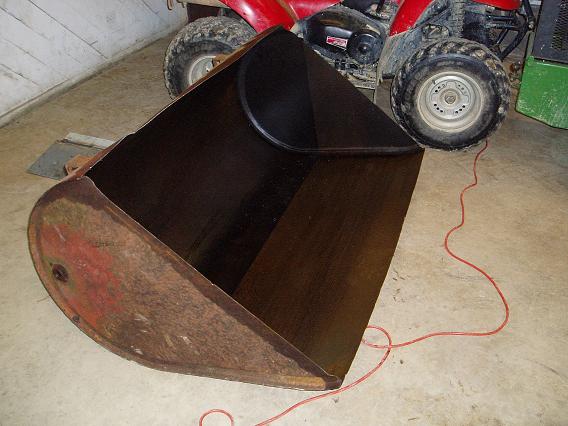

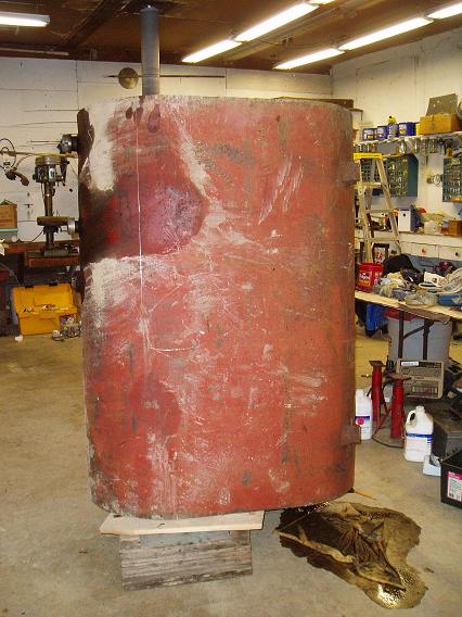

Can you see the bucket in this picture?
/ Large Bucket Container.
#30
If not can you see the bucket in this one? I will have some more pics later as I work on this project. Thanks for the ideas guys.
