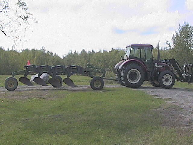

I had the same decision tree starting back in '02. Ended up with this machine in photo. 55 pto hp and 10K lbs of ground pounding workability.
www.zetor.com
The madness to my method was to buy one new tractor as the critical path & everything else was already here or used at auction. Existing attachments are sized to a JD A ~ 38 pto so did not need to go much bigger.
A cab AC takes about 10 hp. First time bush hogging in a ac cab - no bugs, dirt, etc, no need to go back /forums/images/graemlins/grin.gif A cab option is a factory passenger seat & seatbelt for those city visitors you want to keep track of. Initially bought for my brothers little kids, turns out retiree's want to go with as well /forums/images/graemlins/confused.gif The heat makes snow plowing @ -20 fun /forums/images/graemlins/crazy.gif
Engaged MFWD imitates 4 wheel braking on hills pulling a load - a safety benefit. Most of the attachments I've added (read cheap) either are or can get fairly heavy. 4x18 plow, dump wagon, rock picker, etc.
I use a cat 0 lawnmower with a 6' landscape rake & box blade for road fixing & yard work. Much smaller & faster able to go up & down, side to side, smoothing stuff /forums/images/graemlins/cool.gif
It's been here almost 2 years & have not needed to add anything to the original tractor config: quik tach loader, 84" bucket, 66" rock bucket with dual grapples, forks, rear wheel weights (not loaded), 2nd seat.
My tractor 3pt lifts far more than a JD 5420 (one early task was to position a shipping container) and cost $20K less which kind of tipped the decision.
Happy deciding /forums/images/graemlins/smirk.gif
