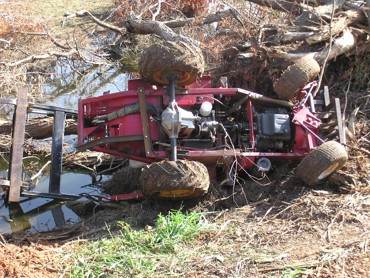

NICE pictures all around. But what's next? Another, "I broke my front axle thread"?

It's all fun and games til someone looses an axle!

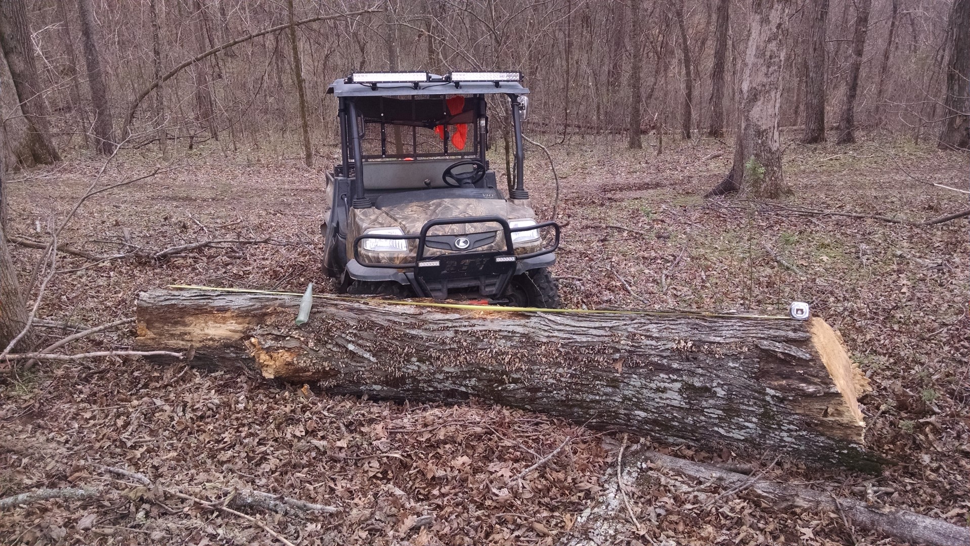

I know what my M6040 and grapple will lift because ONCE I lifted a large chunk of my virgin, freshly cut pine. Life is too short and repairs simply to costly to justify any "super lifting". I have developed a "log weight" chart and will keep any heavy lifting to less than 60% of max at all times.
Keep it low, go slow and live to see another day. Both life wise and financially.

I was of the understanding that if the hydraulics would lift it, it wasn't too heavy for the machine and wouldn't do any damage.
Until, during transport, a wheel drops into a hole, increasing the FEL load by 40%. The FEL can bend or your axle or wheel can bend, break or roll under. Pressure surge can blow a hydraulic line.
   / Largest load I'll ever pick up with my Grapple (pics!)
#28
Until a wheel drops into a hole, increasing the FEL load by 40% for long enough for something to bend or break. The FEL can bend or your axle or wheel can bend, break or roll under.
And this is why I didn't take it very far, went very very slowly and stayed on the (relatively) straight and level driveway vs. cross country. Fortunately, where I wanted to put it wasn't very far either.
And the reason I wanted to do it in the first place, as opposed to simply cutting it in half, was to see how the tractor reacted to a load that heavy in case I ever had to do it for real or an occasion I had no choice but to lift and go. Seemed like a fairly low risk experiment under the circumstances.
I still need to get out there and measure it to get a better idea how much it weighed.

Xfaxman: You're putting an awful lot of trust in those hydraulics to keep you alive. Not going to lecture you because you're a big boy and can make your own decisions, I'm just saying I wouldn't do it.

I appreciate your concern, I have gone under the raised arms a lot in the 12 years since I put it together. I always thought if a hose burst I would have time to get clear, but maybe not. :eek:
All but the curl cylinder hoses were new back then. Guess I need to inspect them now to see if they are showing signs of deterioration.
Thanks
