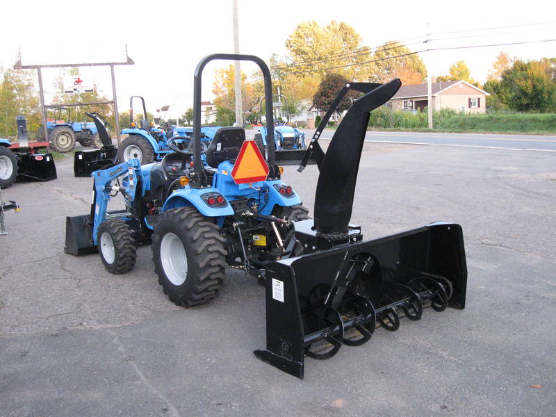

Do you think the BX can handle a 62" blower? In your first post you suggested not going above 50. A 62 and a powerpack sure isnt going to be a cheap setup unless your getting a significant discount ;)
I looked at the shulte brochure and i see what you mean. It does look heavier than whats typical around here. There are no Shulte dealers that i know of in my province however.
A dealer 200 mi away started carrying a "made in canada" blower but they dont mention the brand. If i was to guess id say its JWC, but i thought they went out of business. Im not crazy on the design. It has a flat area behind the auger and i prefer a curved area. These are cheap blowers, starting at around $1950 for a 48" IIRC. See attached image.
I have a Honda 928 blower so i know the importance of good design. That thing throws a mile. And never clogs. Thats a good design and what i want in a tractor mount if i go that way.
