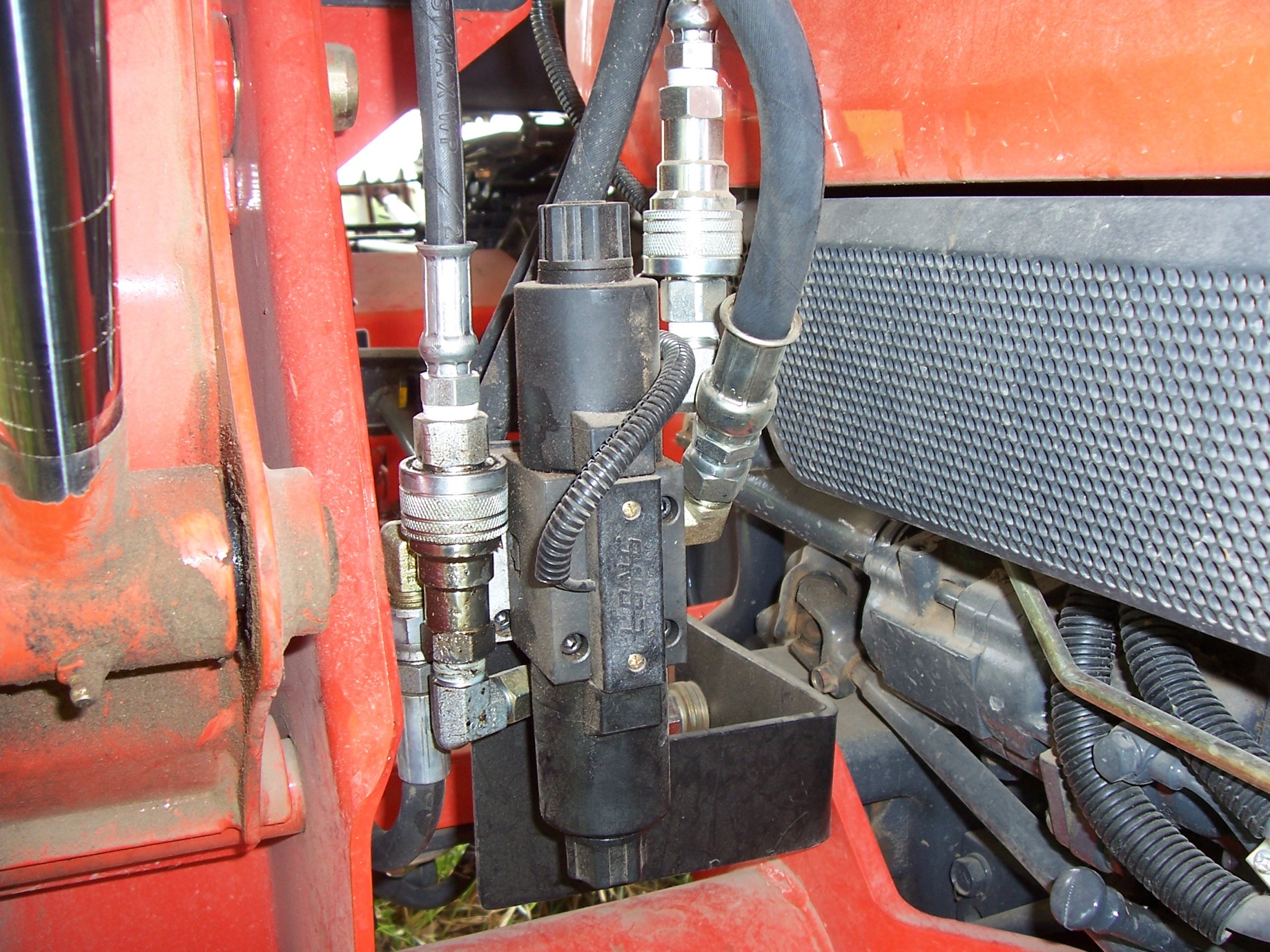

I guess I gotta ask, Are you sure it's the threads leaking? I received some bad QC's on my grapple that leaked and were replaced by the seller because they had gotten a bad batch from the manufacturer.
Quite certain, I can actually watch it seep out.

I use them often so will have to tackle this. I have attached a picture from the day I installed the rear remotes so you know what I am talking about.
See this thread for the details of the addition of the remote.
http://www.tractorbynet.com/forums/tym-owning-operating/124652-rear-remote-options-t273.html
