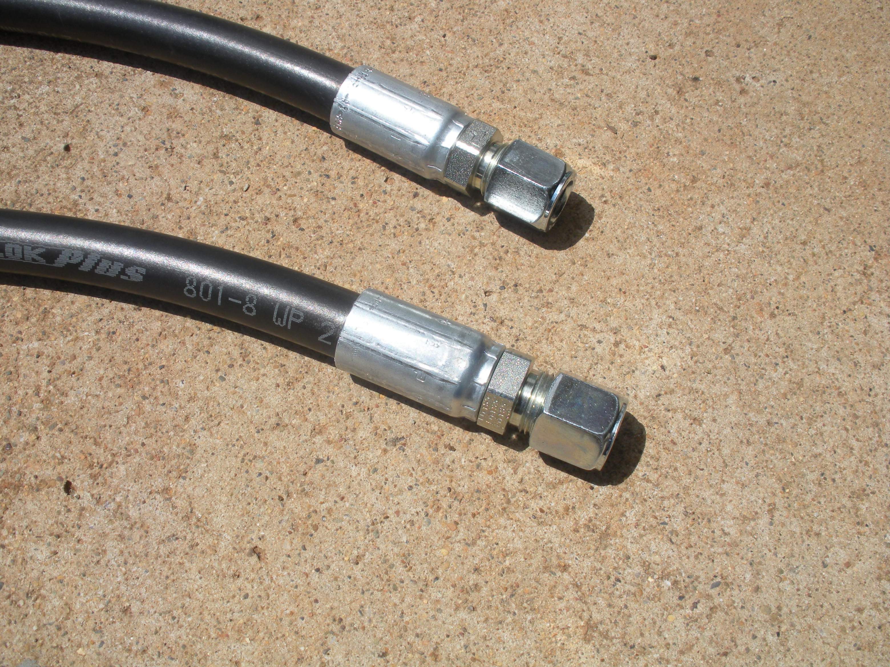

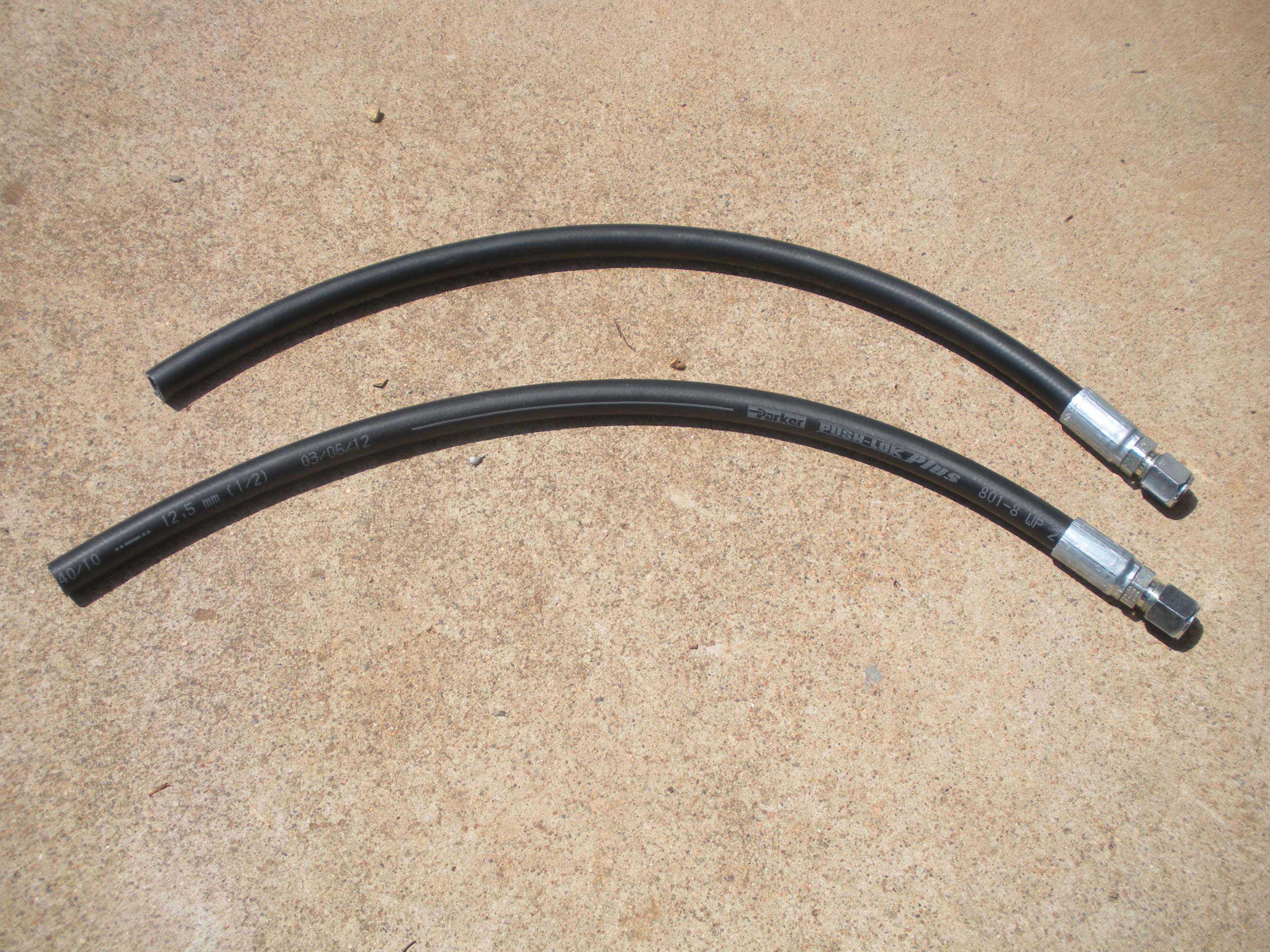

After checking a couple local parts stores for compression and barb fittings, I went to a parts place that does everything from car stuff, to big rigs and tractors.
I had them make up a set of hoses with a compression fitting at one end.
I've run it in the driveway, topped off with fluid, and run thru the gears; no leaks. DSCN1386.jpgDSCN1387.jpg

looks good.
I think my stuff was parker too. would have to check tho...
buddy of mine made em for me. sure did save some work / time
