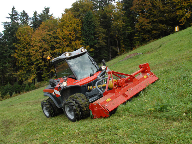

Aebi Tractors are the most stable on earth
I agree completely. The AEBI is THE machine if one is serious about mowing steep ground -- I mean seriously steep. The ones I saw in Europe (and at farm shows here) have the engine (A Kubota engine I think) beside the driver rather than in front of him. Very low CG. And I think they have PTO and 3pt both in front and in back. They are also expensive as all H. I'd love to have one but can't justify the cost & few people can.
/ Least Tippy Machine #27
Good Lord - they are VERY expensive. Interesting, informative web site.

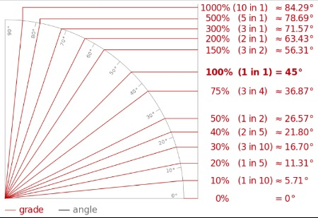

Fifth: Someone above said he is comfy on slopes 20 deg steeper than his wife? To clarify (look at the red chart above) a 20 degree slope is roughly 40% which is a fairly steep one to begin with so his wife must have been on the flat only ??
Yep anything but flat ground is "pretty scary" for the wife. She can't tolerate much slope at all.
/ Least Tippy Machine #32
My experience is 99 percent of people will overestimate the angle of a hill by double what it actually is.
/ Least Tippy Machine #33
I wouldn't doubt that for a moment.
