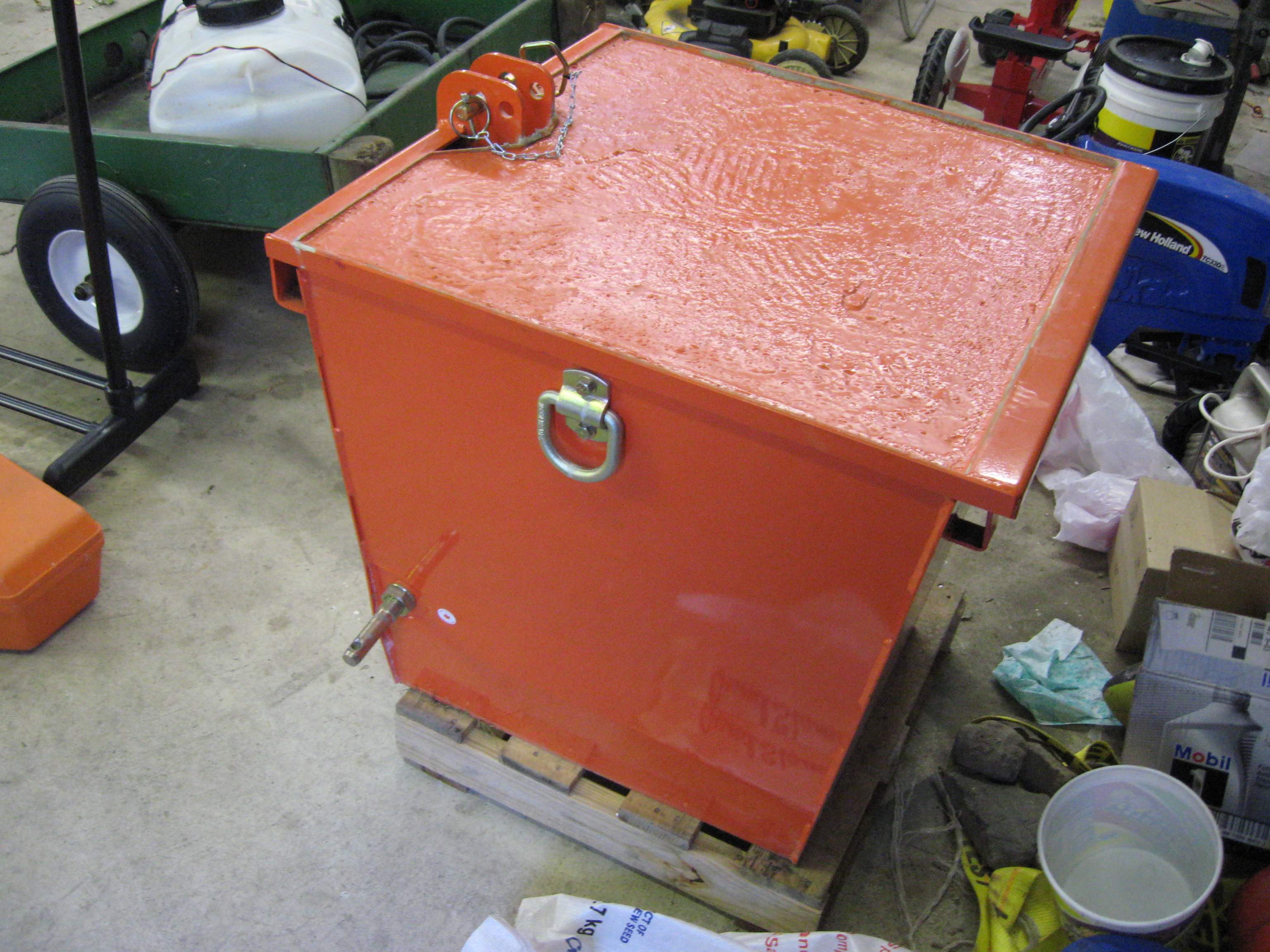

Greetings from N.H., so far you all have answered my questions, i have another....I just purchased a ballast box for my 06', L-4330 tractor. This rig is just used for snow removal, it is stored inside etc. When i have my ballast box loaded, and raised and locked, can i always leave it in the "RAISED" POSITION? or will this hurt the tractor and hydrulics always being up? weight will be about 600lbs, one local said it wont hurt at all.
I would rather hear it from you pros, no other attachments for this rig etc.

I don't think you have to, but I would. Take the strain off the mechanical and hydrailic components. Eventually, it will leak down, and that way you will know where it will settle. I have young kids around that are always playing on my tractors, so I always lower my FEL and rear implements to be safe. I don't want to see a young one crushed by a ballest box or other implement when one is playing on tractor and another is around. I can't tell you how many times I've cussed because as soon as I started tractor it went immediatly to full throttle! They know how to make it go fast. Philip.

I think I have to agree with the previous post. I always lower any implement just as a matter of principal and that being it cannot lower unexpectedly if it is already on the ground. I doubt it will hurt anything to stay raised but I must ask "why"?:D

I also leave my ballast box on all winter (in a garage) and it's lowered. For me, mostly a safety issue. That's a lot of weight to drop if something broke or the rockshaft lever was inadvertently moved.
BTW, I always lower it on a couple pieces of 2x4. A little airspace under the box might reduce rust.

Pretty much in agreement with everyone else, it won't hurt anything. I grew up farming and out of habit lower all equipment when I park.
I also admit that while my manuals say to lock in the raised position, I never have.

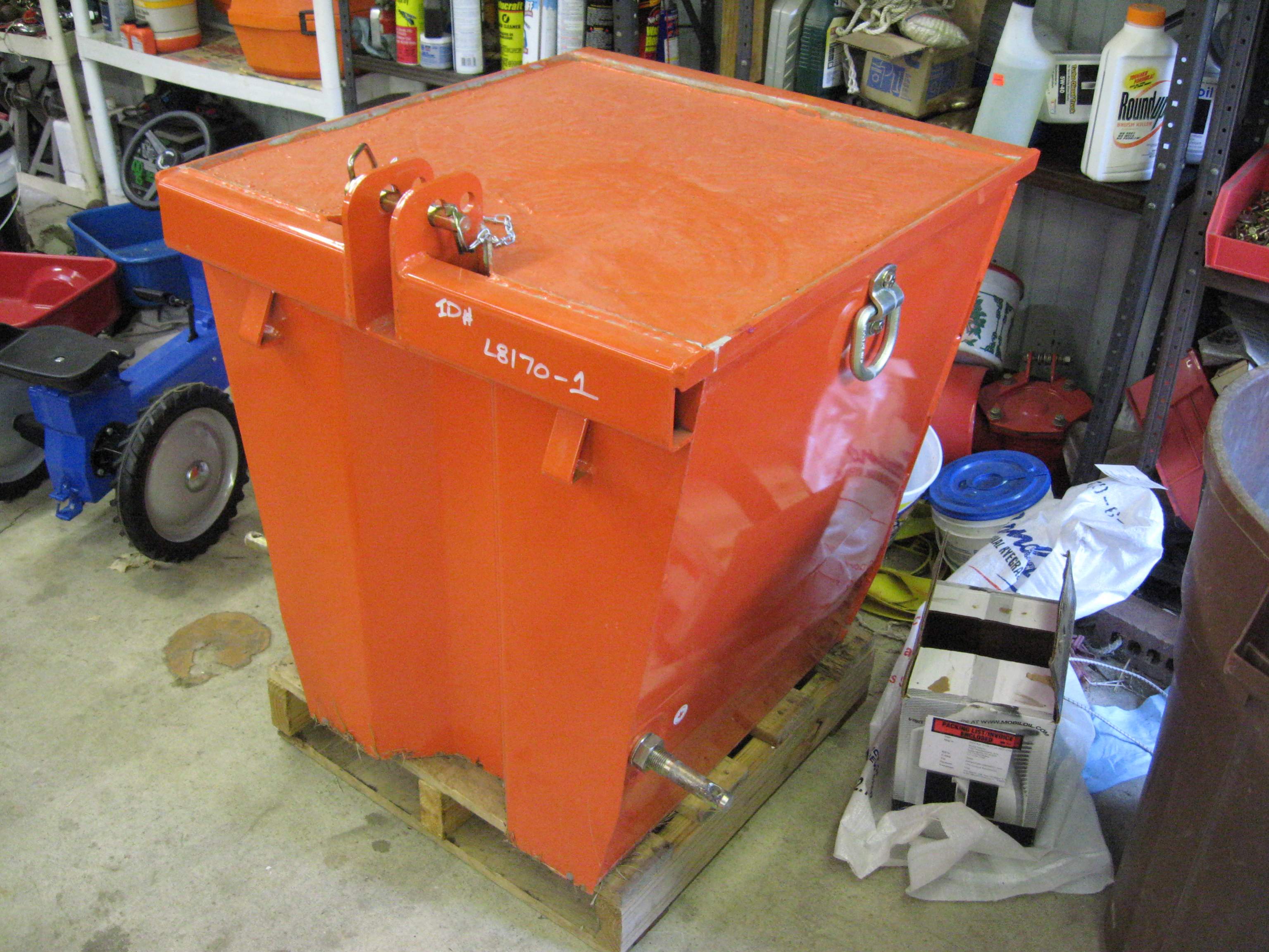

I purchased mine from the Kubota dealer. You can see in my signature that it is an L8170. Philip.
