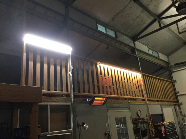

This is a really good price but, I think that the 4100 K color temperature will be a bit too "yellow" for shop lights?
Any feedback from someone who installed some of them?
Light on left is Sam's Club which is 5000K and light on left is 3000K.
Big difference?

Nope! I put Costco 6 qty of 4ft fixtures (2 bulbs each) with 4100K in my garage/shop and they are a nice clean white. Not yellow at all.
/ LED Garage Lights #131
How about a comparison picture?
/ LED Garage Lights #132
I already posted earlier in this or another LED thread. But here you go! No question, much brighter visually and I measured and posted the lumen output and big difference also.
