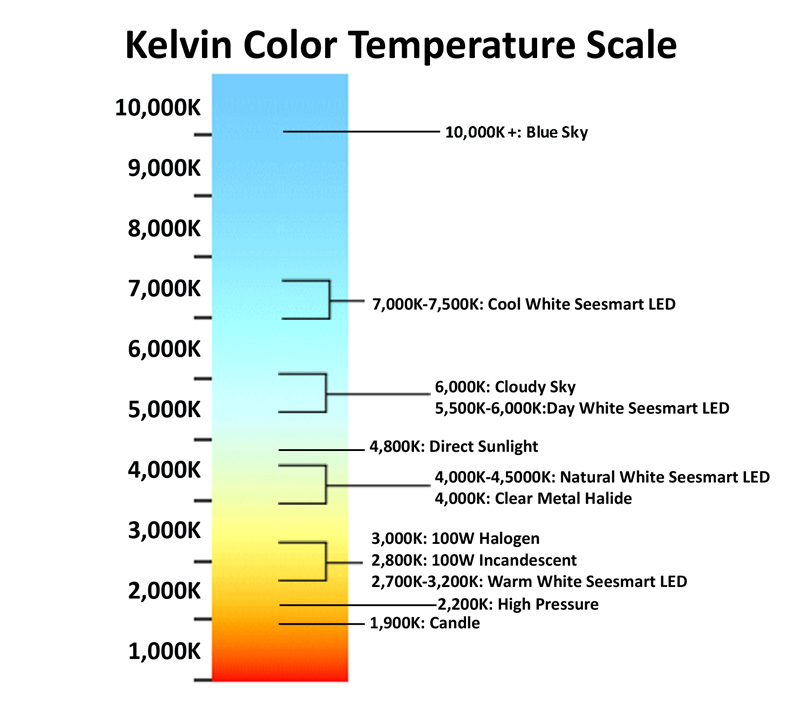

The higher the Kelvin color temperature numbers, the "whiter" the light. 4000 K would be a warm white while 5000 K would be a brighter white. See below.

So in my case probably should stay away from the 5000K "brighter" light and use 4000K "warm white". For hanging fluorescent replacement lights in a garage...some over work bench and other for ceiling lighting...anyone use the 3000K range which appears to be close to incandescent color?? Is the 4000 K better to "work under"??
Thanks...chart very helpful...TMR

I think the 5000k are about as close to natural outdoor light you can get. Anything over that, and there is a definate blue hue coming from the bulb. Lights mounted up higher I dont think it would be as big of a deal, but working directly under a bulb that is in close proximity, 5000k=perfect IMO.

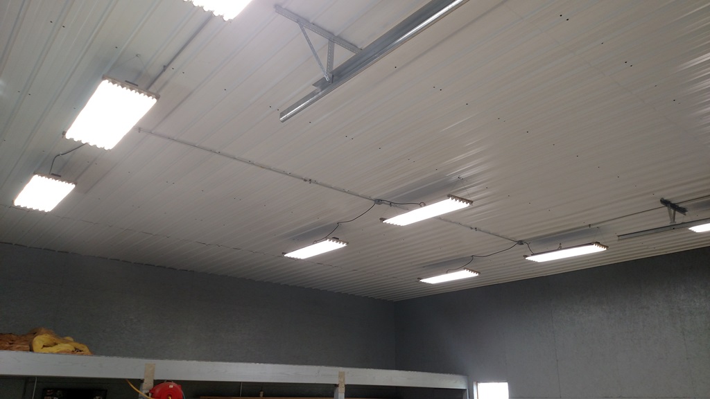

I understand what everyone is saying about LED's have all their lumens pointing down, thus better than the average el-chepo fixture.
I just find it hard to believe I would get equal light output to what I have now with half the lumens.
They have a mirror-like reflector. You can see I am not loosing may lumens to the ceiling
Here is what I have View attachment 452912
I find it hard to believe that you would even be concerned about replacing what looks like an almost new installation of T8 HO with the "flash in the pan" LED's. The run of the mill LED's are presently putting out about 100 lumens/watt
Cree has already shown 276 lumens per watt in lab demos.
Now for those of us that are replacing failing fluorescent fixtures or doing new construction the dropping price of LED's make them very viable. But the best solution may not be standard "tube" shaped fixtures. It might be better to just use LED strips or string lights.
