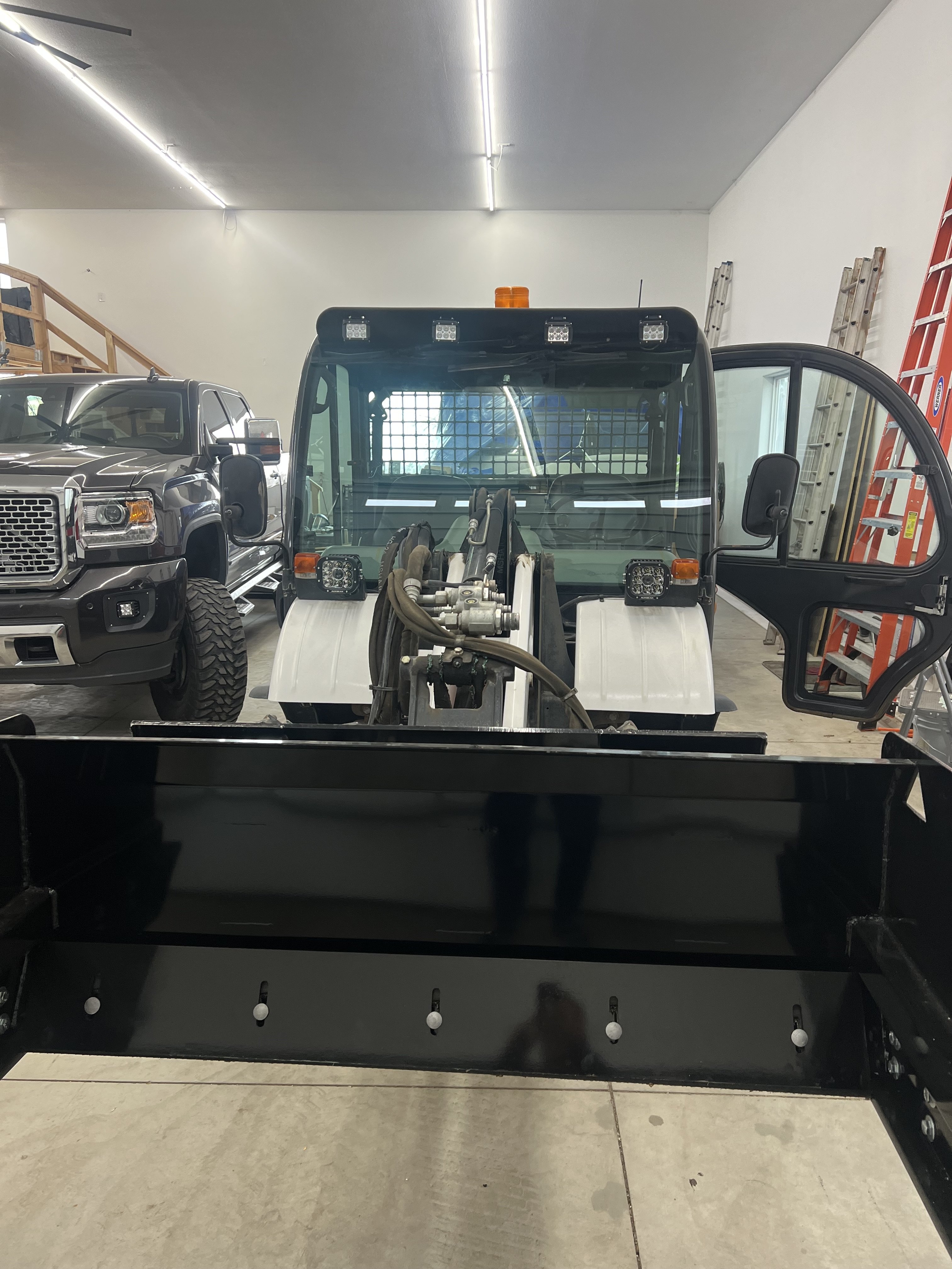

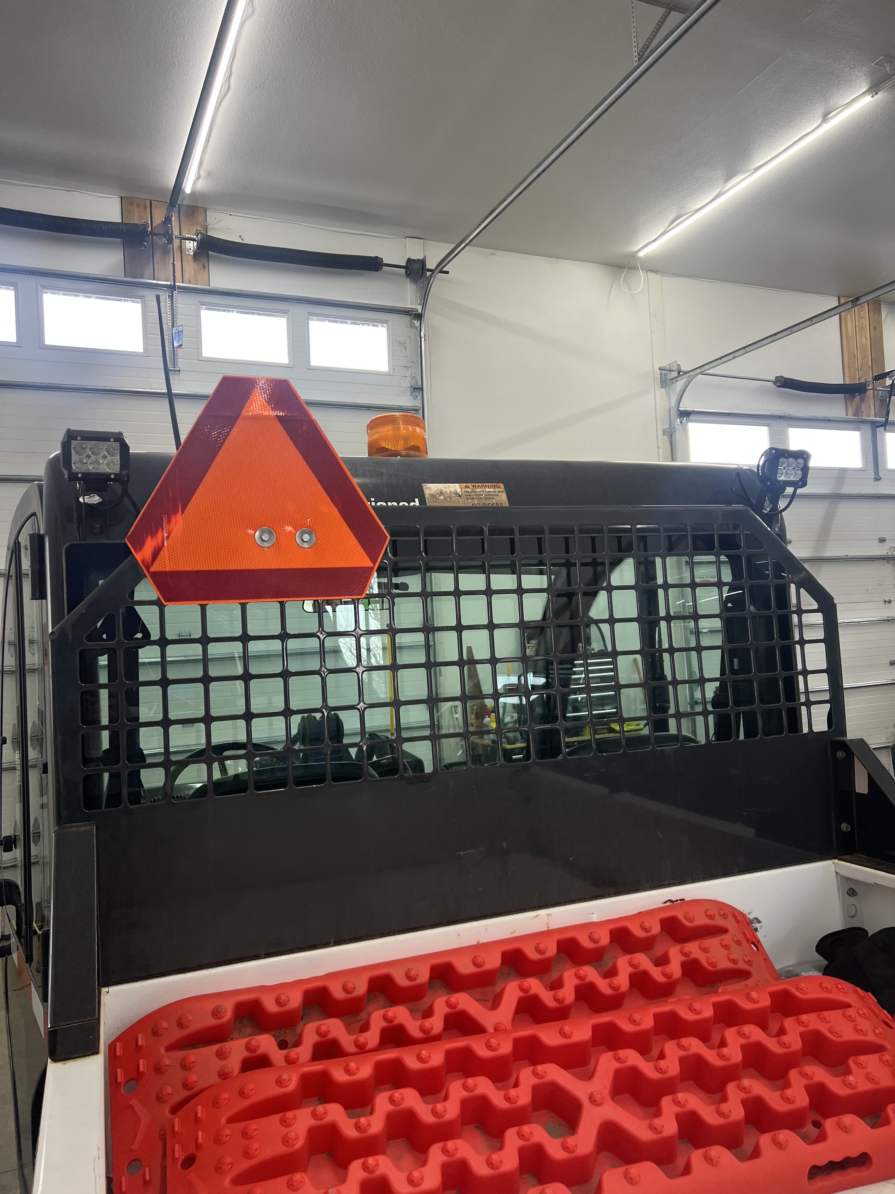

I went with these found all on Amazon very reasonable and use the same mounts.
Does anyone know how to wire the driving and floods to work together?
/ LED Replacement Work Light Bulbs. #12
the flood lights are off the rocker switch on the dash, one position is the flood the other position is the driving, you could add another switch to activate both be easy to do or just move the flood wire to the same terminal as the driving side, sadly the driving lights have high and low beam but for some reason Bobcat chose to only wire the driving, I did switch the wore inside the light on mine to work on the high beam filament
