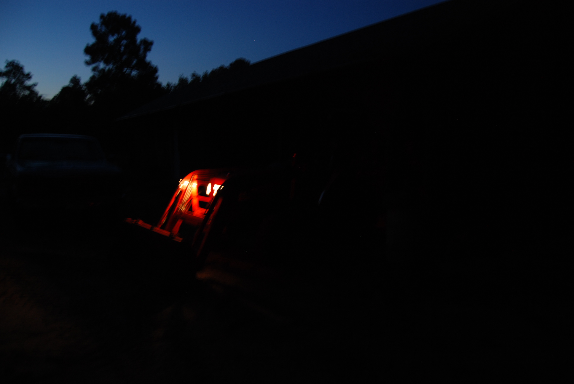

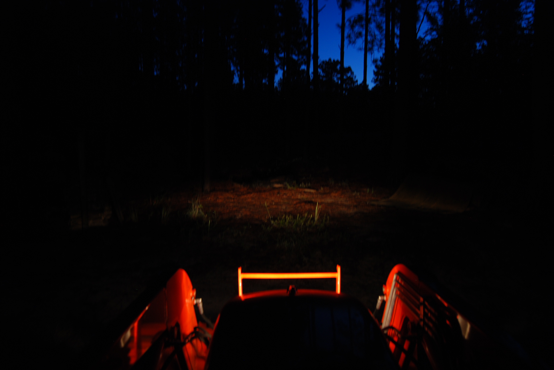

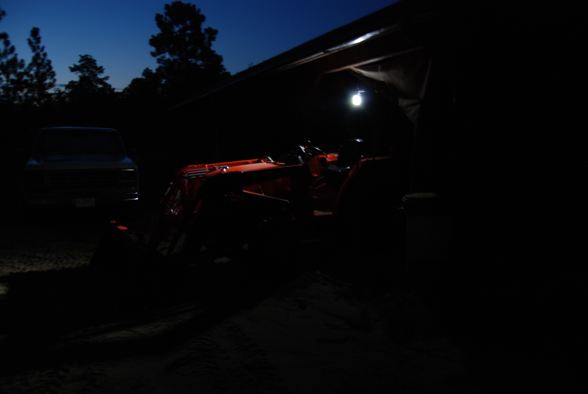

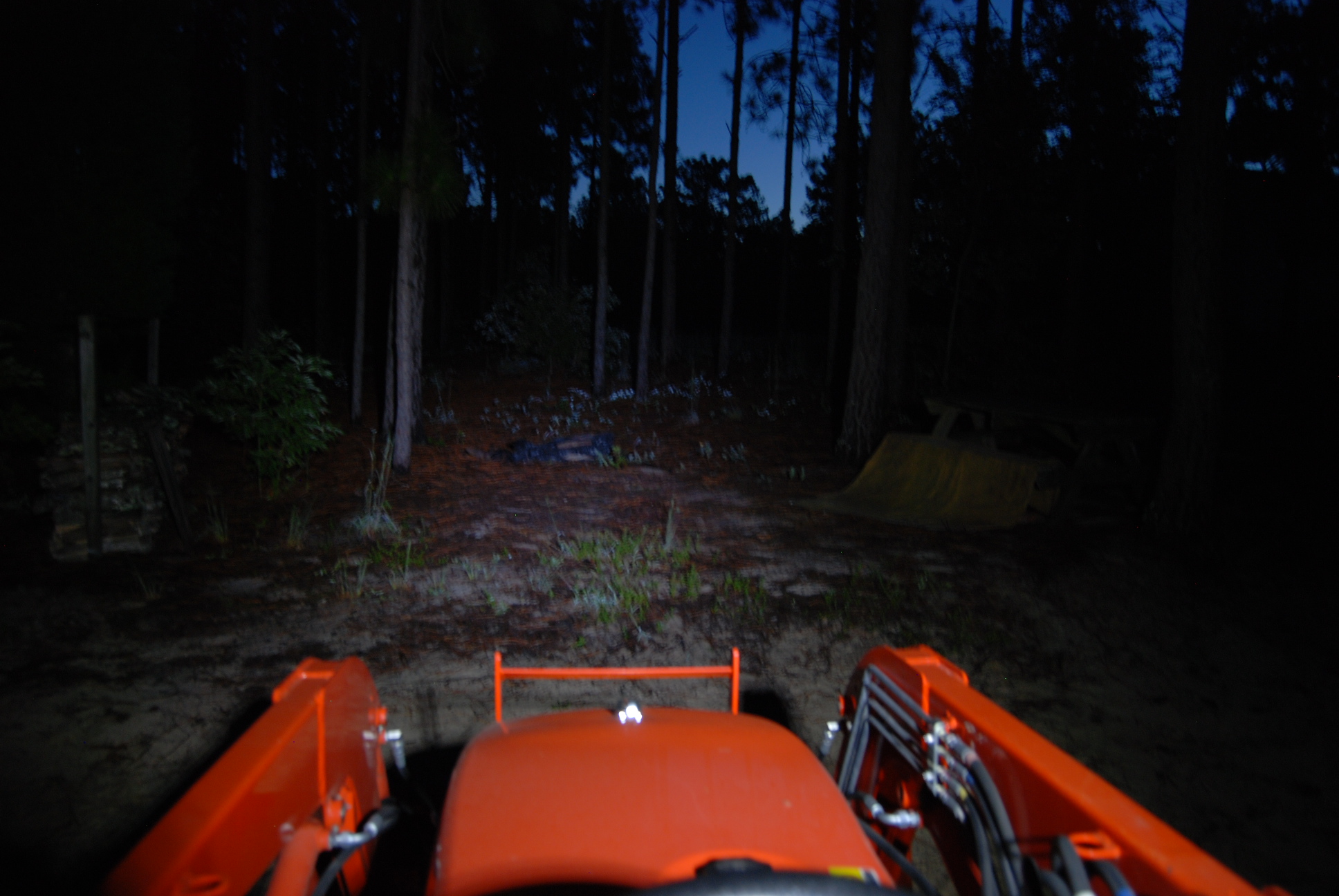

Installed 1 24W Flood. Pictures just before daylight.
Attempt to load pics. No flash.
2 with new light only, 2 with headlight only.
All the light is from the tractor, 2.5 sec exposure, the light seen in horizon was providing no light on the ground.
Big difference in the forward looking picture, headlights only vs. LED only, LED looks much better! Thanks for posting.
