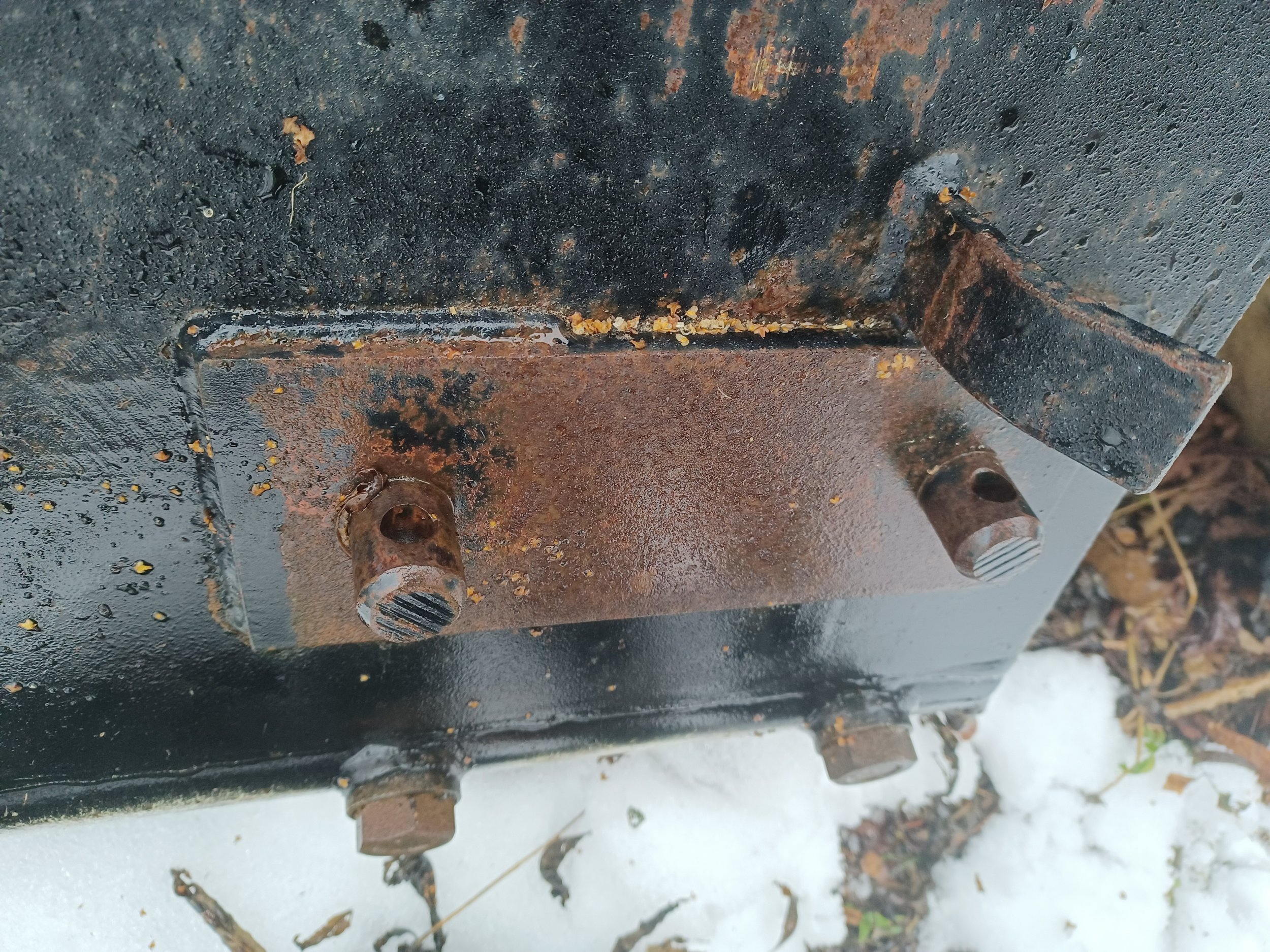

Hi.
I have a Lenar 254II with loader.
It is fitted with some bracket for quick attachment.
I cannot any reference to the type of welding bracket that as been used. The dealer went out of business in 2007, so no help there
The closest I get is some John Deere welding brackets but only with one tap not 2.
I have been trolling the internet for information, not finding anything similar.
It this something that came with the loader, or something the dealer took from another brand of compact loaders?
Any expert hints out there?
I'm trying to get a snowplough attached to my loader with the same quick attachment as my other tools.
   / Lenar 254II Jinma, Mahindra loader, quick attachment #2
That looks homemade to me. Based on the fact that the bracket hits the cross-tube and has actually damaged it. It is possible to be factory or after market but not likely without at least a small cutout to clear the cross-tube. There should be some kind of stop or the end of the cylinder travel should be reached before anything hits.
If you are comfortable welding and have the equipment, I would recommend getting a blank SSQA plate and mount and fabricating up something that will allow you to use other standard implements. I got what I needed from Titan and cut the brackets off of my loader bucket (bolt on version) and welded them onto the adapters. The welded a blank plate onto the back of the bucket. Now it is quick and easy to take the bucket off and back on. Next up is to make a snow bucket (bigger) and a plow blade using more blank plates. These will all be interchangeable with standard universal quick mounts.
I have bucket and fork with this aftermarket quick attachment. And since it have been working well, I thought "just buy another one" for the new snow plow. But hours spent on the internet should have been used on welding on standard quick setup as piper184 suggested. Well time spent.
Found this welding bracket with one pin
Next up is a mounting plate and some welding.
But cannot get the puzzle with the two pin quick implement out of my head :)
Thanks for all replies and future to come.
   / Lenar 254II Jinma, Mahindra loader, quick attachment #6
curious if the one pin and the two pin setups use the same top bracket?
where is the single pin located? If on center it could interfere with the cylinder rod so my idea of just drilling a third hole or adding two more pins would not work.
