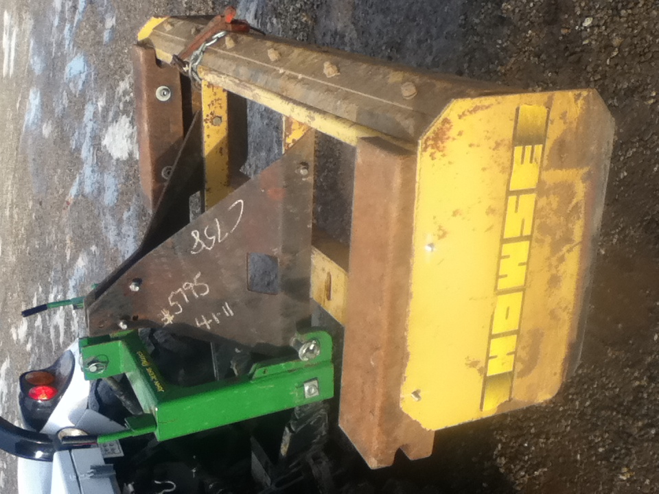

Heres a few pics of a work in progress box ish blade . The ratchet rake is adj/reversible /removable inside the "box" it is 72"wide . The draw bar was from a old dozer .I wanted a drag that kinda floated on the surface to level and rip roots out too.The pictures show it upside down.
Here is also a pic of my chain saw scabard .It is a piece of Alum. tube lined with rubber that I mounted to the loader frame/ gun mount . This worked really well for me as I can still get on & off from either side.
Ak9

Here is what I did to add weight not fancy but its 350# extra in a small area its a harmonic balancer off a big natural gas compressor engine.
Nice way of adding a substantial weight. I'm going to go look for something similar in a weight.
I currently hang about 250lbs of suitcase weights on my BB....but more ballast is needed for FEL work. Even with loaded tires and the 550# BB....I can get a rear tractor wheel off the ground at times.
Another 300+ lbs "out back" would sure help me out. It's either this, or, I'm going to have to find / make a ballast box. Your weight idea is likely a lower cost alternative and I have the BB in place for other needs.

These are all custom, 1st is my boxblade with 150lb elevator weights on each side so 300 extra pounds on that, 2nd picture is me ballast "bucket" that I made from an old bucket filled with rock and sand then capped with concrete, and 3rd picture is my new recent build is a landplane which does such a great job for leveling
