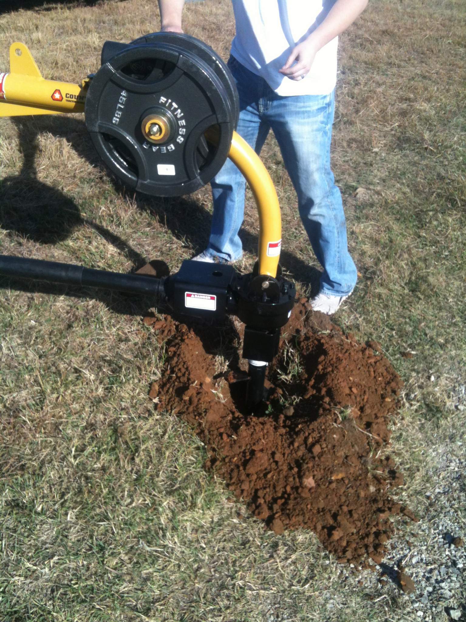

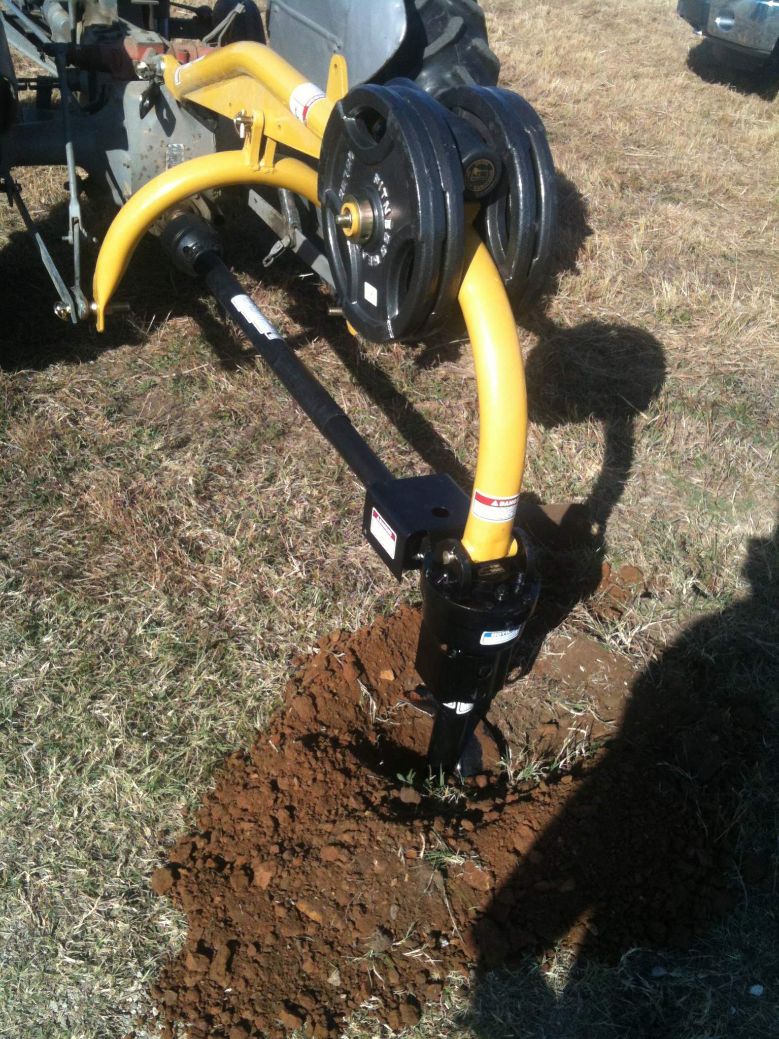

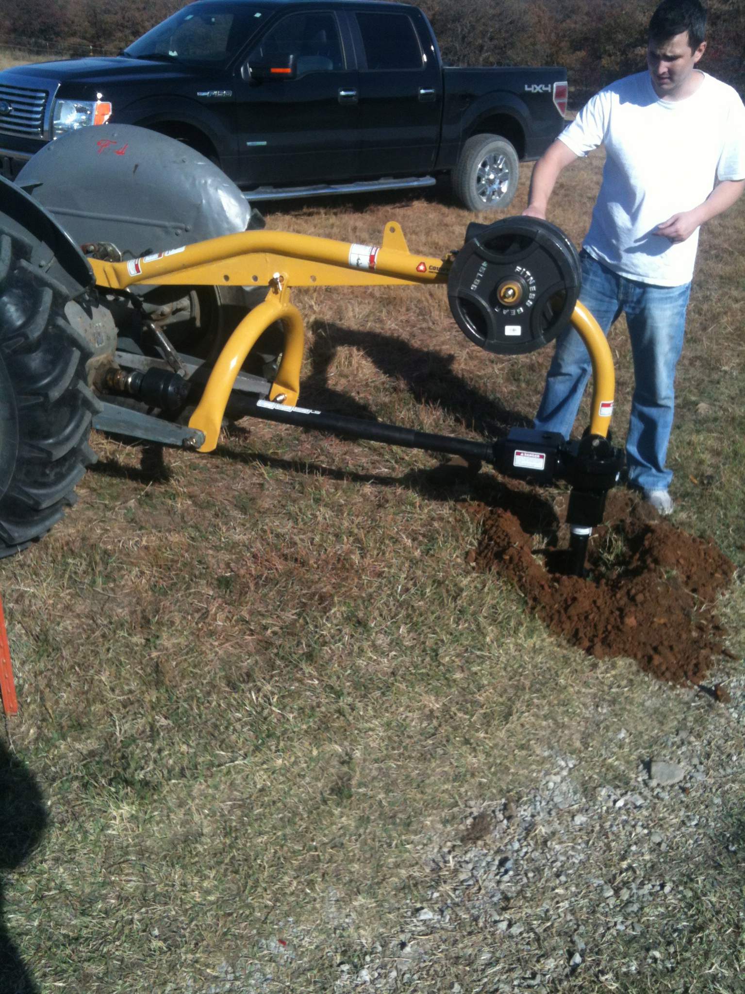

Deezler, Those weights may also come in handy with your post hole digger. Our soil is rocky and in the summer when it is very hard and dry I use 180-lbs of weights and it really helps the auger get a bite and dig.

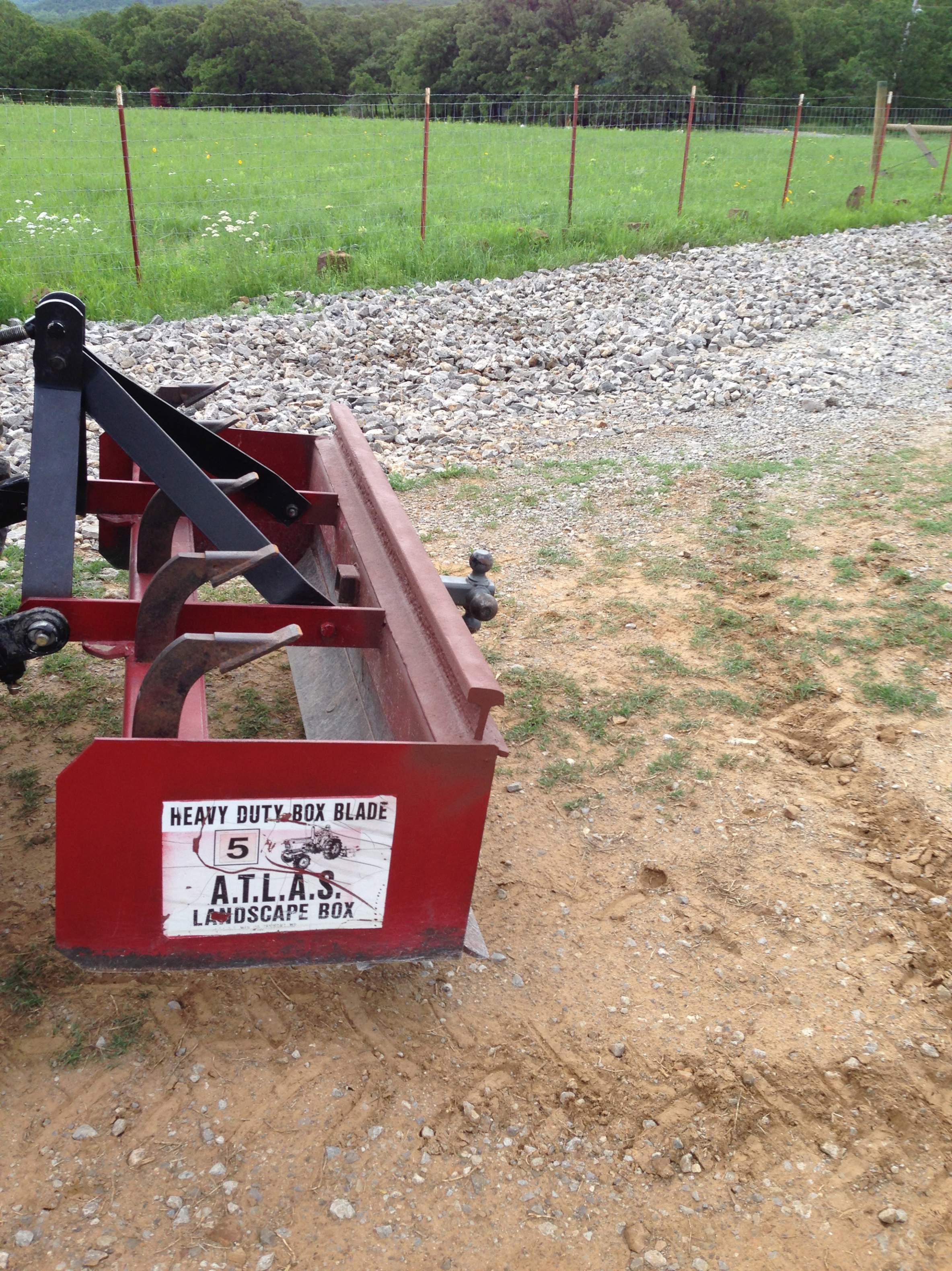

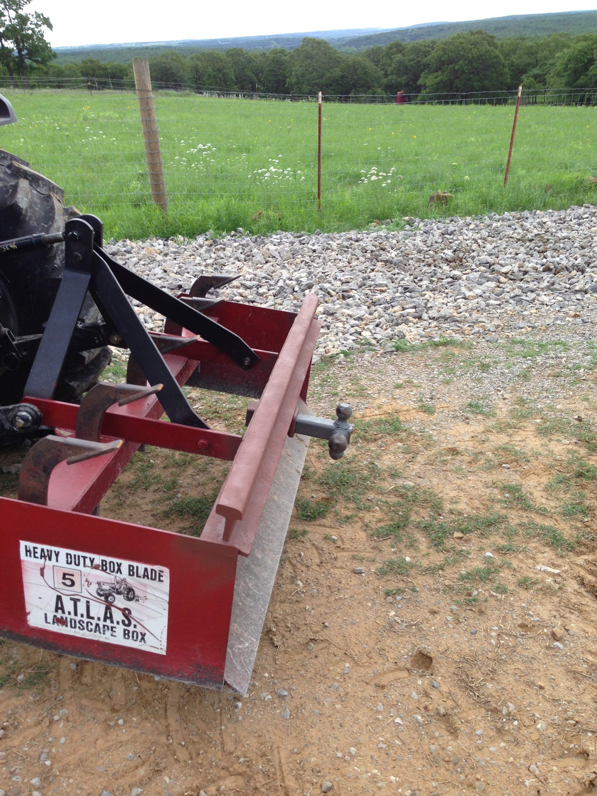

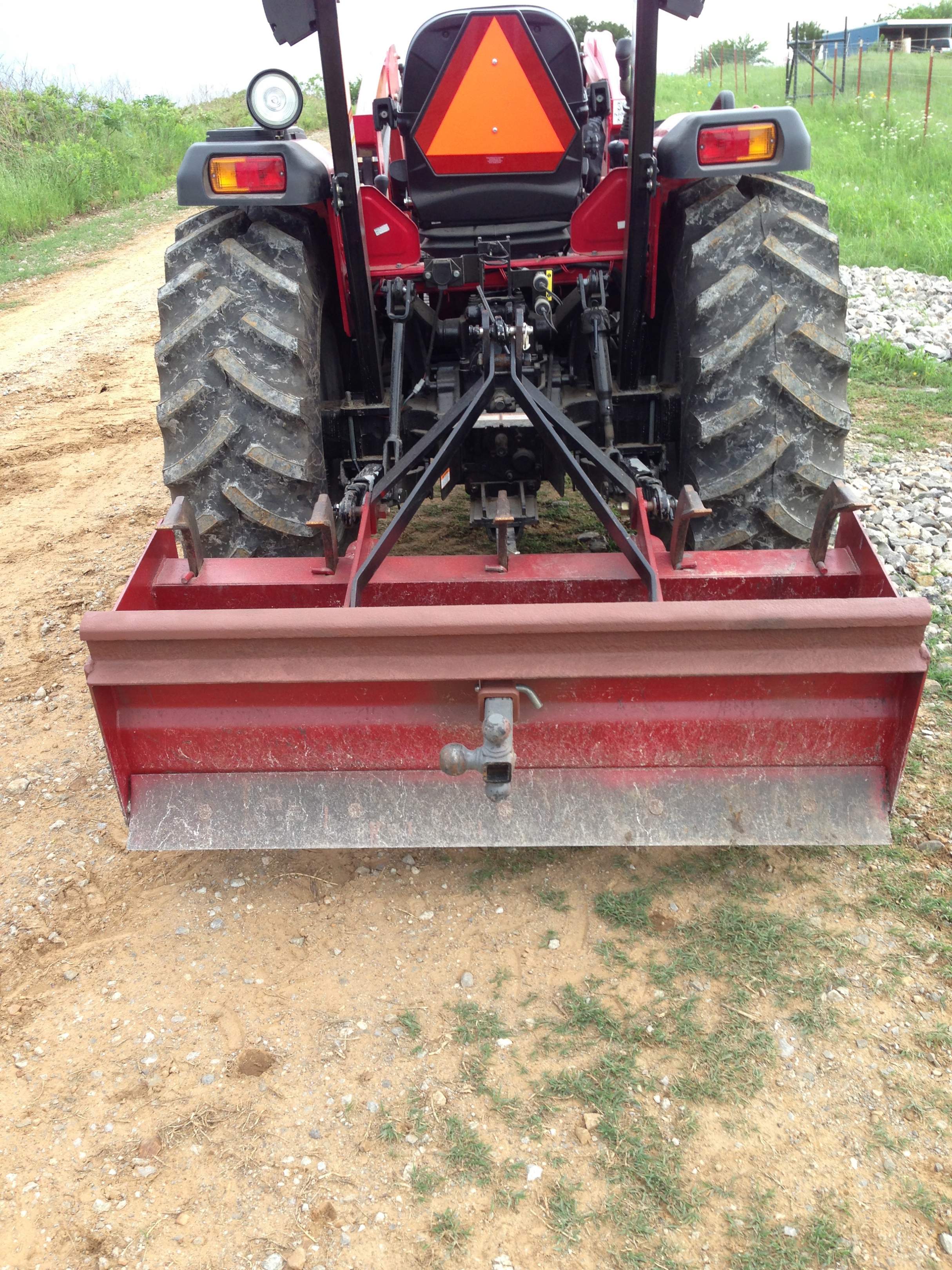

Heres mine. Added about five hundred pounds. Works much better now!
