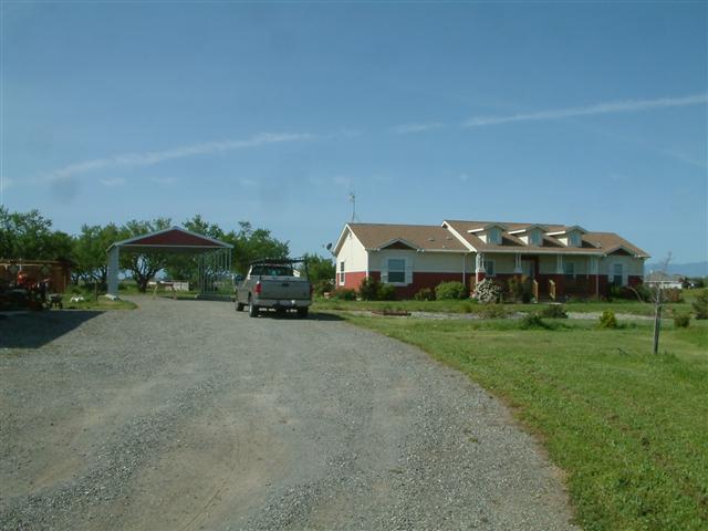

I had my 20 ft wide x 330 ft long driveway installed in 2005 with three 2" thick lifts of crusher run with watering and rolling each lift. No problems at all. Only maintenance was spraying the weeds along the edges.
Good luck
   / Let's talk driveway material. Just under 1/2 mile long. #28
Nice drive Flusher. Looks like it has great drainage!!!
