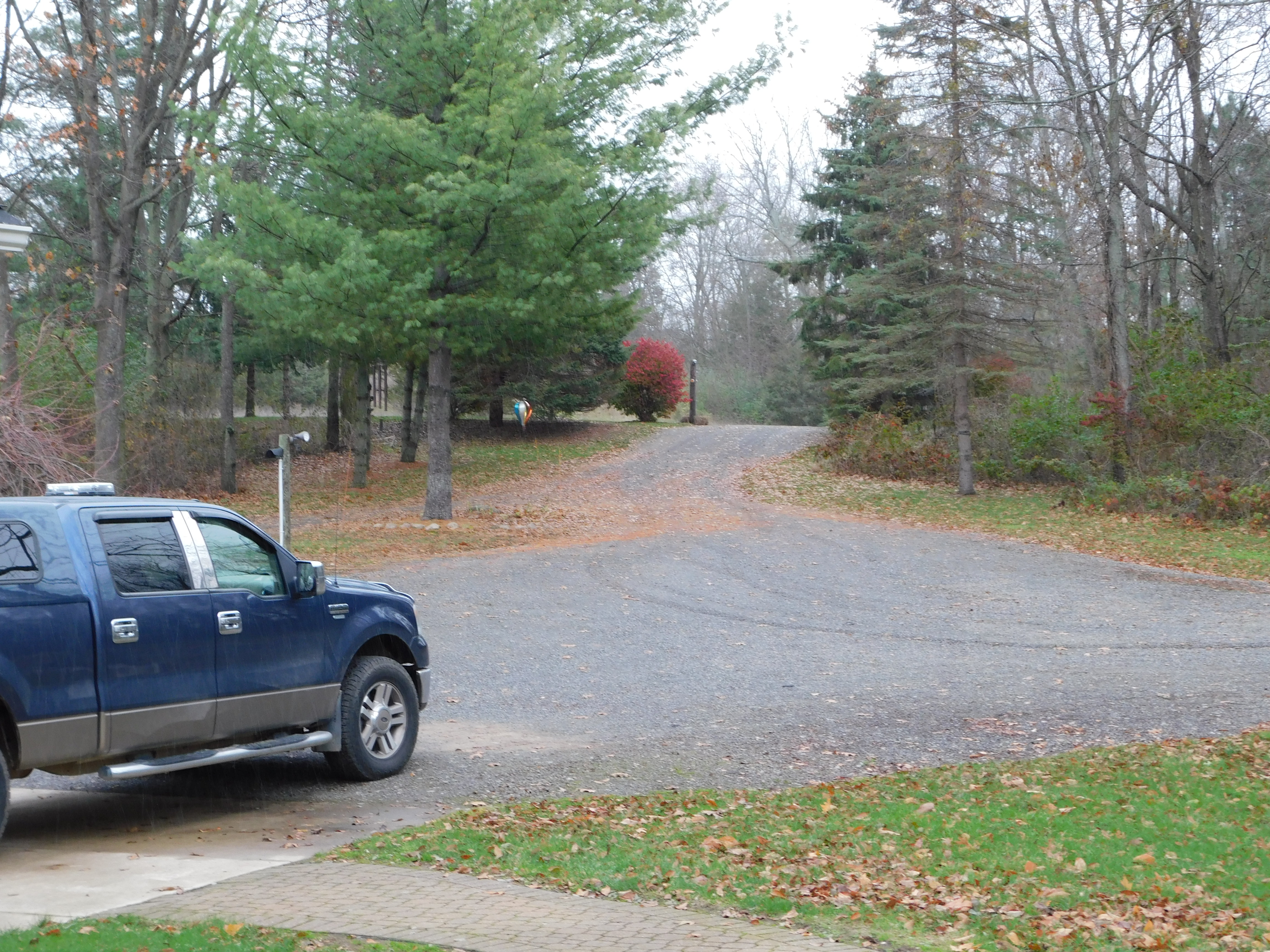

We used 8 inch of slag.Been here 28 years and its held up very well.
